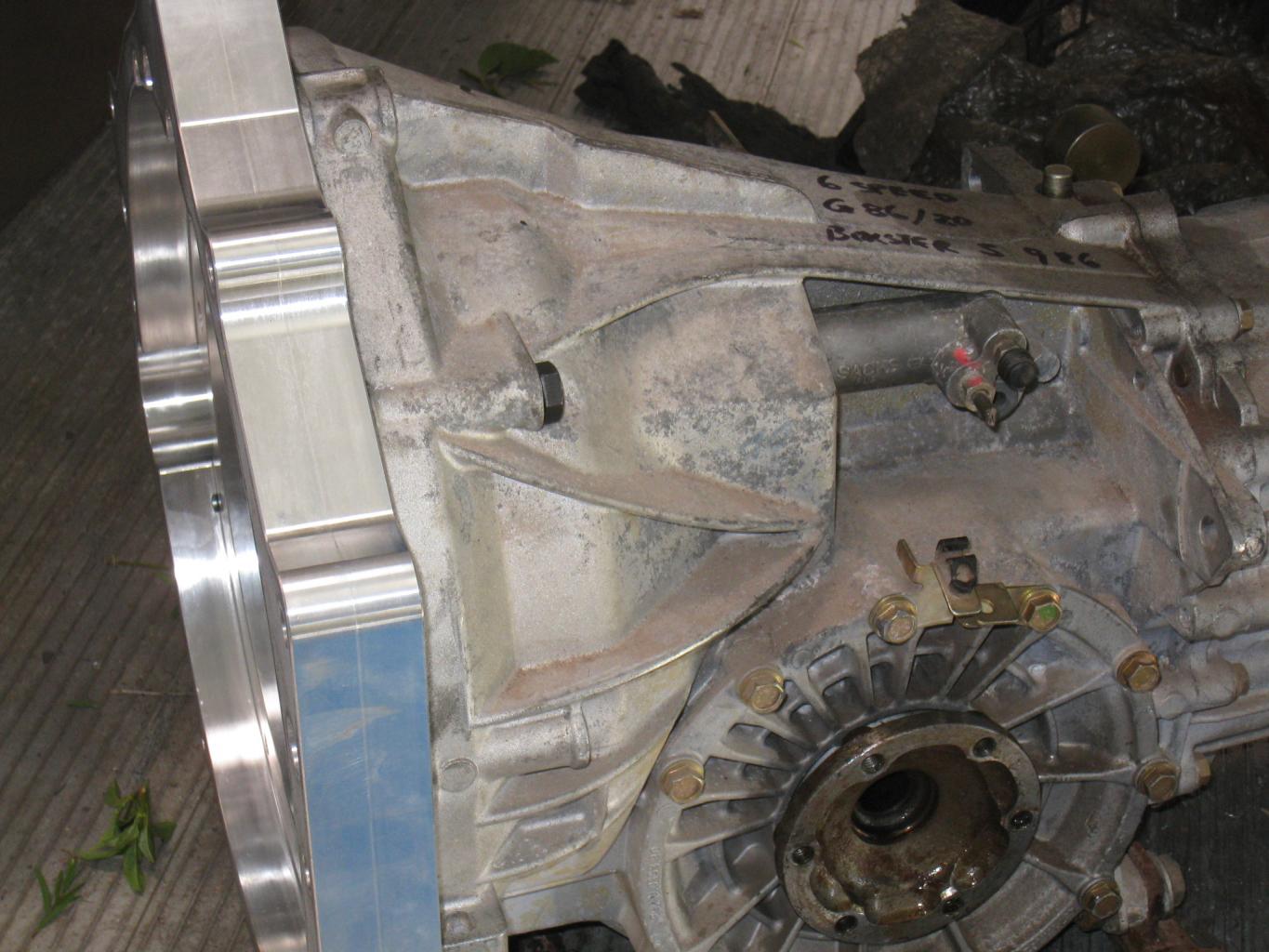

Porsche g86/20 transmission LS1 engine
flatchat(Chris)
Only me :-
How is The performance? Was it hard to make it run? Did you use OEM corvette harness or factory five? Did you reprogram computer? How about LSD? Did you find any other problems mating them tougher?
Quso, give John Spears a call at www.speartech.com
Review your requirements with him and he will taylor a harness and reflash an LS1 ECU to specs. Be aware that the ECU, pedal assembly and TCM must be compatible.
He will build you a harness or modify your existing OEM harness for a little less than the majority of aftermarket stuff. Highly recommend him, he did a superb job on mine.
