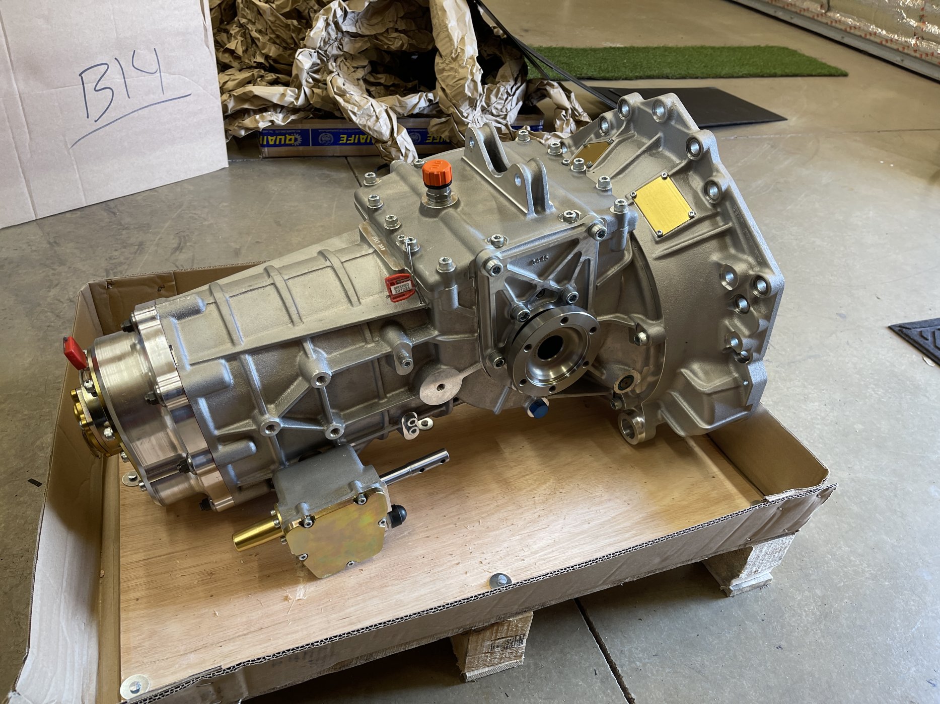

I just received mine, I went with the taller 3.50 ratio as Im using a 600hp engine and dont need to blow my tires away at every light, plus it will make more streetable with the taller ratio.
I just received mine, I went with the taller 3.50 ratio as Im using a 600hp engine and dont need to blow my tires away at every light, plus it will make more streetable with the taller ratio.View attachment 144128

Yours is looking the business.
