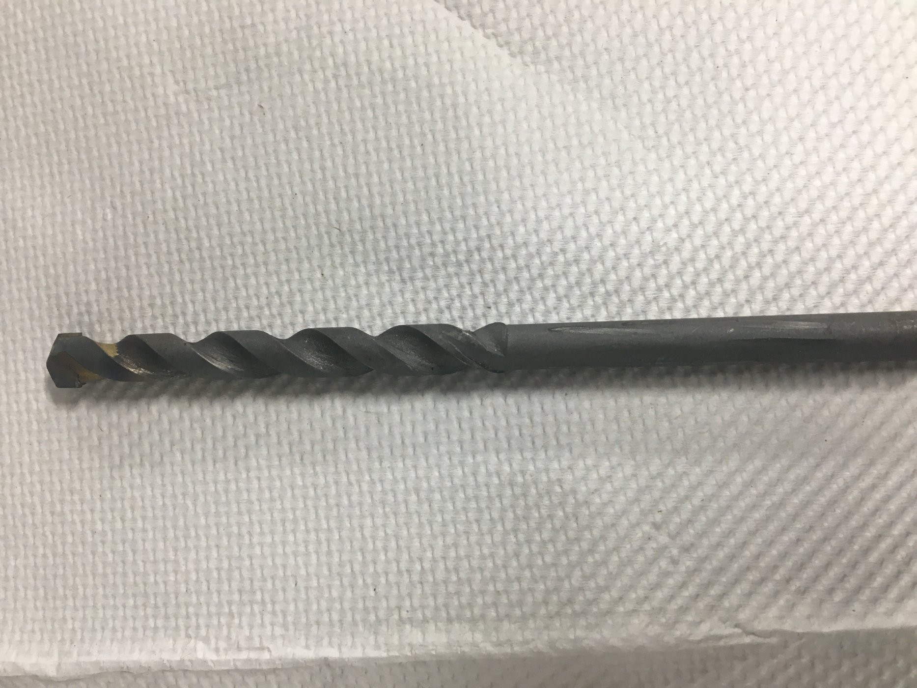

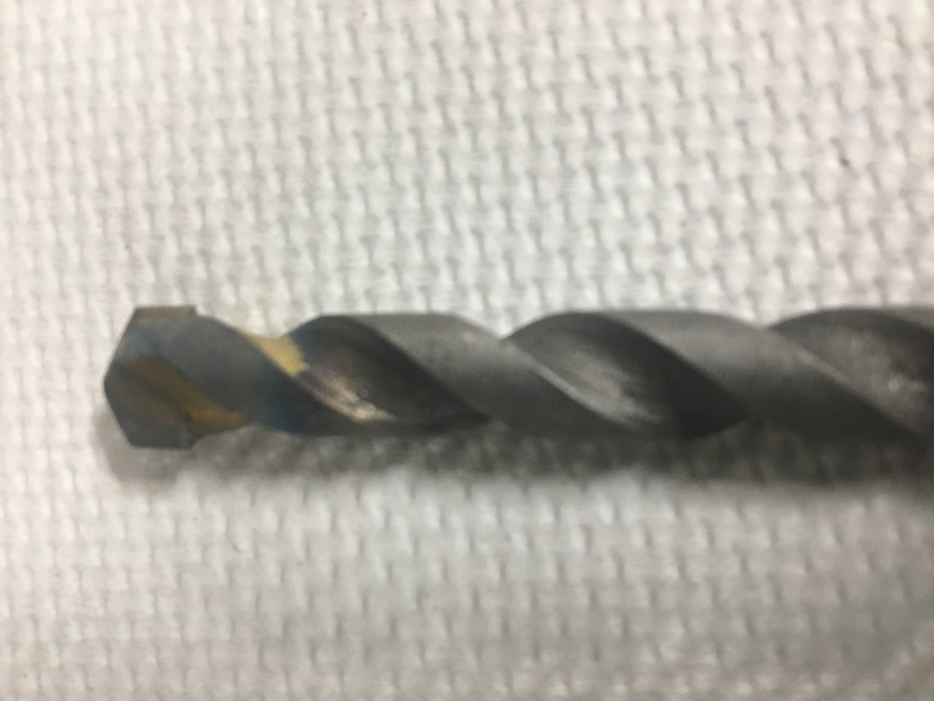

The top picture is of a carbide Masonary or brick bit. It has a piece of carbide brazed or silver soldered on to a twist drill. It is commonly used in hammer drills or hand drills.

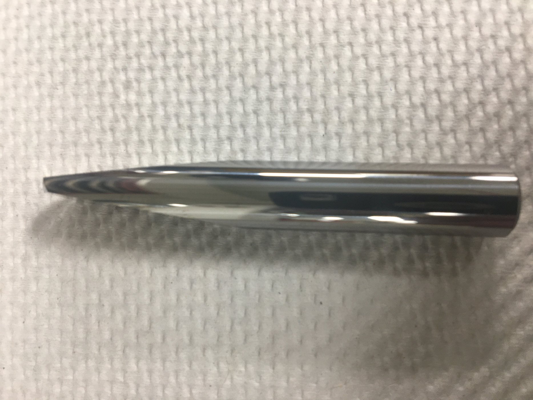

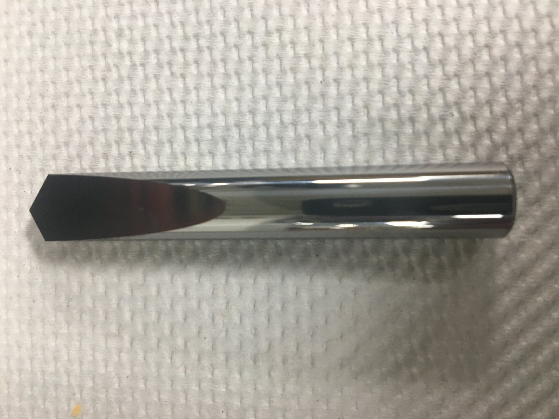

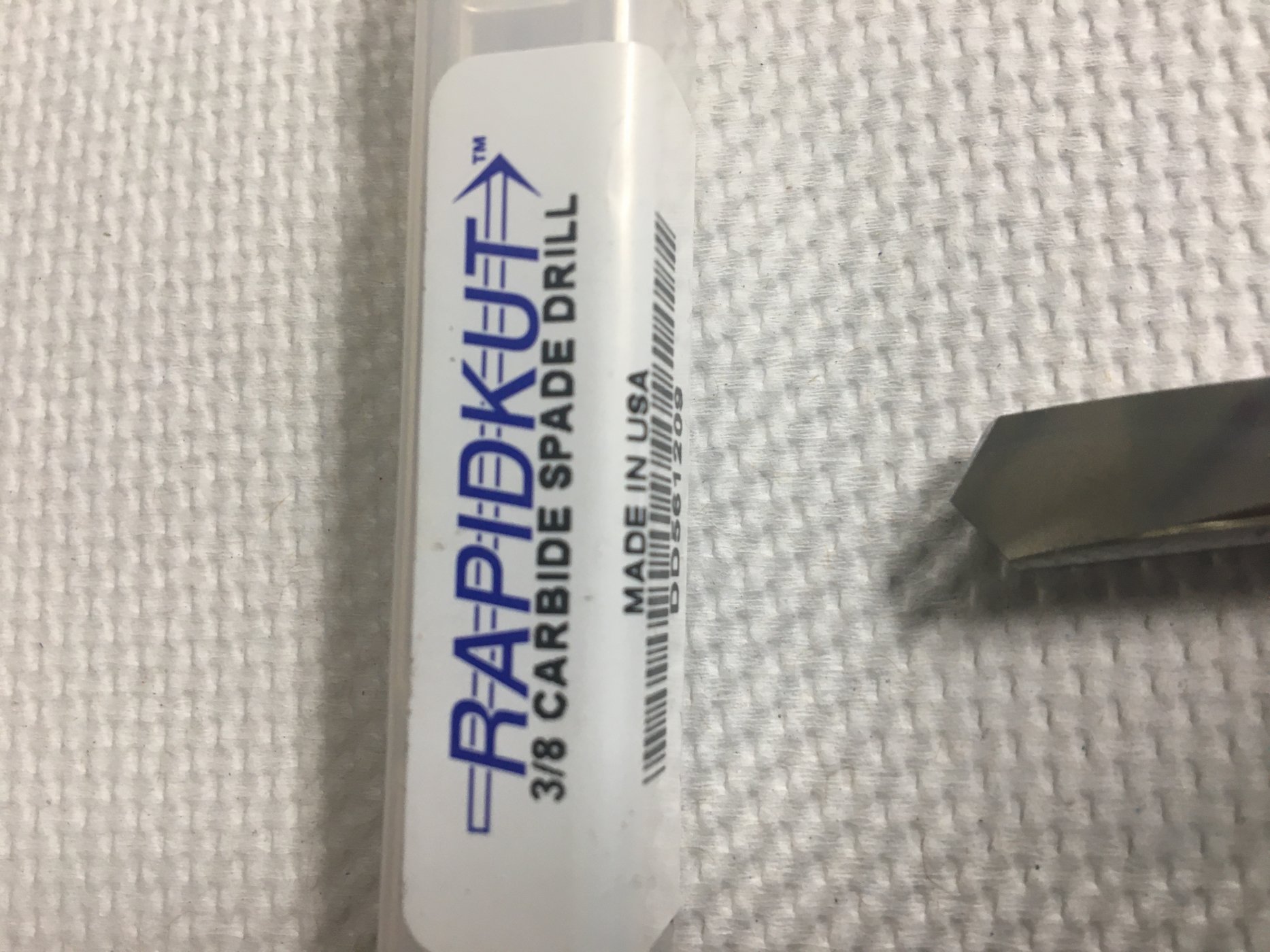

The next pictures are of a solid carbide spade drill bit. They are usually only 2-3 inches long. When used with the previously mentioned cutting oil you can drill through damn near anything. I used 3/8 bits just because you can see the difference easier. I know your pins are much smaller than that.
