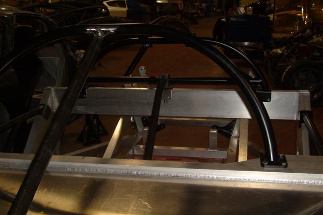

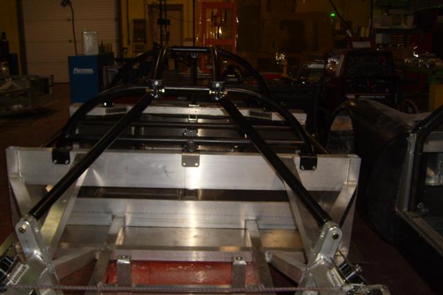

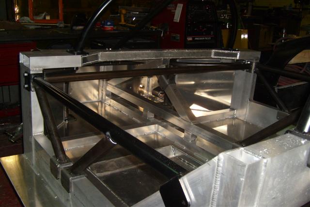

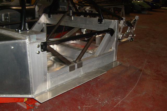

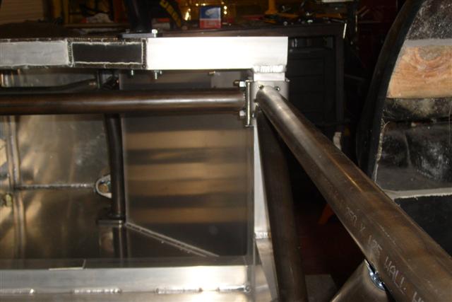

Race Cage Superlite Coupe
Last minute addition to a customers car....in process
FULL SCCA approval coming soon..:thumbsup:

Thanks Randy...glad you are feeling better.
There is more to this cage than shown ( in process as pictured but its finished now..pics later)...the GCR is pretty strict on cages as you know...but we have spent time with the current FIA regs and also the GCR.....
The cage is also designed to be fully removable so a car could be converted in both directions.track/street or street/track for future owners in the resale world..
