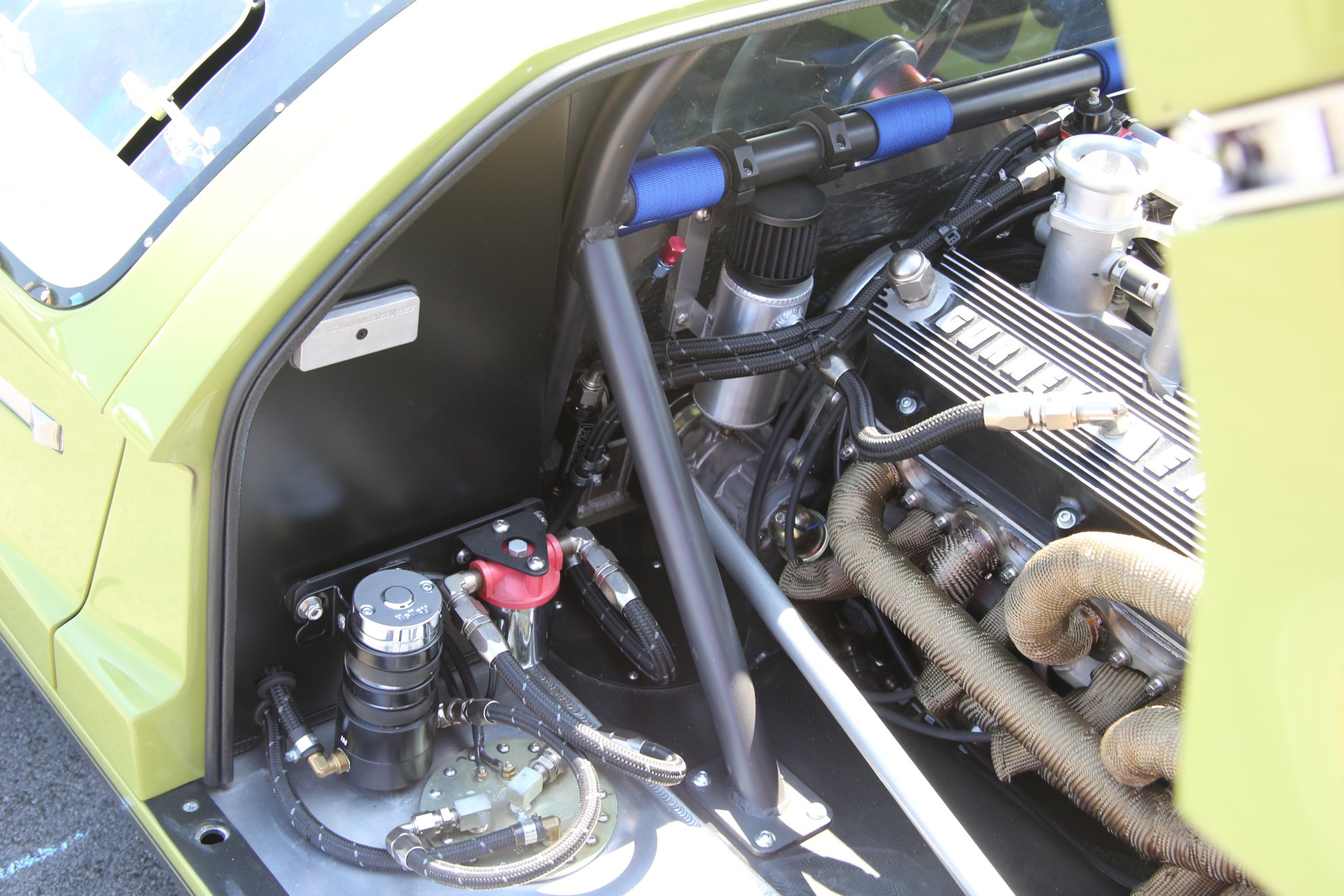

At the recent GT40 Renunion, Colton's green RCR Mk1 incorporated a second bulkhead or 'wing' to enclose & mount some of the hardware. His build dates back to before 2010 and included a rear mounted rollbar as was supplied then. They then filled outboard of it with a sheetmetal panel.
This approach has been used by many, I think Chuck and Ryan made it popular in their build. It makes for a clean engine area and room to hide parts of the build in the structure (Electronics & door strike supports).

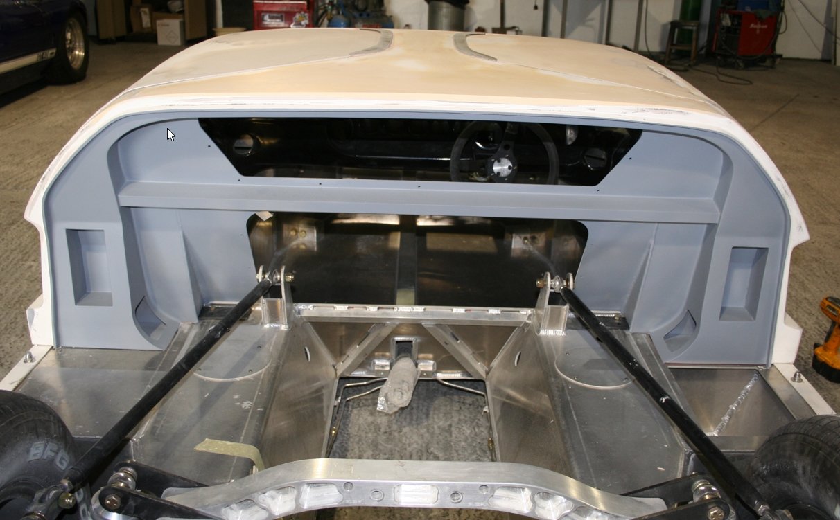

Dave Collins
On my RCR build we just fabricated extra bulkhead panels to attach to the RCR supplied standard single skin bulkhead. I am noy sure if RCR ever provided this sort of option or if it was just done as additions by individual builders. My car was delivered in 2007 and image is from later that year.
Dave

Paul Proefrock
Dave,
Very interesting approach. Was yours done in sheet metal or fiberglass?
Some of the approaches I've seen appear to be a formed wall. Curious how it was mounted and what the internal arrangements were

Randy Folsom
Dave
Dave,
Looks great. Does the crossbar interfere with the distributor?
Cheers, Randy
