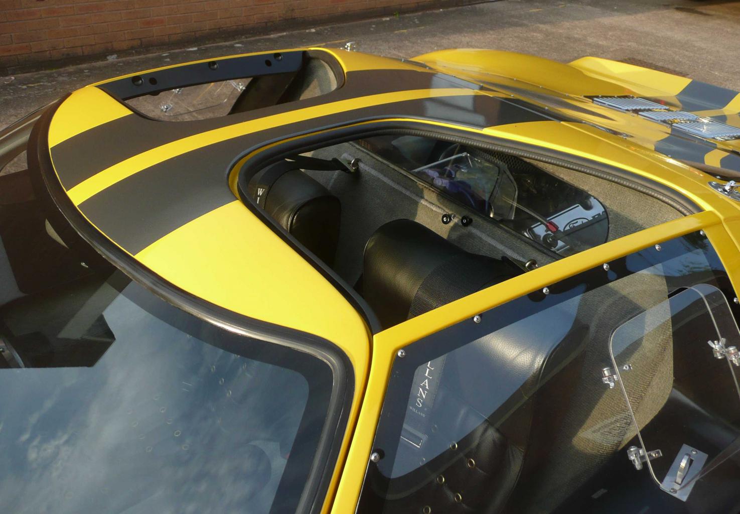

Paul Proefrock

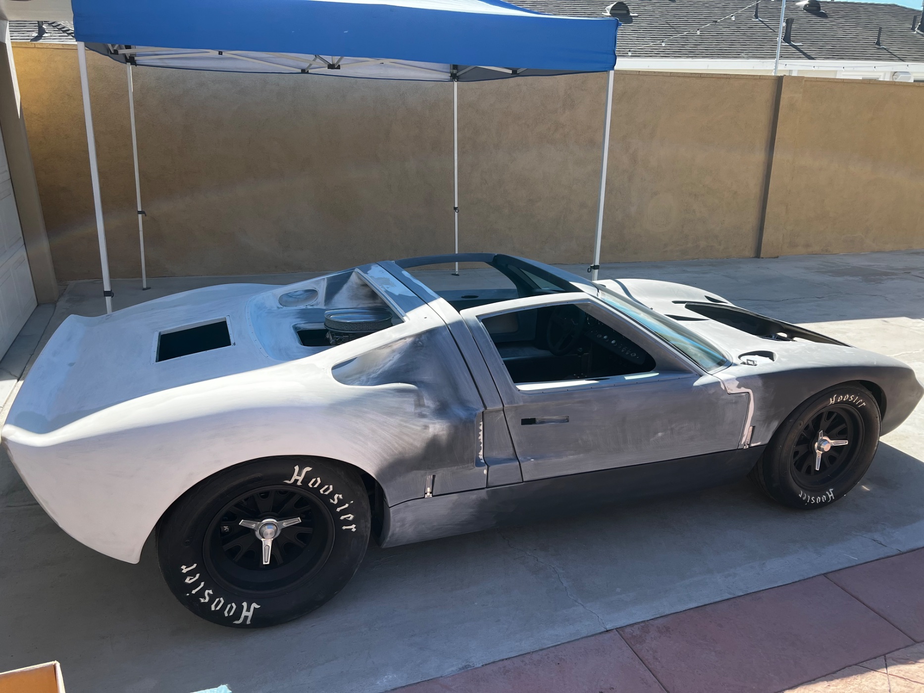

My love affair with the GT40 began with the Roadsters that were built. That wasn't going to happen so I began my RCR GT40 MkI build - yet the open top thing is still in my mind.
The RCR design won't support the windshield without the center part of the spider so any Targa style is out. You could, conceivably run a support bar fore/aft to keep support for the front windshield and have some form of a "T-Top" but that probably would be a stretch. I do see that some of the GTX1 versions of the Ford GT had this style of bar. It may have had the same issues with an un-supported windshield.
The other option is the removeable door top as was used on some of the Safir MkV and some Tornado builds. Are there any builders/owners on the forum with this style 'Open Top"? Sure would like to exchange notes with you or with those who have considered doing this. I think I've scoured this forum pretty thoroughly looking for any data on these. I've found a number of links and posts, but there's always hope there's someone out there who has the same idea and has pulled it off.
The picture is of the Tornado model and added to the post to hopefully generate interest.
Paul

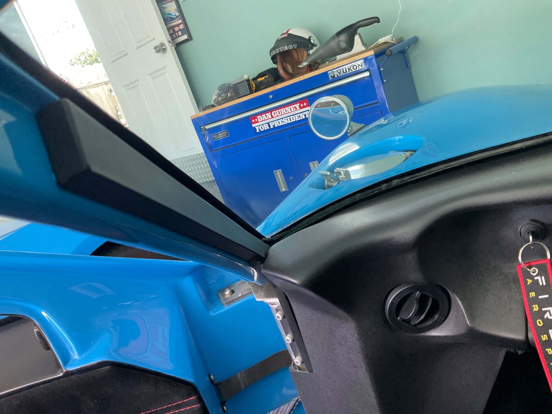

Hi Paul
Yes I built my RCR to a Roadster version I wanted to maintain as much as possible of the original design I had to modify the A pillars, Doors, spider and I built a brace to support the windshield
I had Gt40’s before but the Roadster makes it way more fun to drive I still maintained the AC for hot days
Maui

Hi Paul
Maui
What was involved with modifying the A-pillars and windshield surround to support the windshield?
Paul Proefrock
Hi Paul
Maui
Maui,
You mention you built a brace to support the windshield. Can you expand on this? Details or any pictures?
Paul

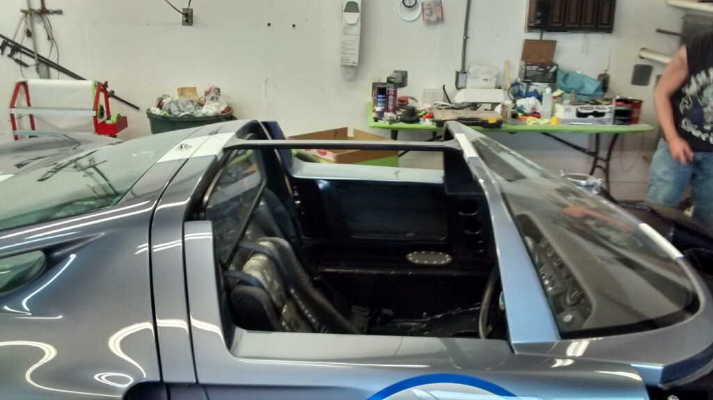

Paul Proefrock
Refer to this SAFIR car as it is one of the earliest to do this. You can see the reinforcement of the A pillar and top surround.
The Safirs have a big advantage over the RCR builds in this modification. The center tub/spider is made of steel, making the joint between the cowl and the A-pillar substantial / maybe considered one piece. The RCR build joins fiberglass to aluminum at this critical point, making it substantially less strong.
I've reinforced this joint considerably but am still concerned about removing the center support the spider provides.

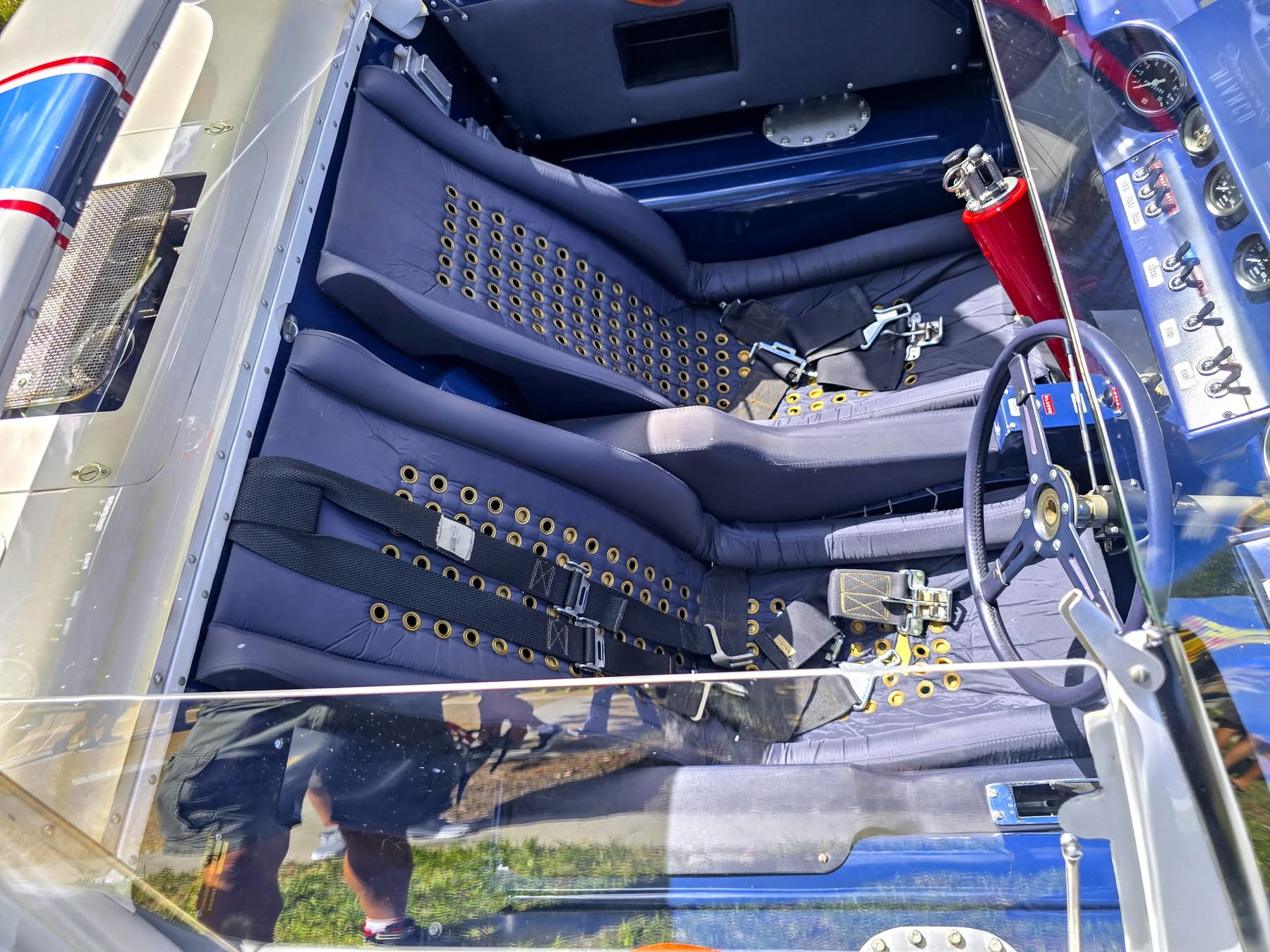

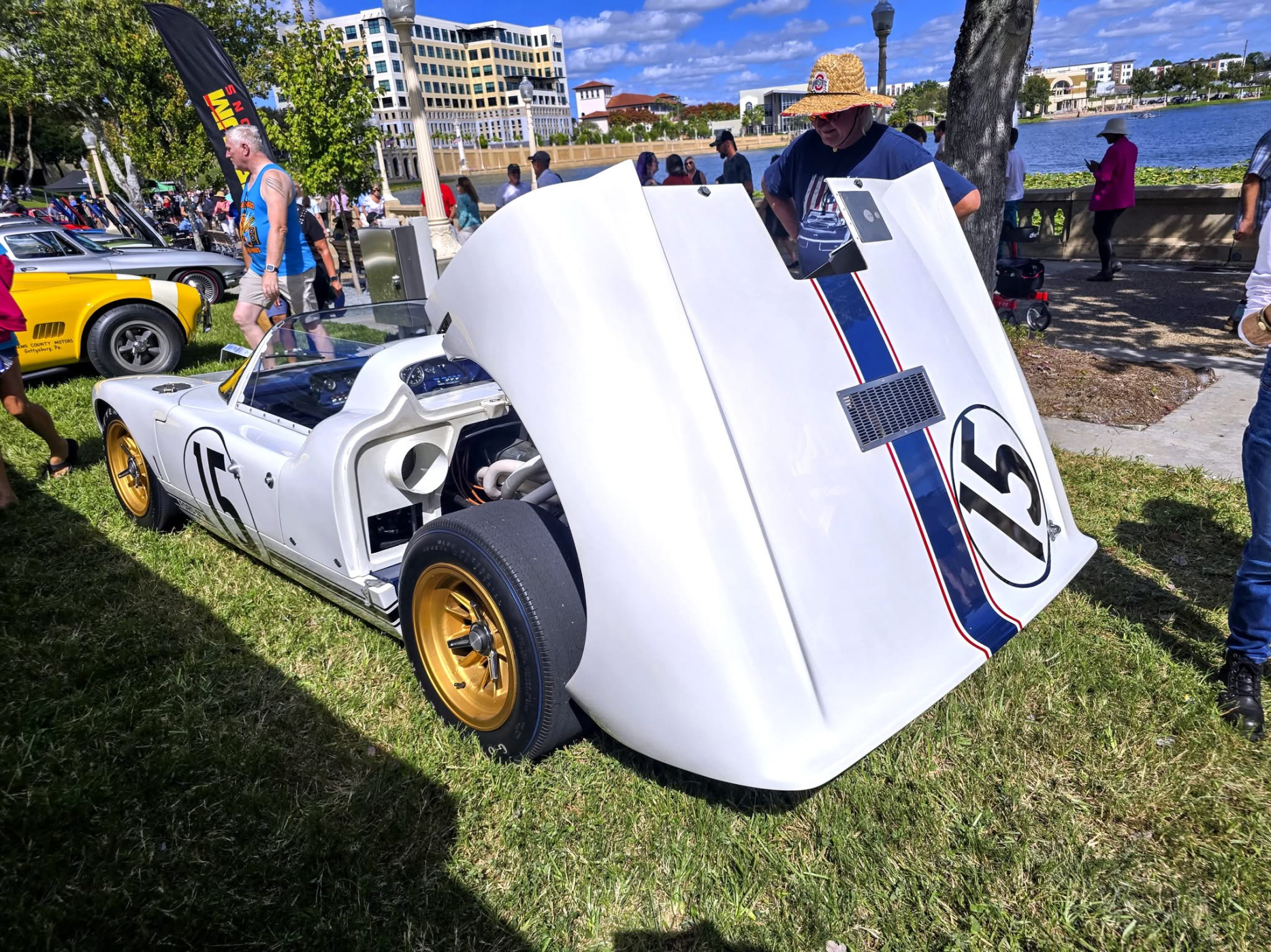

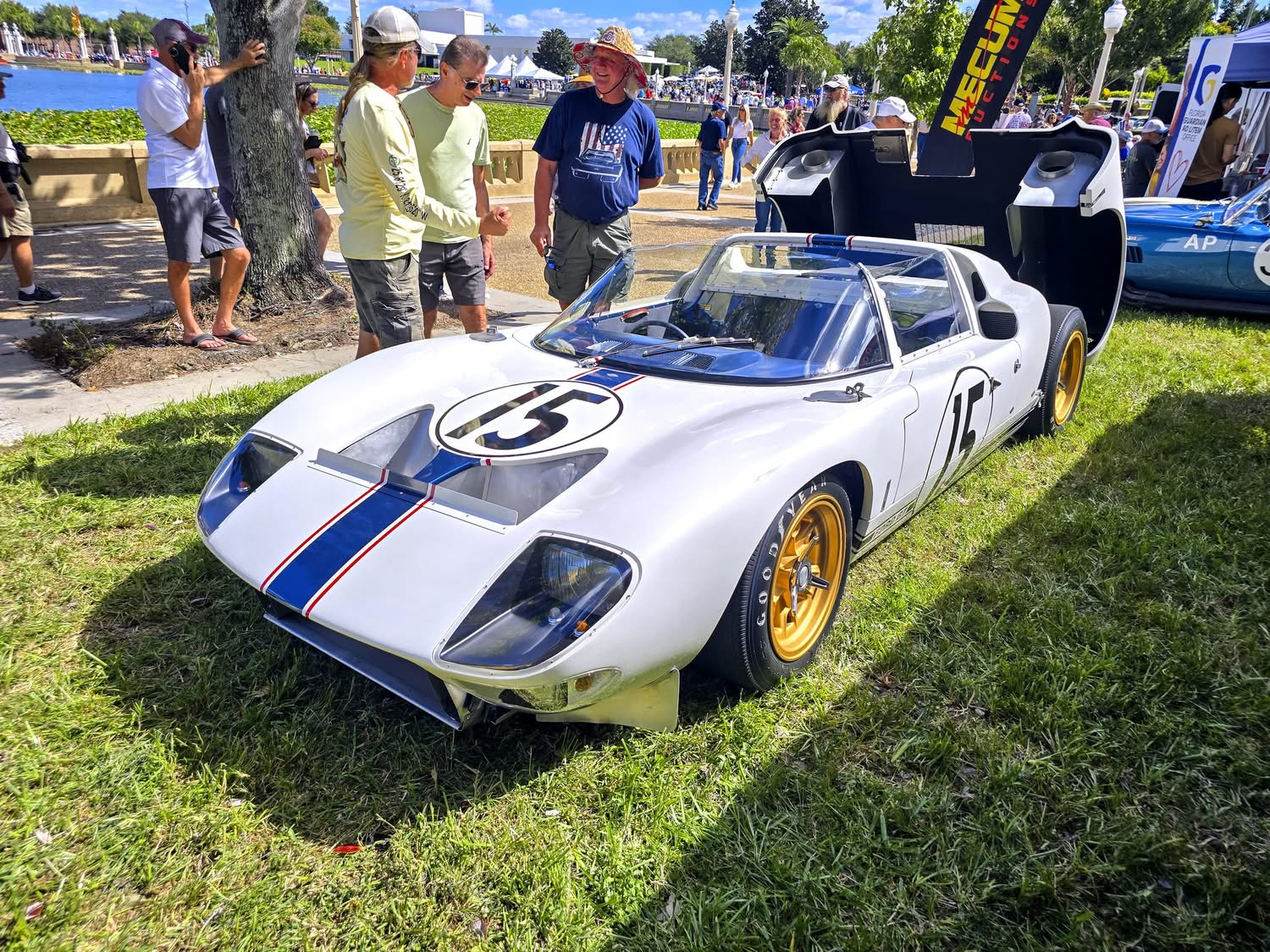

Randy Folsom
Saw this on FB today.
1-of-2 1965 Ford GT/109 Roadster - Said to be the Rarest Ford GT's on the Planet

Paul Proefrock
You could do what SPF did for Fran Kress
Lee, if you look closely, you'll note that this mod uses a different windshield and A-pillar than the hardtop version. If you think the GT40 windshield is hard to find, try locating this one :eek:. I have the complete article and photos from when this was done. Again, it is a steel body with a distinct hard joint for the A-Pillar - dramatically stronger than a fiberglass/aluminum joint
It's interesting that they added the center structure. I wonder if they were having issues with rigidity
Paul

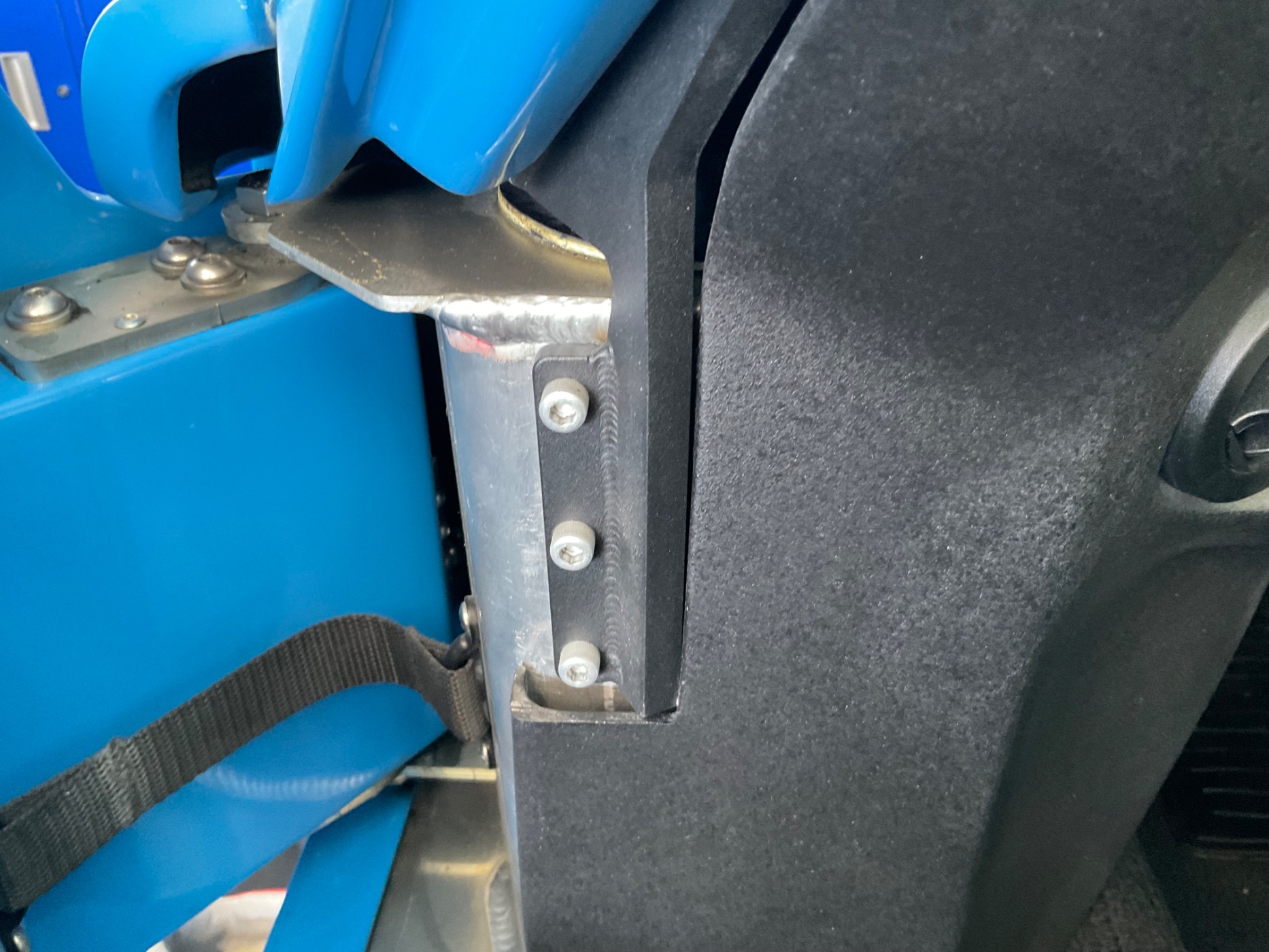

Paul Proefrock
That’s how I did the windshield/spider brace
Maui
Maui,
It appears your reinforcement is a 1/2" thick bar added to the inside of the A-Pillar with a lower leg that bolts to the cowl support of the body/chassis. Am I interpreting this correctly?
If you don't mind, a few more questions
1) Is there a reason you chose to have the bar on the outside of the A-Pillar rather than try to bury it inside the pillar itself?
2) Have you noticed any deformation of the aluminum cowl support where the pillar support bolts to it?
3) Your opinion on the rigidity of the upper corner of the windshield. Is it 'rock solid' or do you notice slight deflection?
4) Is the support glued or 'hard fastened' to the A-Pillar or does the pillar only rest on it?
Any additional pictures you care to share? It really is an impressive build
