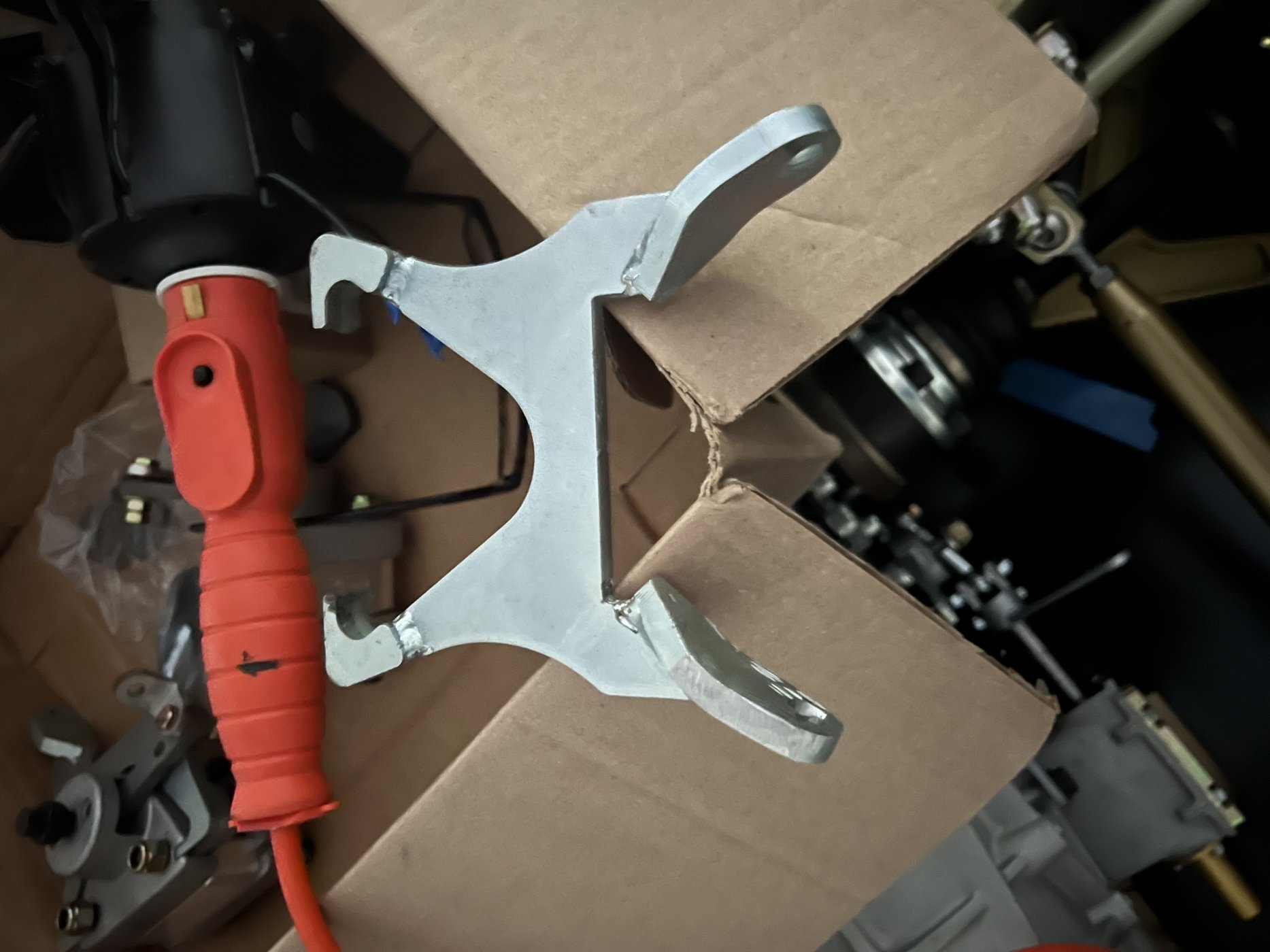

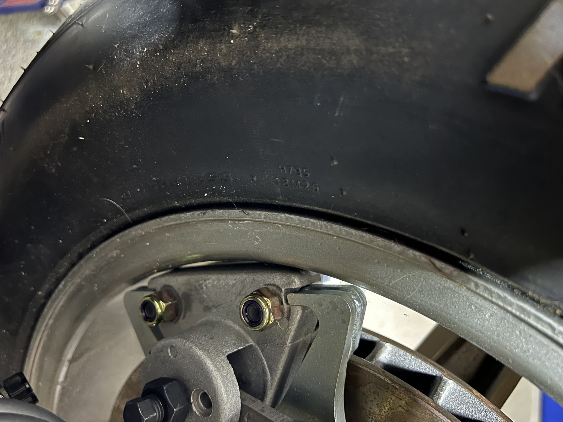

Does anyone know if the e brake bracket from RCR comes in different lengths? Mine rubs the inside of the rim

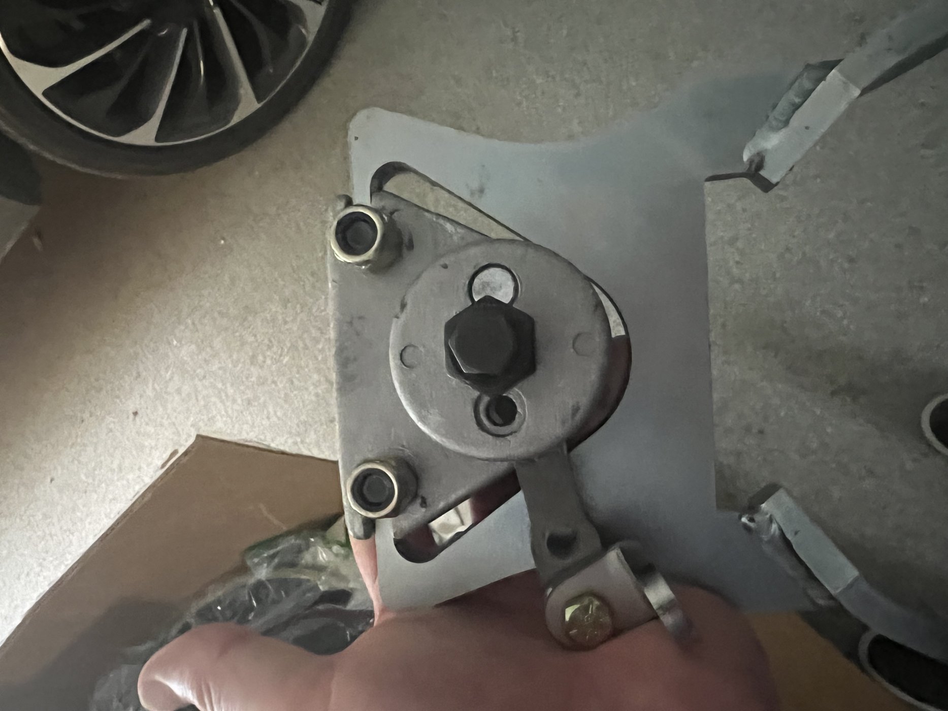

I don’t believe so. Mine rubbed also, so I removed some material from the outboard part of the calipers to gain clearance. I have the Wilwood spot calipers, which are different than yours, so removing material doesn’t appear to be an option for you.
Someone else posted some time ago that they sent the brackets back to RCR (if I remember correctly) and had them modified by cutting and re-welding them to move the calipers inboard about 1/4”. You may want to check with them to see if they can do that for you if that’s something outside of your expertise. A local (to you) machine shop may also be able to do that for you.

I wonder if RCR shipped me the 15” caliper brackets. I installed what ever they sent, but have not tried to mount the tires. Something to worry about while on the road for the next three or four weeks :-(
Yup, they are not the correct size for the 15". I built a fixture, cut, and rewelded mine. I don't think RCR had another option when I did it.
