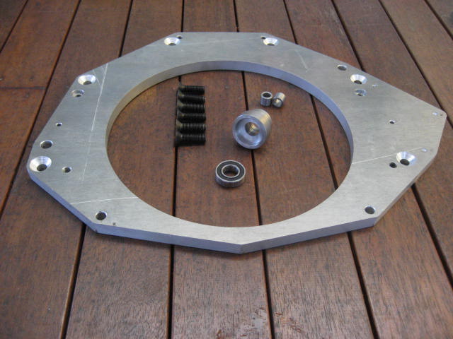

Good choice Al, on the Mk-IV, though there is "acres" of room and enough room for a "picnic" in the back of the Mk-IV, Fran told me a while back that the ricardo will not fit, with the FE. Had to do with engine dimensions or something like that, my eyes and head glazed over when he said no and the reasons why... unless Fran and you have been scheming onto how to get the FE and ricardo to fit?? Inquiring minds want to know too. Hello Fran??
Fran had my headers built while the engine was at his shop. Sorry, but mine are edelbrock heads. I did not see a header bill. Only Frans...Ask him about the headers and transaxle.
No Proctologists were used in my choices...yet...
Just talked to Fran, he said an adapter would have to be fabricated for the Ricardo to 427FE but it would fit. The headers in stainless would be about $3,000, steel $2,200. For $800 I'd go with stainless. No need to see the Dr. as yet!
flatchat(Chris)
We have the technology -- Tx Earl. --- Err, "copy right here", Fran:laugh:
