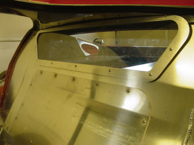

Dean-
In this picture, the bulkhead window is attached on teh back of the bulkhead. Fran says it should be on this (cockpit) side.
This isn't the best picture of what I'm describing, but if you look closely at the rear bulkhead, you'll see the window and frame attached. The roll bar then pushes against the bulkhead, forcing it forward and moving the spider forward out of alignment.
That explains my fitment issue.
