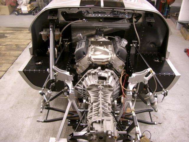

Hi there, can anyone give me some sizes for the rear window.
I am getting a roll cage fitted as we speak and the rear brace bars will only fit through, on the sides of the window aperture. I have a KVA and I would appreciate some pictures and fitting methods if poss.
Hi Murray,
My bulkhead window is approximately 860mm wide by 170mm high at the widest points, inc the rubber. I've attatched the best picture I could find, showing where my roll cage exits either side of the window. Hope this helps, let me know if I can help with any more pics etc,,,,

Hello Julian, thanks for the measurements, that will help.
Andy, good call mate, I need to template the fuel filler holes too, shall give you a call when I have some time to get in.
Thanks to you both.
