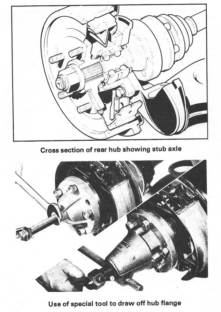

I have attached some info on the Granada Mk2 rear bearing assembly which may help.
