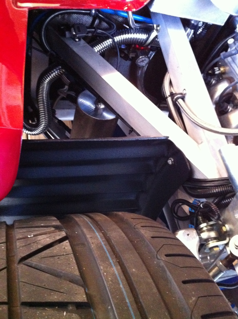

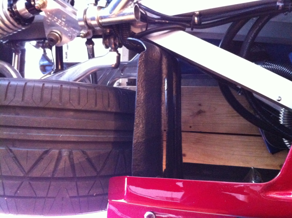

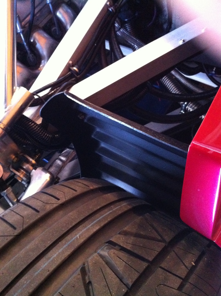

I have searched several build logs, but I am not sure of the position/direction of the corrugated pieces that go in front of the rear wheels. A few questions I was hoping someone could help me with (pictures would be appreciated if possible)...
1. One side has a widen 90 degree flange. Does that wider flange mount against the body or go to the inside?
2. There are corners cut out on on end. Does that mount to the top or bottom?
3. Is the corrugated area opened or vented for heat escape or for pressure. Has anyone ever left it solid? BTW- I have side exhaust.
Here's a couple pictures. I trimmed mine back near the lower control arm bracket for clearance,, slotted the horizontal ridges, used rubber washer against panel to frame and used modified small "L" brackets to existing nuts/bolts on body work. These are older pictures - if you need more just say so -- Mike
