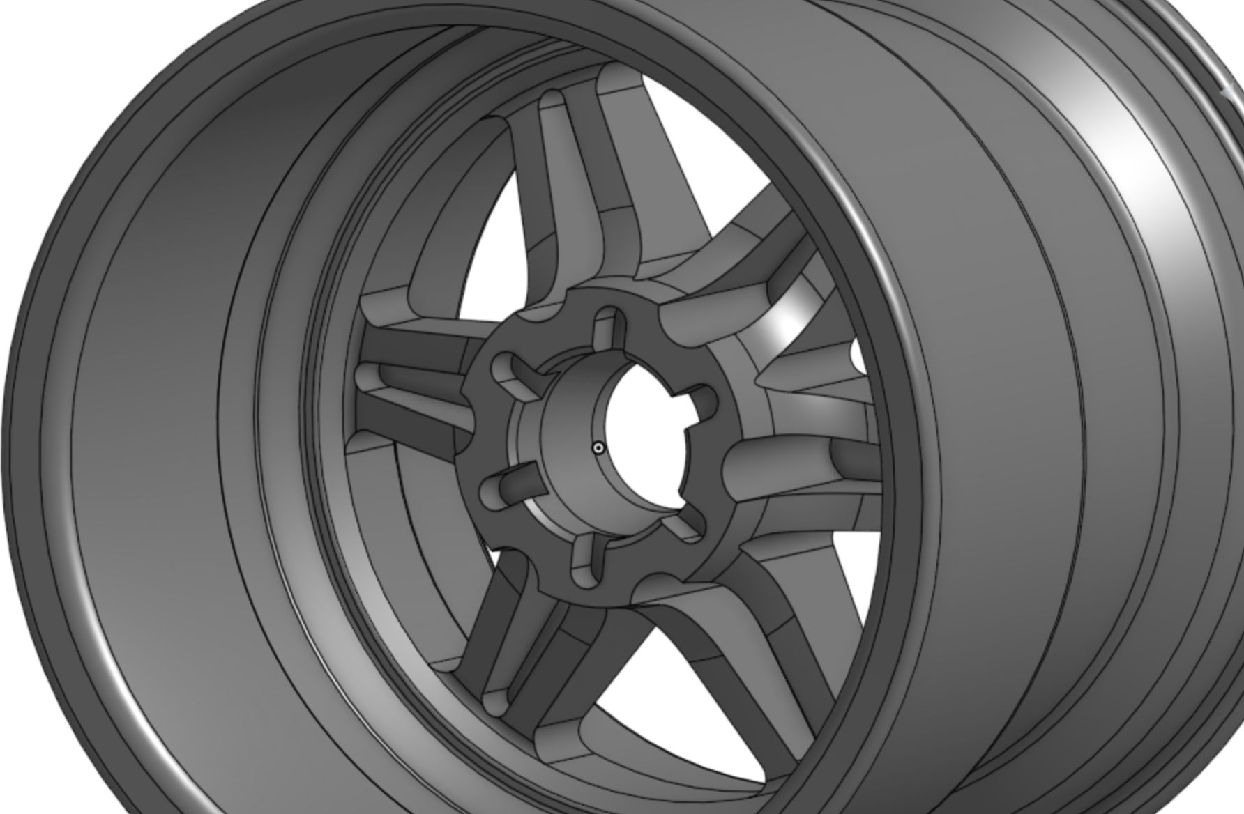

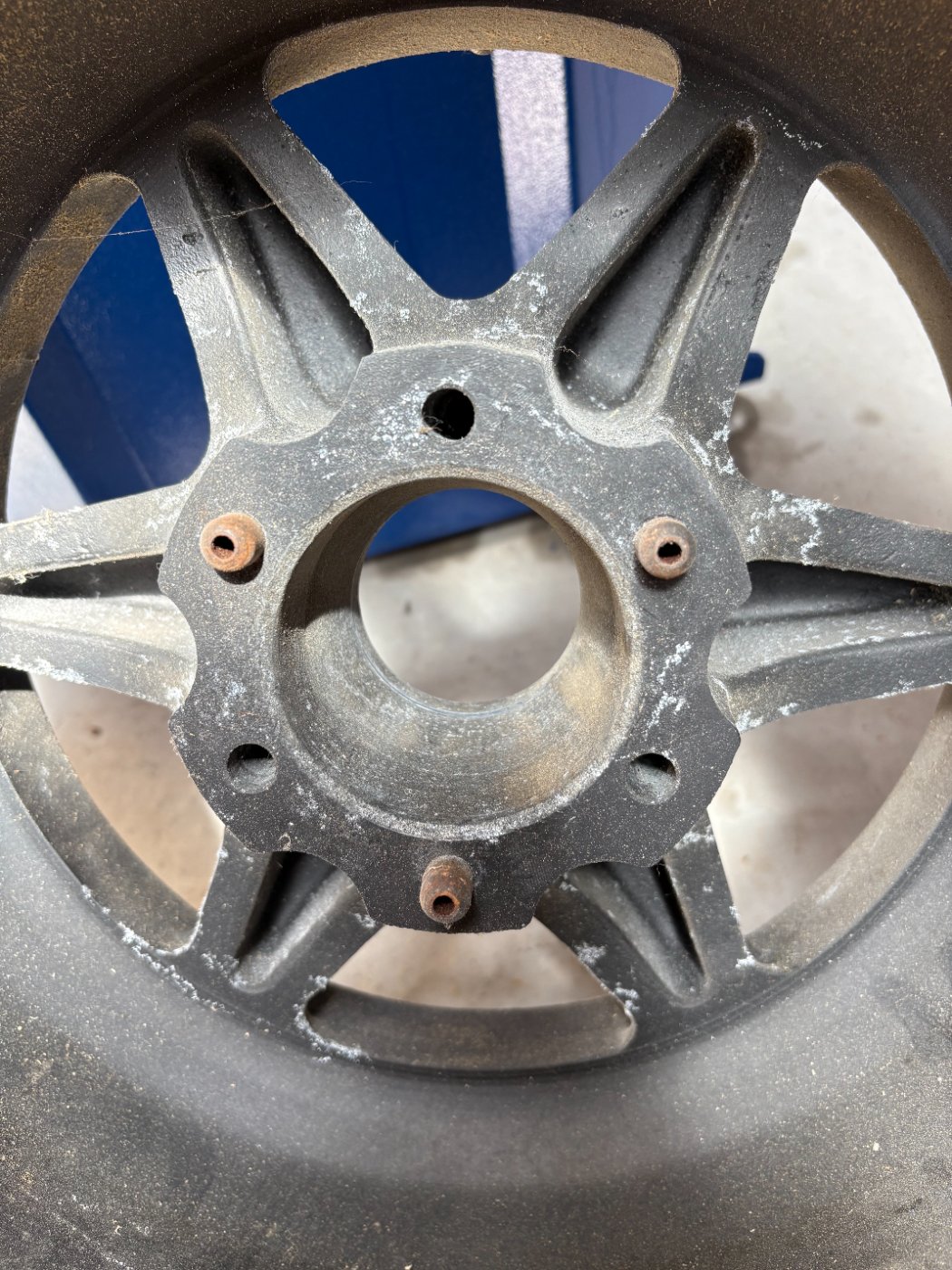

I am using original 15" Dia. x 14" (R) and 15" x 10" (F) BRM wheels in my build.
The rear wheels have six slots to accommodate drive pins from the rear spindle. They are on a 101.6mm / 4" PCD and to accommodate a 14.29mm / 9/16" diameter drive pins. The slots are also inwardly elongated. (Refer image).
At the front six : 11.18mm / 7/16" diameter drive pins are on a 101.6mm / 4" PCD.

Hi Mark,
Can you check your PCD dimension please? I believe the correct pattern is 6 holes on 4.25 pcd. Also may have something for you on the uprights.
Ole Nylende
The PCD on original wheels are 6 x 4,25".
The problem as you probably have realised is that nothing else (from what i have found) use this bolt pattern.
So you either have to modify standard hubs, machine from scratch or buy custom hubs.
AK sportcars (SGT) replicas has been delivered with the correct 6 x 4,25" pin drive setup.
So a set of uprights from them would probably be the least painful, I believe John Wisher makes (or used to make) them for SGT/AK?

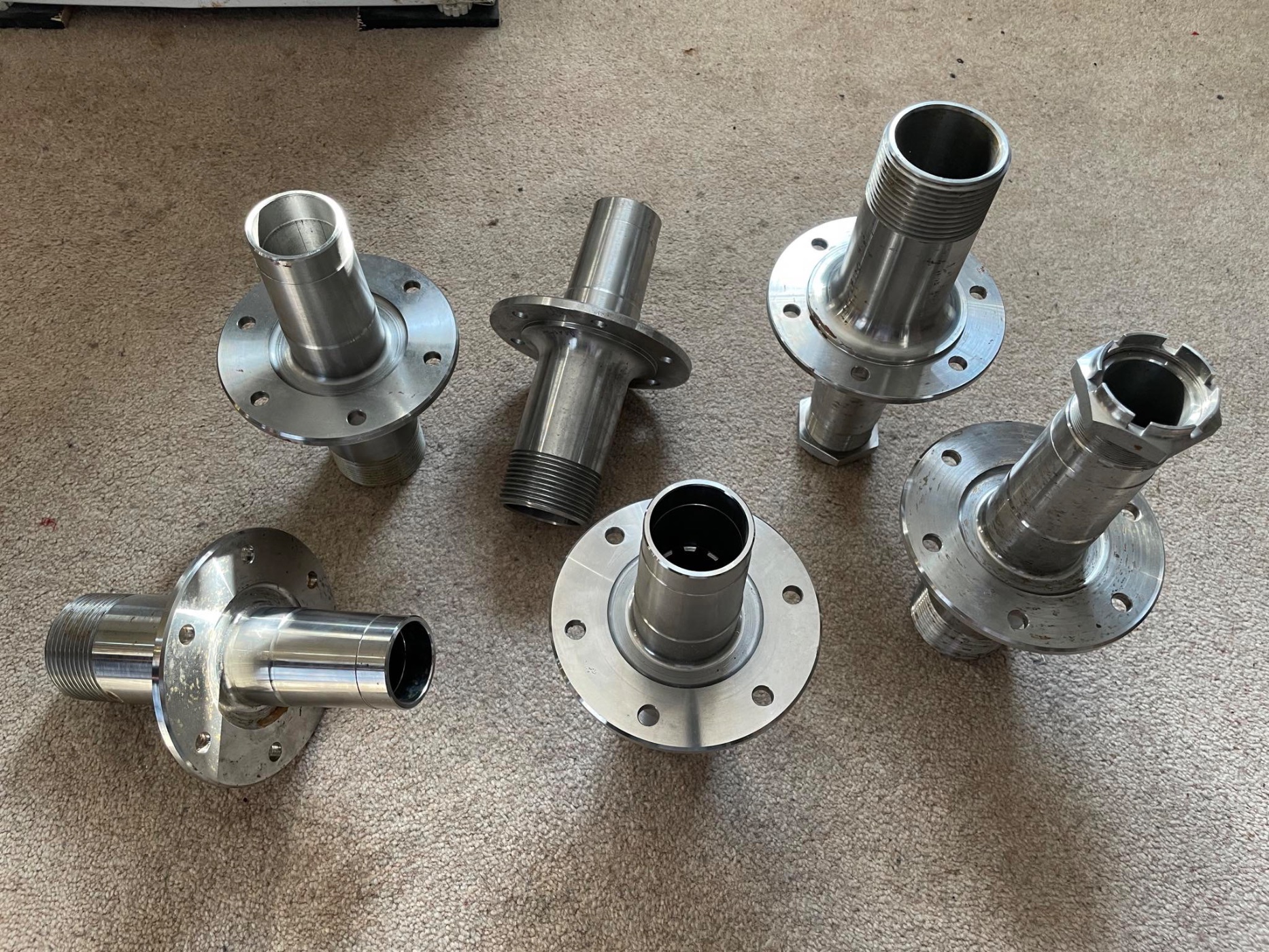

Nice, you still need the uprights to fit the hubs into, machining, bearings to suit, drawings for the machining if the uprights are raw, heat treatment, clevis pins, suspension arms with the bearings…. Its long list with bits needed.
Photo of some of mine for a monocoque.
Another option could be AK Sportscars if they can supply any 6 peg uprights for you.
Good luck
