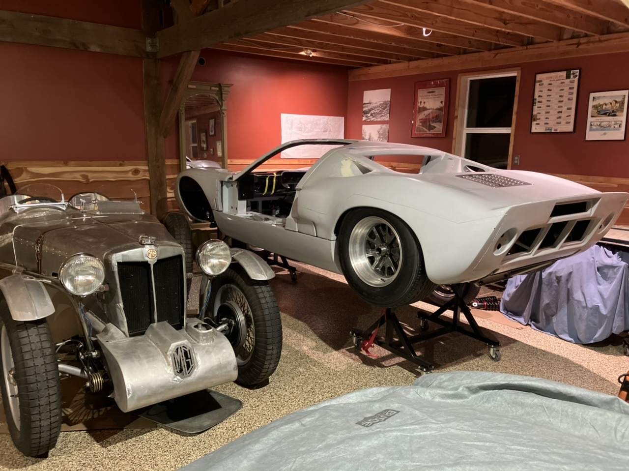

Davidmgbv8
My body is cast off of P1017 and P1054. It has all the original interior panels, ducts and two piece ducted hood. The bodies from current kit manufacturers have deleted a lot of the inner panels. They are wider at the rear fenders a bit. There are other differences in some lines I have seen in the front fenders and windshield pillars. From my recollection this goes back to KVA cars.
Fitting an original reproduction body on a modern chassis can be done it just time consuming but when you see these lines come together it is a beautiful thing especially where the roof doors and tail meet. A lot of small details, curves and swooshes to run your eyes over. The narrow hips over
the rear wheels draws me to just sit with a pint and ogle
