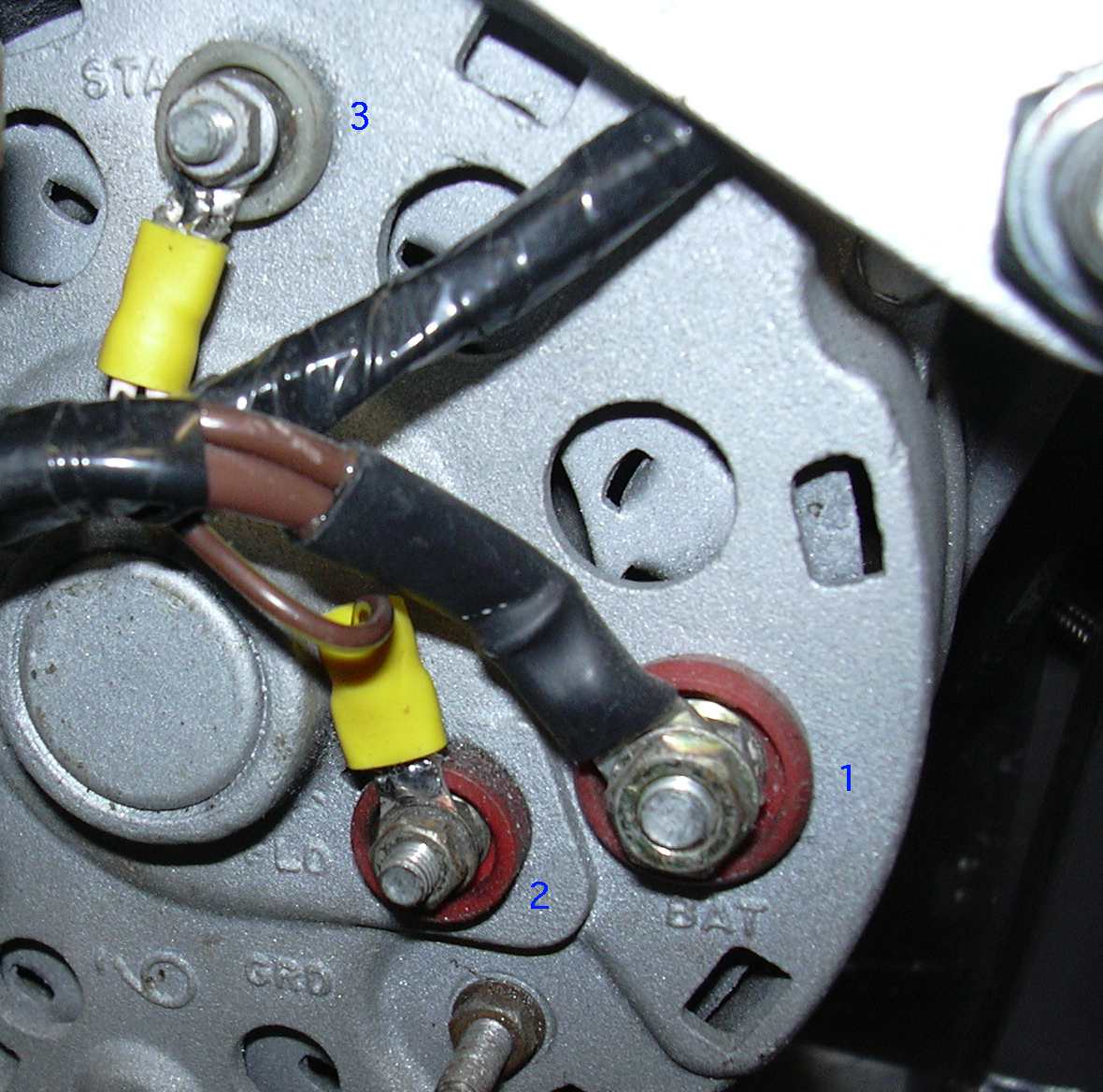

Just want to check my wiring. I've attached a picture of my alternator ...I understand from above that the large output cables (1) go onto my battery ,the field (2) should take it's power via the idiot light on my dash,- so what is the other connection (3) marked STA for ? Also when I first got this engine (alternator included with it) there was what looked like a capacitor between the FLD and the alternator chassis - is this for interference suppression or something. I still have it somewhere just curios.

Re: Alternator wiring ?
May as well ask while we're at it....see the post labeled GRD (ground). Needed? Or just insurance in case the alternator bolt makes poor contact to the casing?

Mike,
You need the STA(stator)wire (a switched hot) to excite the alternator.
Check with an alternator shop first, before you blow up the diodes, like I did in mine! /ubbthreads/images/graemlins/blush.gif A good power source is critical here.
After a bit of searching the net ,I discoverd that the Stator is the windings in the centre of the armature and the field is the outer coil fixed on the outside.
I had assumed these would both be connected inside.
Mike : I'm pretty sure that having the extra earth posts on the back are just for convenience (For other ancillaries) as the huge bolts through the case to the engine block should be a pretty decent earth. Also when mine arrived from the junkyard it had the Capacitor thing connected to it.
Paul
Check your search of the net again. I believe you will find that it is the outer coils that are the Stator (they are stationary) and the inner coils are the field coils (more properly known as the Rotor coil). So your assumption was right.
A point about the need for a lamp connected in series with the Rotor coil. If this lamp blows the Alternator may still kick in due to the Residual magnetism of the Rotor. Once the Engine rpm, and therfore Alternator revs, are raised the rotor is capable of being self excited thus powering up the main Stator coils.

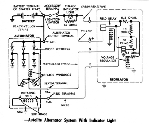

So I'm still fighting with my alternator. The first one I had in the picture had a broken diode inside so didn't work. I have replaced it and also got a regulator which I didn't have before and the shop gave me a wiring diagram. It is now charging but only if revved up to about 2000 rpm and even at this rpm if you switch off the master battery cutout the engine starts missfiring. I then tried measuring the voltage at the stator and it seems to be just 4 volts is this normal ? - the field seems fine on 12-13 volts. My wiring is as the diagram indicated anybody know a source where I can double check the diagram is correct ? I'm suspicious as it says the idiot light resistor should be 15 ohms - I had to find a 22 watt one as a 3 watt started smoking !
15 ohm is correct for this type of ford usa alternator,the current through the bulb only is not enough to energize the field.normally this resistor is build in the wiring of the cars.Do you have an regulator specific for this alternator.the stator terminal is normally about half of the output voltage and is used by Ford to heat the choke on the carburators.No other function to my knowledge so in your case this terminal has no wire.You can find a correct wiring diagram in most ford usa shop manuals 60'to 80'I can help you on one if you want. /ubbthreads/images/graemlins/smile.gif

Here's the one that I used to wire it up - I'm starting to suspect that the regulator isn't working properly.
