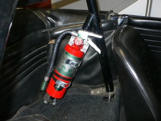

This page is for a project to build your own Roll Bar mount fire extinguisher mount. Simple parts, low cost, and all that stuff. The photo below is the first version I made mounted in the Sunbeam Tiger on the roll bar. I need to
move it down a few inches to make sure it never gets in the way of the seat.

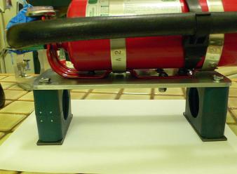

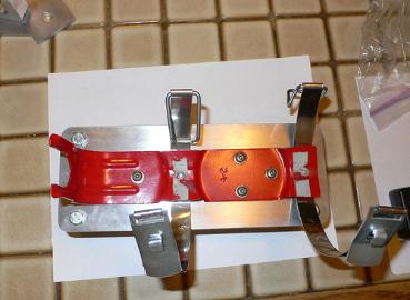

Top View, note you have to pull a strap off another bracket and pop-rivet it on. Add some foam tape to cover it up.

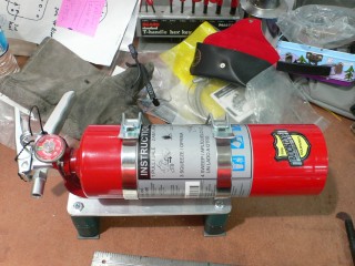

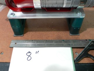

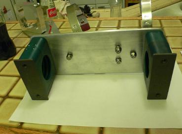

Bottom view of the bracket and the pipe clamps. Bracket is about 3.5" wide by about 10.5" long by 3/16" (0.1875") Thick 6061-T6511 aluminum, which was cut out of a 4" wide strip with my Miller Plasma Cutter. If you can use a pencil you can use a plasma cutter! Clean up with belt sander. Note the bracket could be a bit shorter if needed. Use your extinguisher bracket as a guide. Or if using the Brey-Krause Quick release Extinguisher bracket very
short.

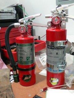

Halotron - Left
Dry Chem – Right

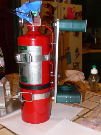

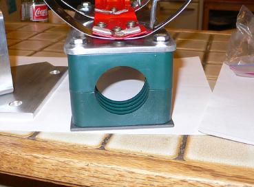

End View of the bracket. Note you can get it for most any sized pipe depending on your roll bar. I have an Autopower Roll Bar that is 1-3/4" diameter pipe. They also come with a zinc plated plate that is not shown. It can be used to replace the bottom plate (Has built in threads) which is made of black oxide steel. In any case you will likely need longer bolts. I'm going to use the Zinc plated non-threaded plate with lock nuts. The size of the bolts for that will be 3-1/4"
Some added shots of a second mount. This one was for the Mustang (The Ripper). I made it a couple of inches shorter after taking my own advice. Shown below is the Dry Chemical extinguisher mounted, but I have a Halotron that will replace it. One thing that I forgot to mention is check the center bolts that mount the extinguisher bracket (Red one) to the top plate. These can hit the roll bar if not trimmed.

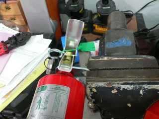

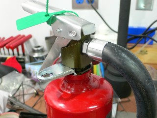

The last bit of work is for the Halotron extinguisher which has a hook type of mount that must be removed to be able to use the standard bracket. This is not hard, clamp it into a vice and twist it off. It mars up the nice anodized head a bit, but not much you can do.
short.
Halotron - Left
Dry Chem – Right
