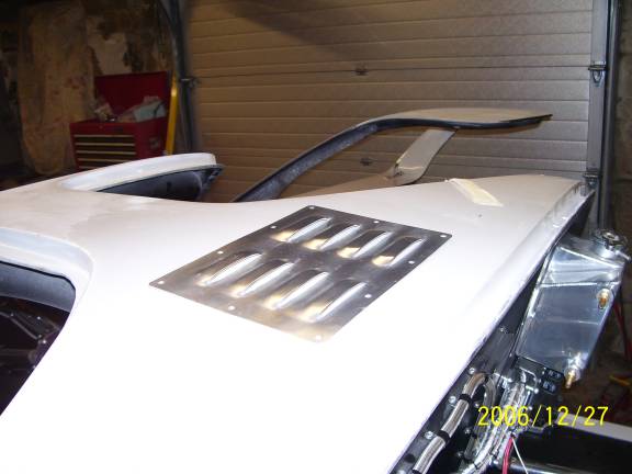

There is a rectangular louvre vent plate in the back center of the roof on MkII's. I would like to include this feature on my car. It looks a lot like an air grille often used in the construction / marine industry.
Has anyone info on the original source or better still the dimensions of the actual panel? I could then get one made up.
Any help appreciated
Steve
As in this?
Paul

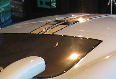

It certainly is, thats a very nice photo this was the best I had!
Is the car original? It is often not easy to tell. I could estimate the size but some original dimensions would be a great start

SteveB,
I have one that measures 9" X 6 1/4" . I'm in the process of casting a mould to make them out of fiberglass or carbon.
Ted Baird has or had a couple of aluminum panels. They might be for sale. His tel.# is 330-533-6056
Gregg
Thanks for your help on sourcing this part, it's better than I expected to find and looks just like the original cars from the pictures in books I have. It will look the business!!
Steve
