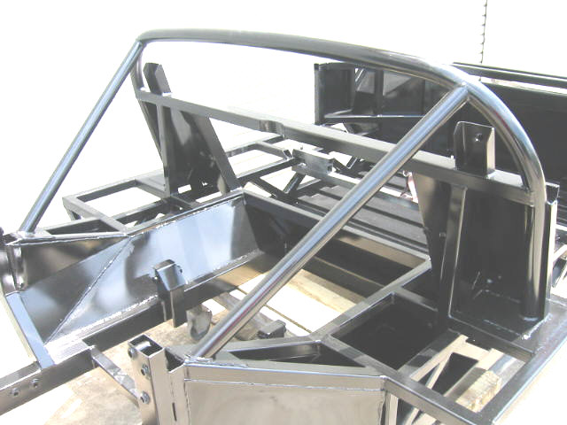

The following pic is one showing the DRB roll hoop which is available as a factory option. When I bought my car, it was "just started" by the previous owner, & he didn't have the roll hoop done at the factory. There was no way I was going to drive around with nothing but a bit of fibreglass over my head, so I had to retrofit the hoop & braces - a bitch of a job as the spider is virtually permanently bonded in place before the basic body/chassis kit leaves the factory.
Kind Regards,
Peter D.

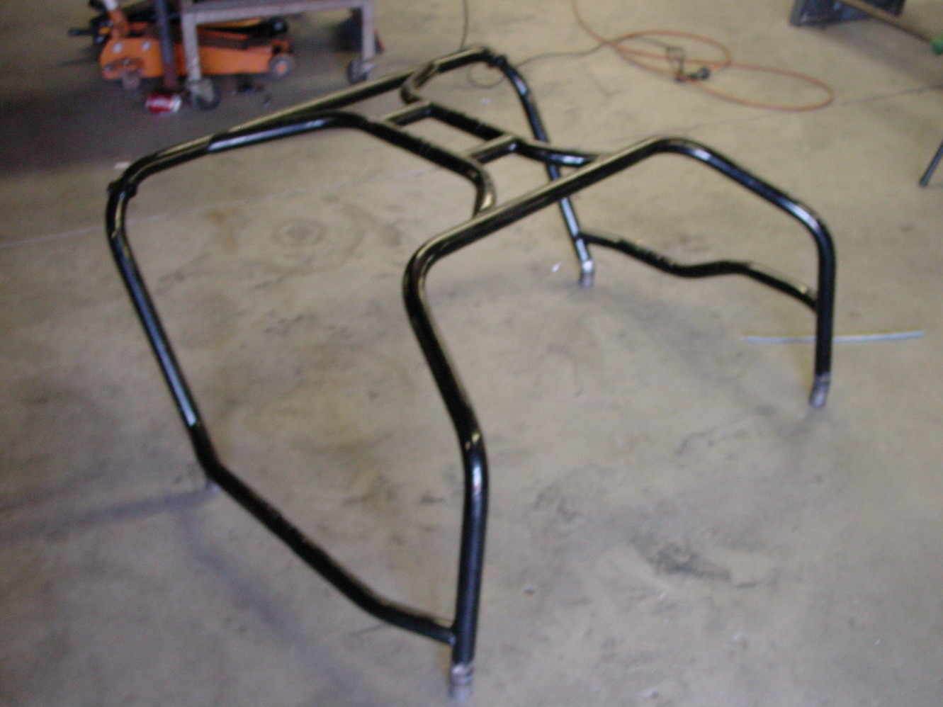

Tim Kay
Here's a pic prior to bolting to the chassis (Tornado)via 1\2" bolts thru bungs. Can't tell by the picture but it's two pieces so it can be removed with the spider in place. And believe it or not, the ingress\egress is made easier due to griping the cage with you hands for support.
