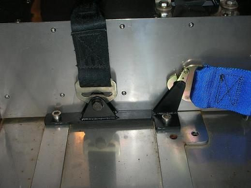

I made up these brackets so that I could use both the lap sash and the harness style belts. I had them approved by the engineer working on my car. They took a bit of work but seem to work well.

A angle bracket as per Peters pic mounted to the strips.

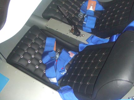

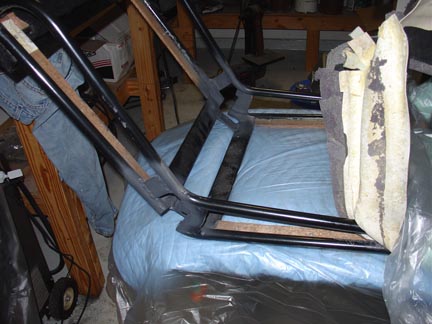

for what it's worth, I cut the seats, welded on a brace to use 5 point harness. Seats look unchanged after they have been put back together.
