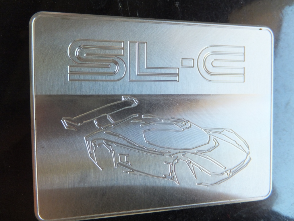

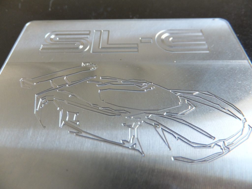

Today's efforts...
The plate with the car is a simple engraving, fast to make... $40 NZD + shipping
3 tools used, 60 degree engraving cutter 0.2mm deep, 45 degree chamfer cutter, 4mm iscar ECA-B carbide... happy to add build number, names etc.

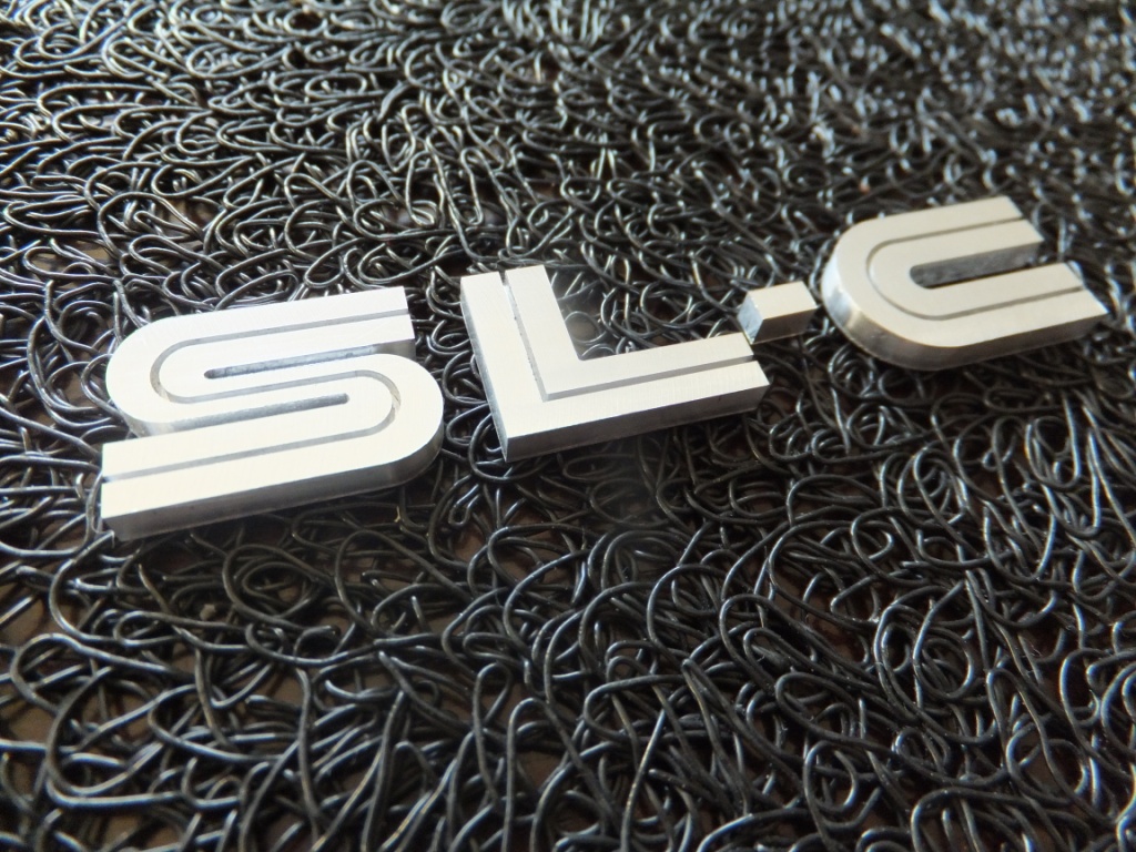

Hi Guys
These letters are 4mm thick and about 80mm long for the set..
They took a lot longer than the engraved plate and used a 0.5mm cutter for the mid letter slot, a 4mm carbide to rough the letters out and a 1mm carbide for the final clean up..
I think I can trim some of the time out of them but did wonder if a wax mold for stainless steel lost wax casting might be the best solution.

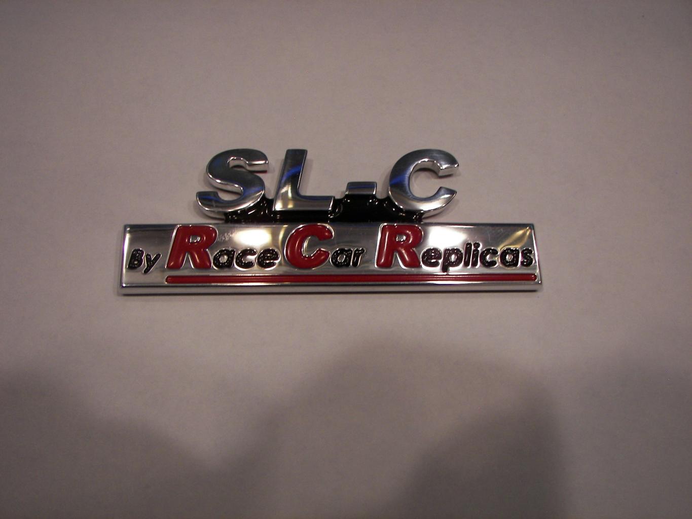

Here is a pic of a SL-C badge that I designed and had made for me. My intention was to place the badge on the left rear portion of the street wing.
Although I think I failed to list the badge in my for sale listing; it too will be included in the sale of my car.
Jim

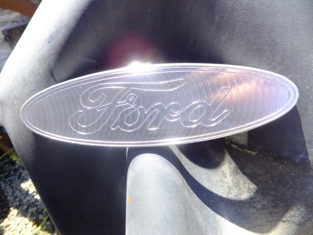

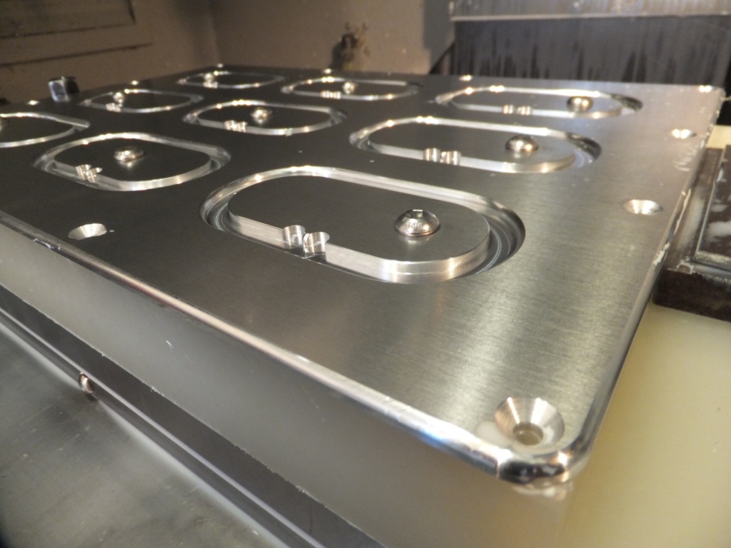

A bit off subject but I didn't get a chance to do anything on the logo today so here is my GT40's top grill instead. I started with 4mm ali and slimmed it down to 2mm leaving it 4mm in strategic places. I used a 3mm radius on all the outside and inside edges which really catches the light... I must start my own build thread...
Cheers Craig Young

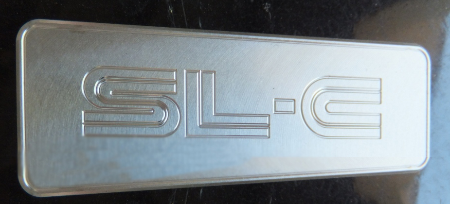

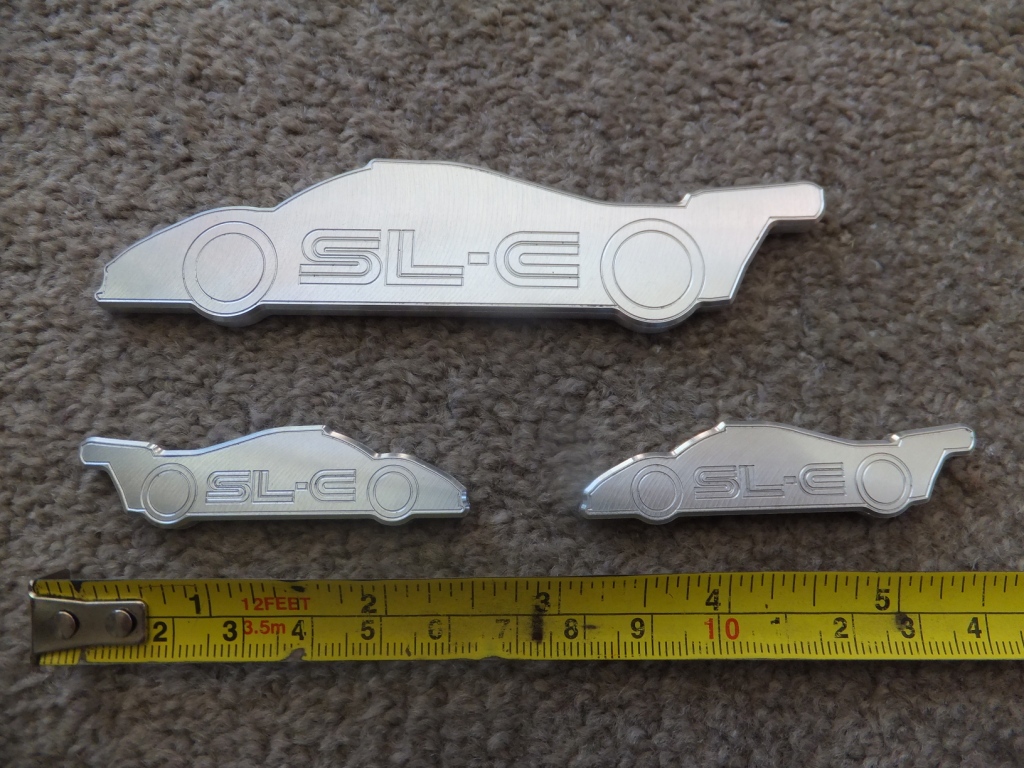

Hi Guys
I managed to get some time today and here is what I came up with..
Cheers Craig Young

Hi Jim
I was thinking the larger one is for the rear of the car in the spoiler area and the 2 smaller ones for for the flanks behind the front wheels...
They look good in the flesh but the pictures don't quite look as good..
I did think a SL-C key ring for the smaller 2...
I guess what I'm trying to say is I can manufacture to suit your application..
I just needs some details of what you might want..
Consider this thread as a sample of what I can do...
Cheers Craig Young
