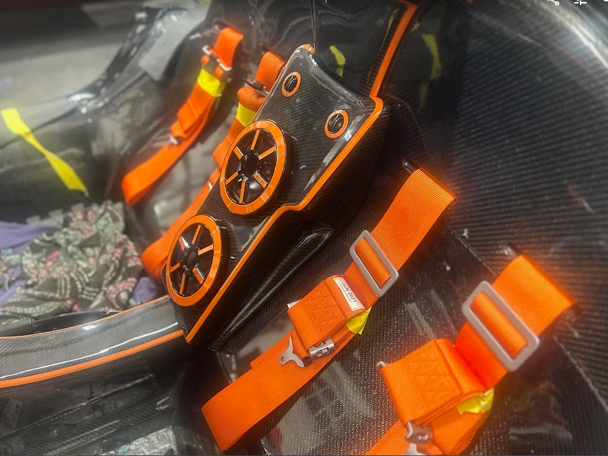

Interior is this, but I have some ideas if we absolutely need to cut some access panels.

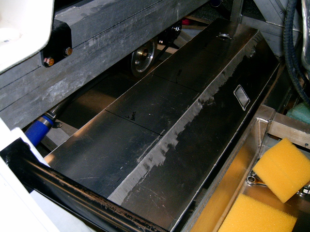

The bottom of my car was closed off with aluminum under the tank from RCR. This was a 2015 car. I’d get a flexible camera, the only two locations I know of are the vent fitting and the gauge location on very top of tank.
Does anyone have any pics of the tank they got with their car? This is an LT4 build. I'm just looking for some type of road map here.
