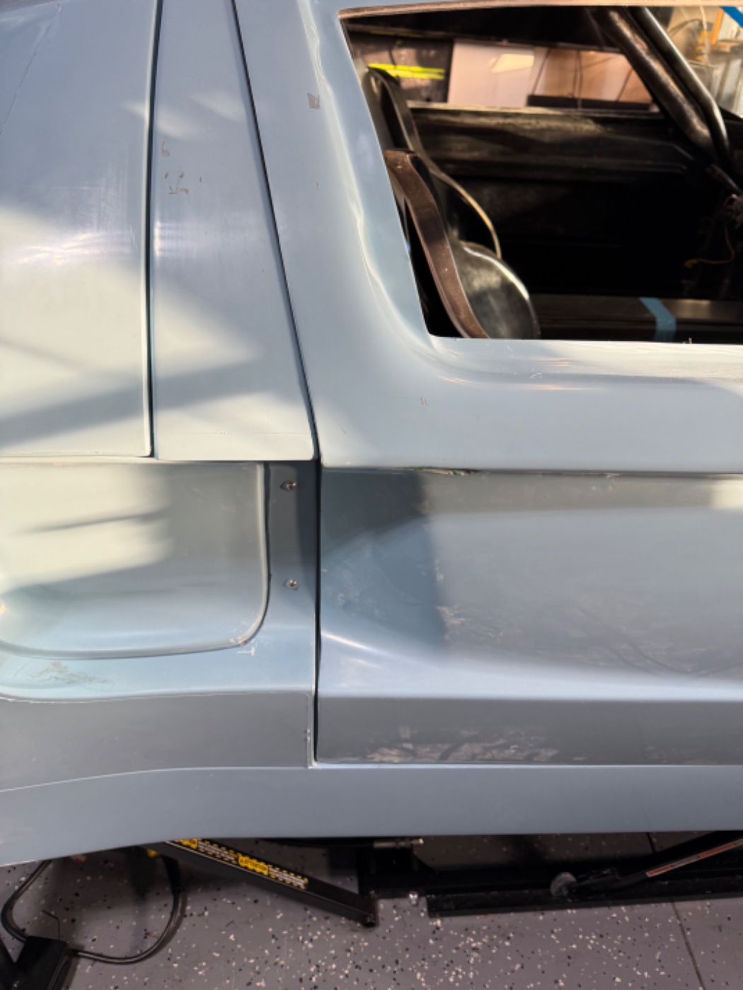

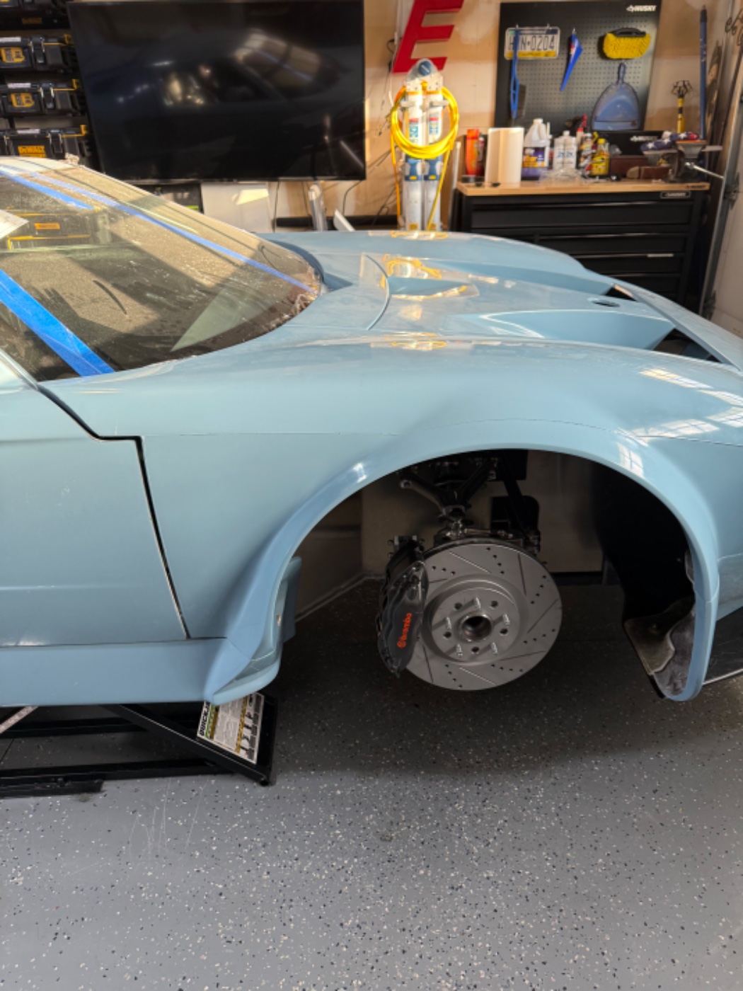

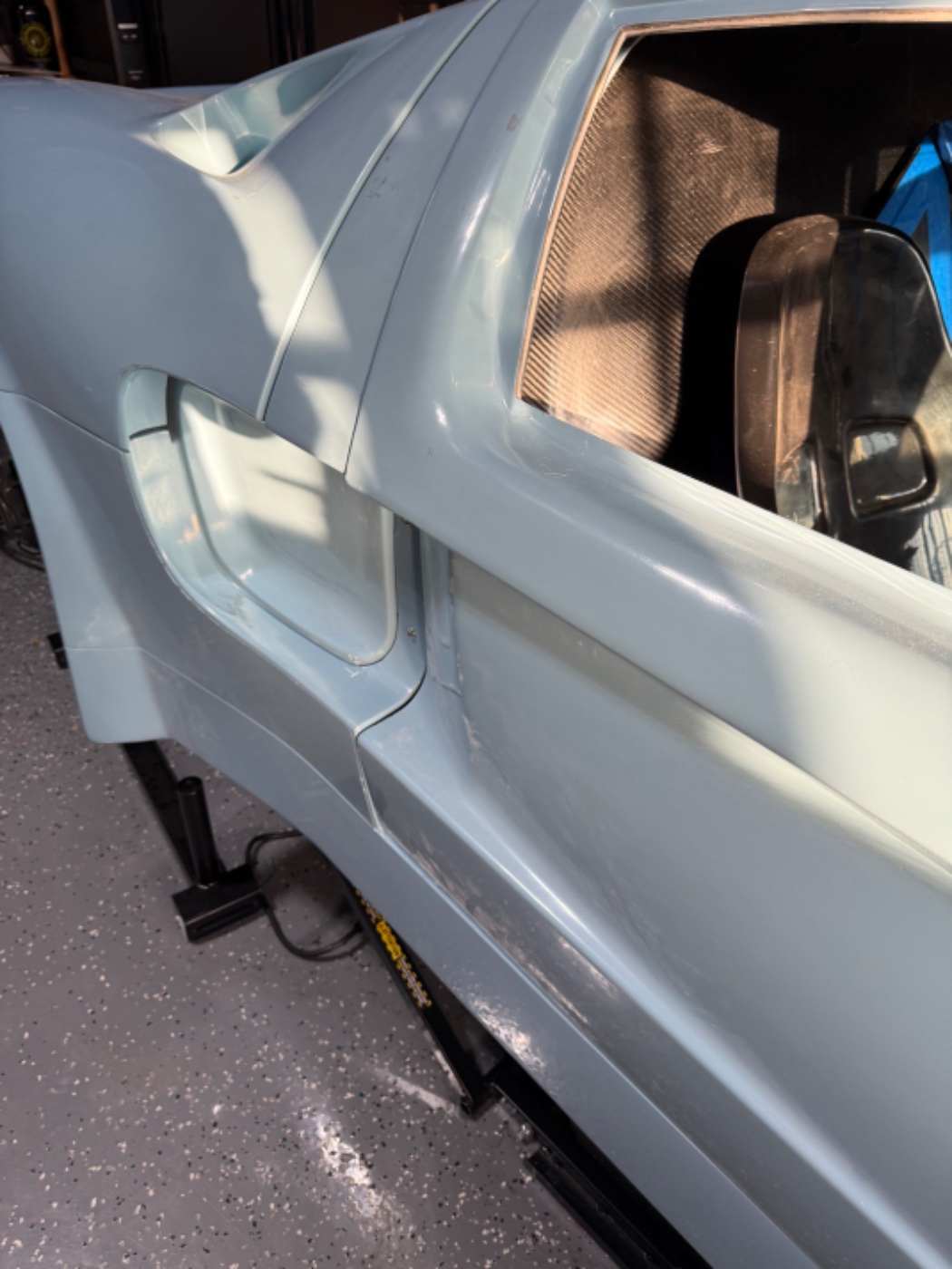

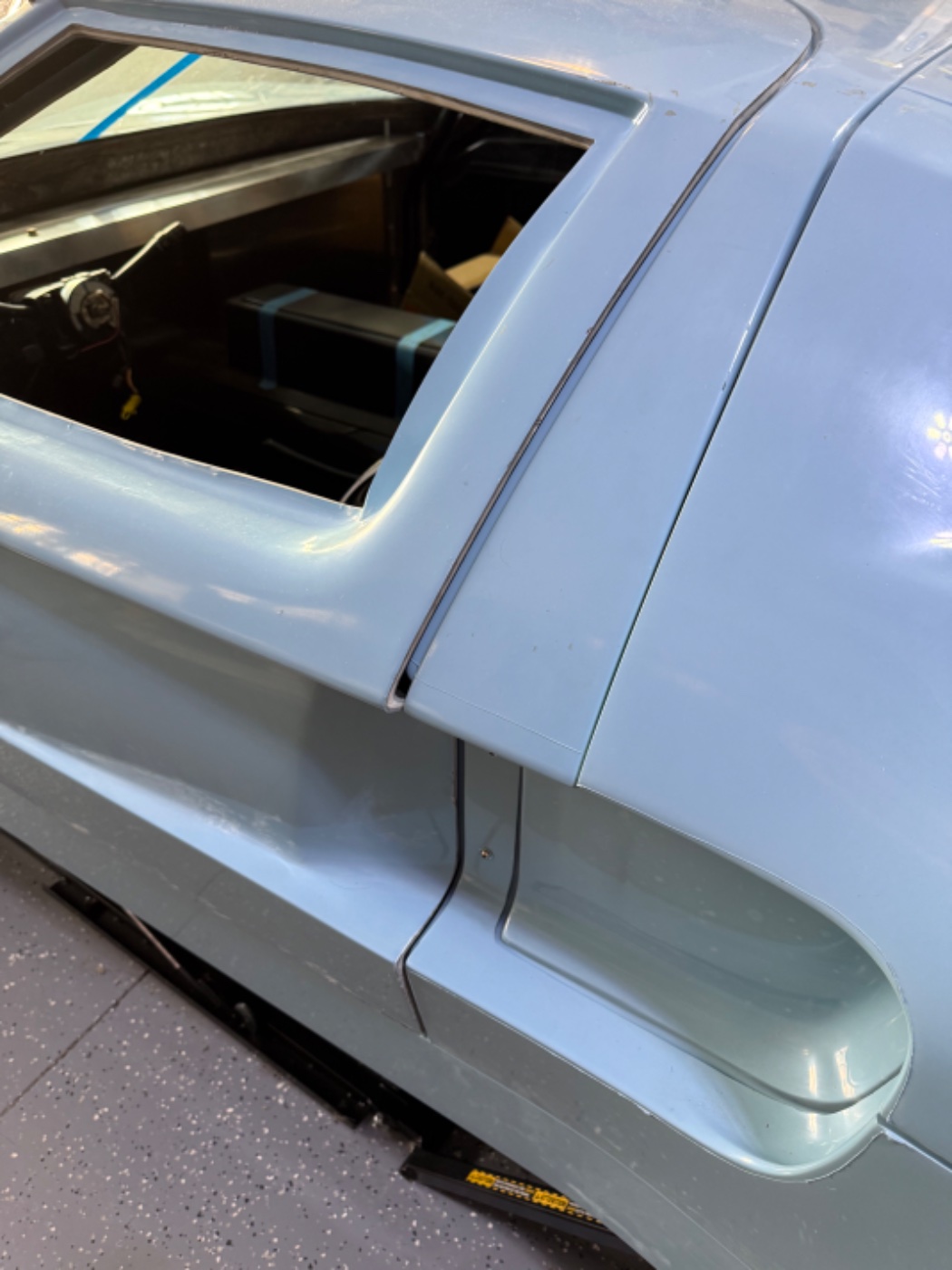

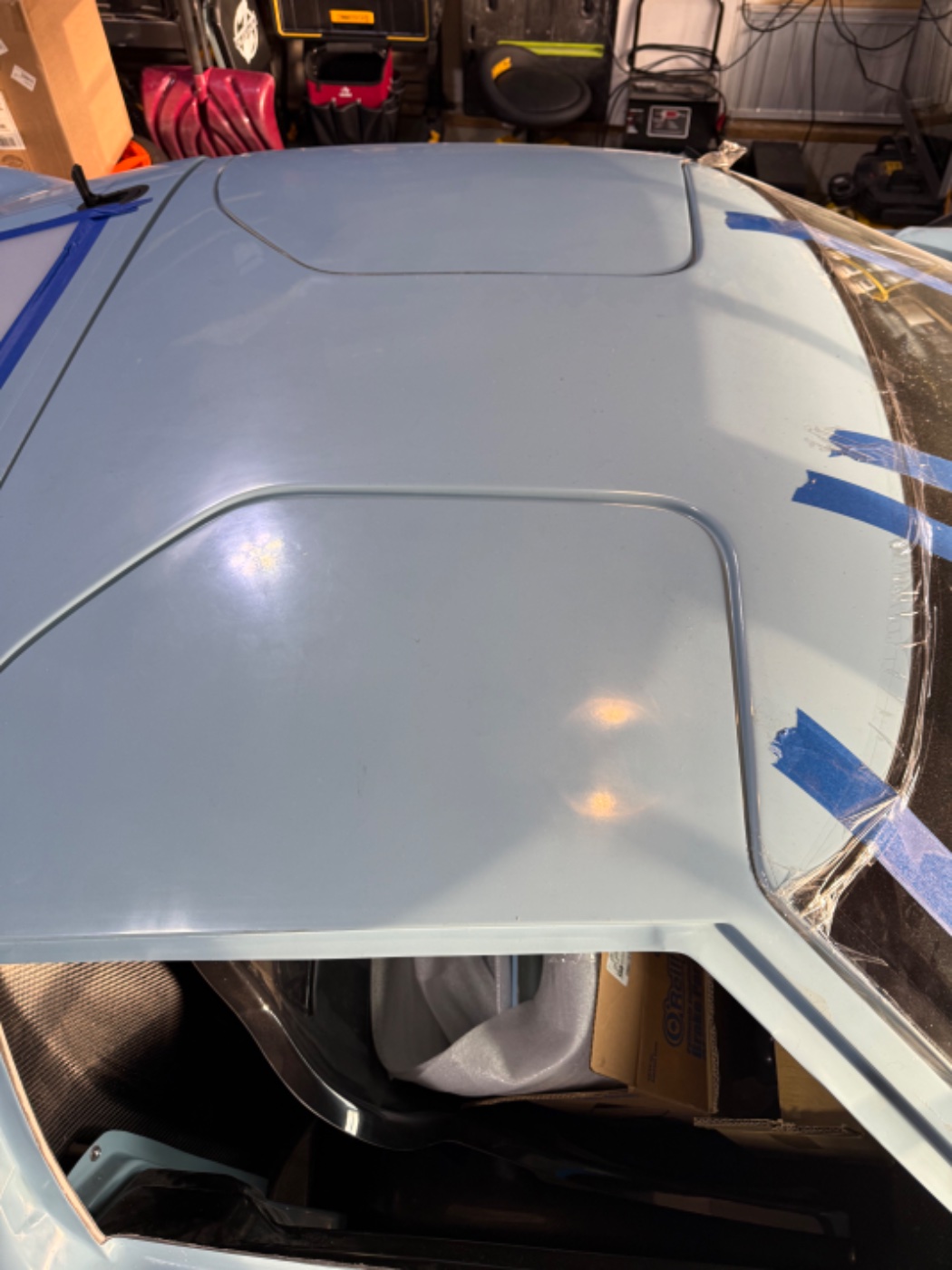

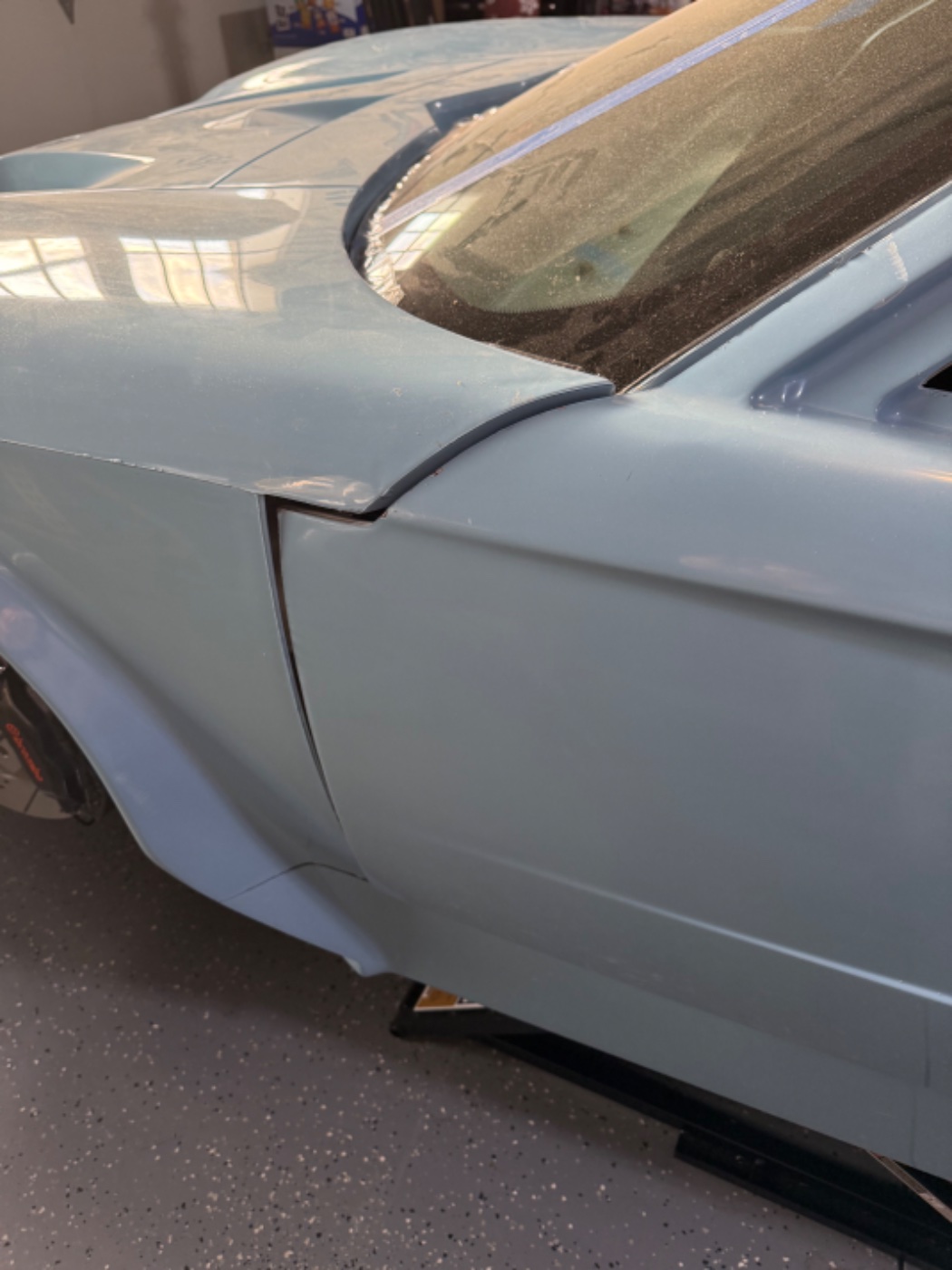

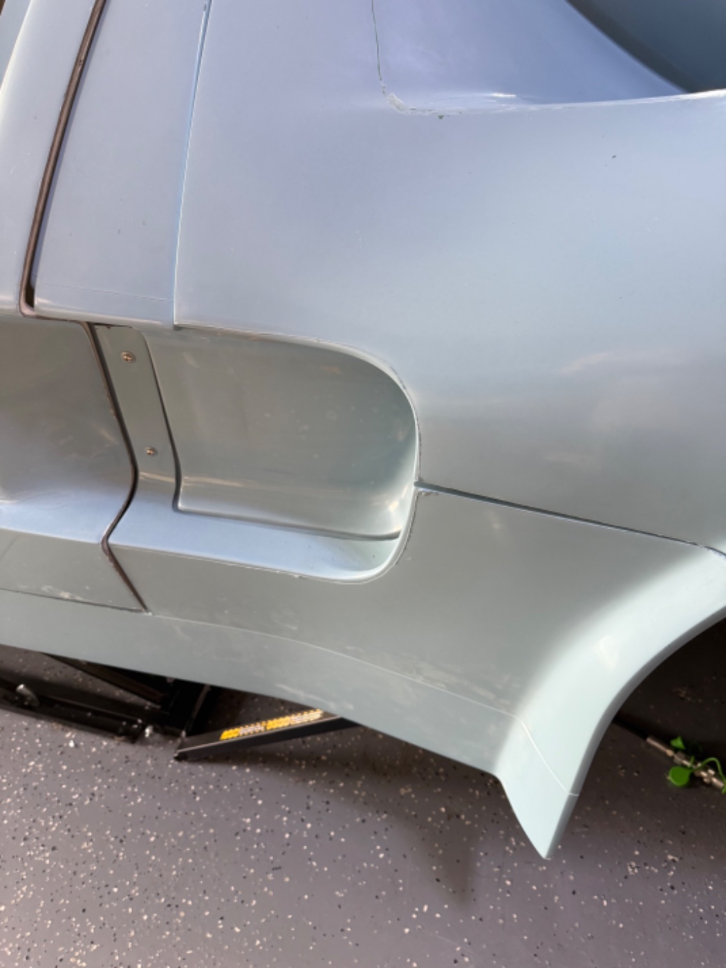

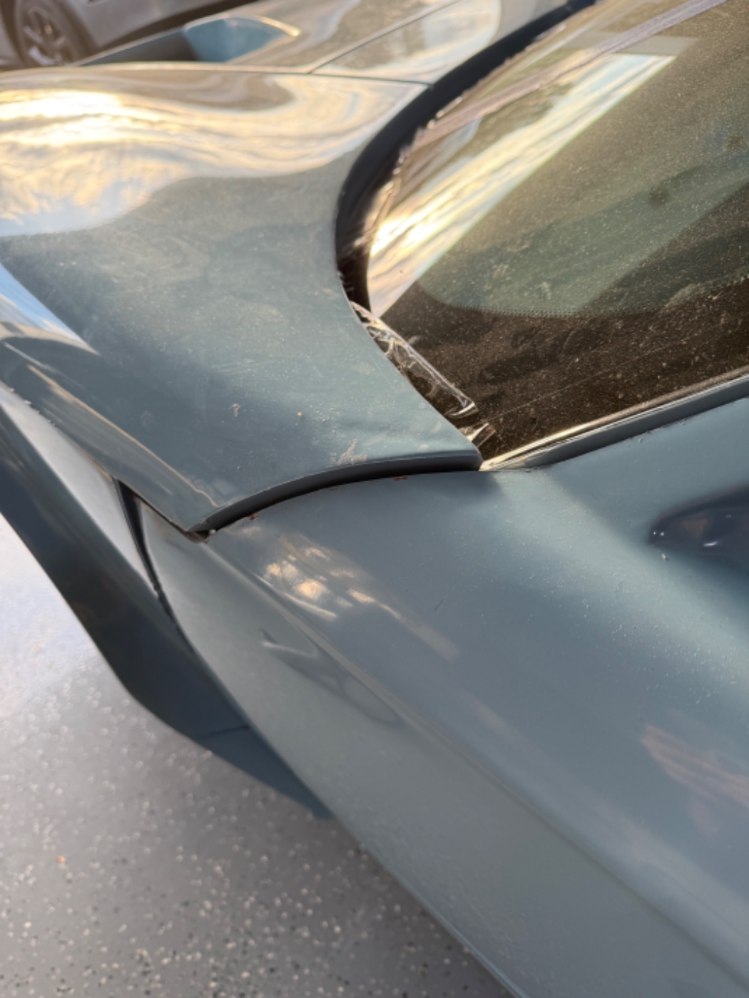

Hi Randy. The doors are hung but not aligned well at all. The body isn’t fit terribly but I thought it would be a bit better than it is considering I bought the body alignment/fitment option. So I am planning on saving the body work until the end. Here are a few pics of the current state of the car.

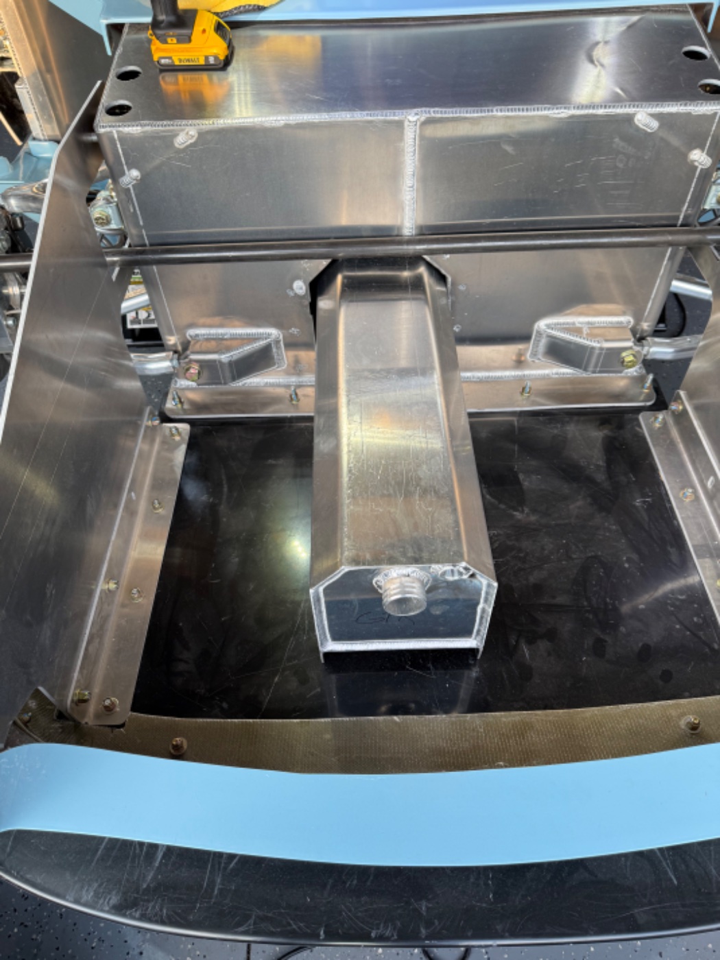

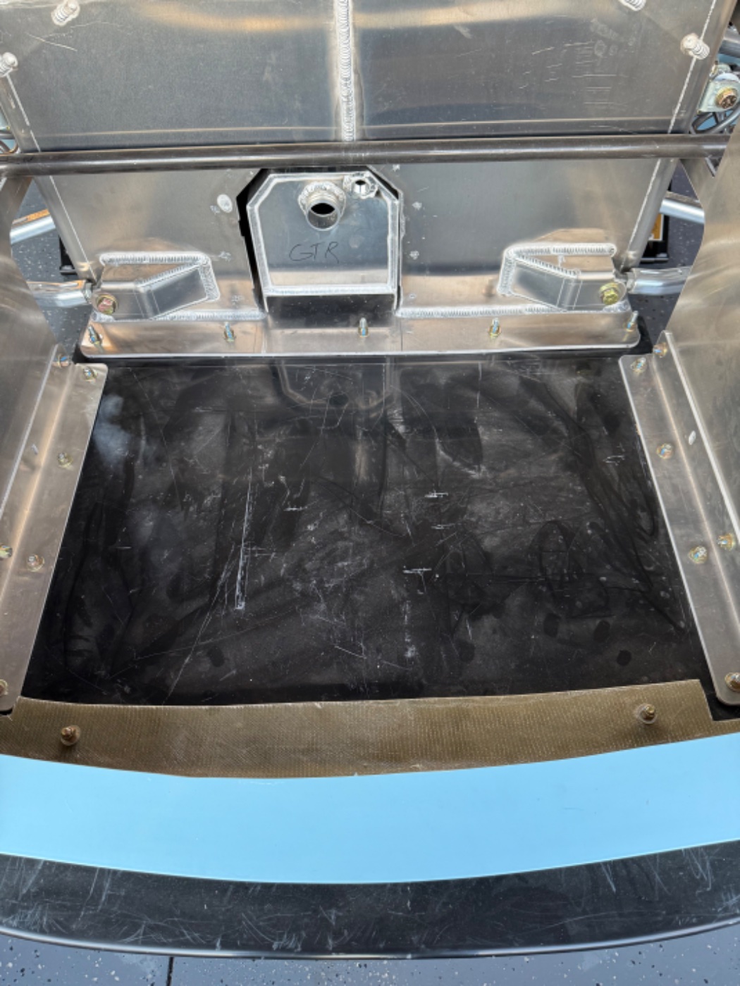

I have a couple friends coming Saturday with the intent of squaring the fuel tank work away. I think removing the nose of the car will allow me to slide it out. There appear to be a few bolts attaching the nose at the footwell and a few more attaching the spoiler across the bottom of the chassis. It won’t be easy as a couple of bolts are directly behind the coil overs. A few more pics to show that area are attached as well.
Any advice is appreciated. I am hoping to slide the tank out insulate it some and install the pumps and slide it back into place so I can put the nose back on. Storage is a constant issue for me at the moment. I don’t know exactly what is involved with the tank but since I have some help I am really hoping we can get it sorted.

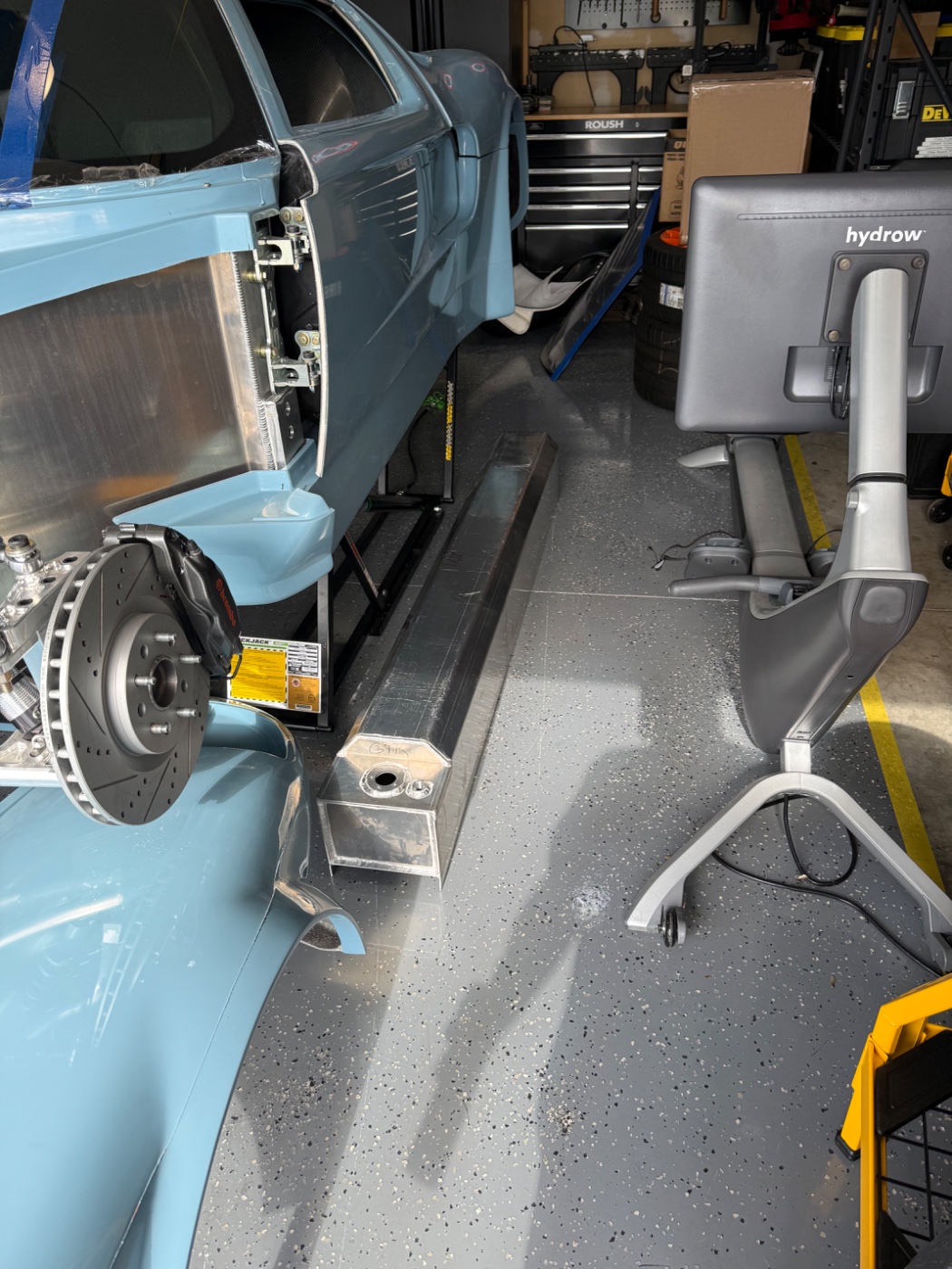

Removed the nose and the tank as expected the tank had only one bung. Looking for a welder to put in a bung for the return.

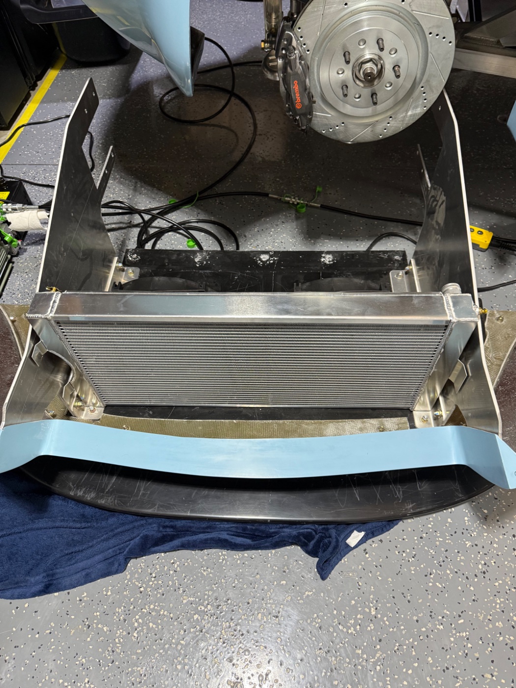

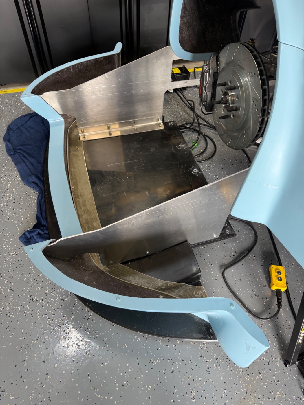

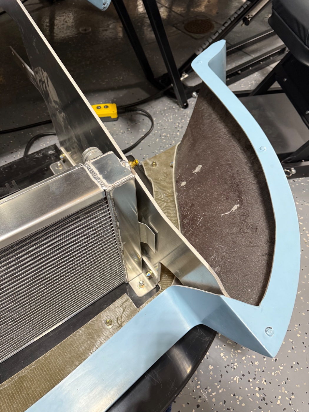

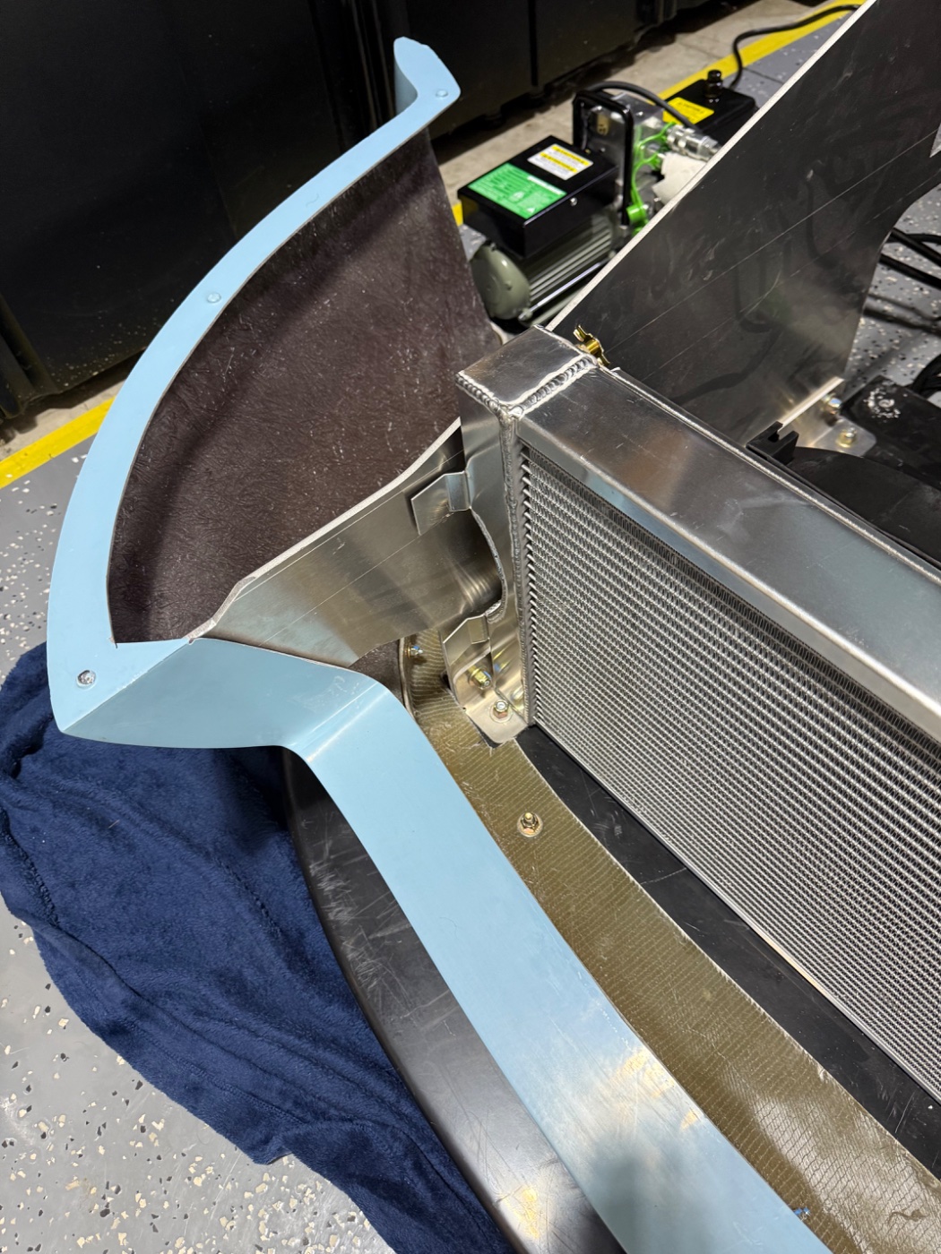

In the meantime i will install the radiator. Is there proper placement for the radiator? I have seen pictures but maybe its so elementary that prople dont mention things like the proper angle and/or clearance between it and the splitter. There are tabs on the side of the radiator that i think i can bend to eliminate the need for spacers. A couple of bolts there and that should do it i believe.
Any suggestions would be greatly appreciated.

Hey Ken, Are you planning to do any of the H craft mods? Like raising the spliitter for street use, or cutting out the hood opening. If so, might want to wait on the radiator. Rasing the spiltter will tighten the clearance a bit. Also, I would use a rubber dampener beteewn the radiator and side panels. Best to keep it from excess vibration. Hopefully someone else can chime in here.
Ken Evon
Thanks Rob. Thats good advice on both counts. I havent seen a lot of pics of the splitter mod so i will look into that and then decide. I really appreciate your help.
On another note i found someone to weld my tank for a return line so im planning on picking up some insulation for the rear firewall and working on the nose so progress doesnt completely stop while i line up the welding.

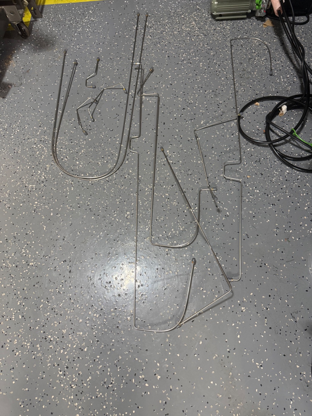

Ok. Tank is out at welding so i have begun to explore the world of brake lines. A few question for anyone able to help. First, have you all drilled and tapped holes to attach fittings and retaining hardware? Next, did you find any hardware that needed to be added (i have read and been told that the banjo bolts provided by superlite arent right)? What fittings and gaskets did you ise to get the lines through the front firewall and into the pedal box? And finally can you all help me make sense of these? Which lines go where?
