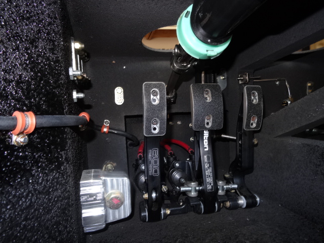

I'm 6-2 with gun boat 13 shoes. I have the extended footbox so here is a pic. I have the Olds column and even if I had the Cadi one, I couldn't use the functions anyway. Got to take the steering wheel off to get into the seat. If you want another shot let me know and I will go take one.

Thanks for the picture Dan! The front 2x2 cross-member that the front lower control arm bolts threw must have a notch in it? approx. how far forward is the extension beyond the front firewall would you guess that the masters are sitting in?..............................thnk's.......m

The font lower control arm bolts outside the footbox if I read your location correctly. I don’t recall any notch there. The rear is of course inside that big silver cup. I’d say the MC stick about 1/4 to maybe 1/2 inch into the extended hole. The real benefit came with getting MC hoses to mate with the inlet to to MC.
