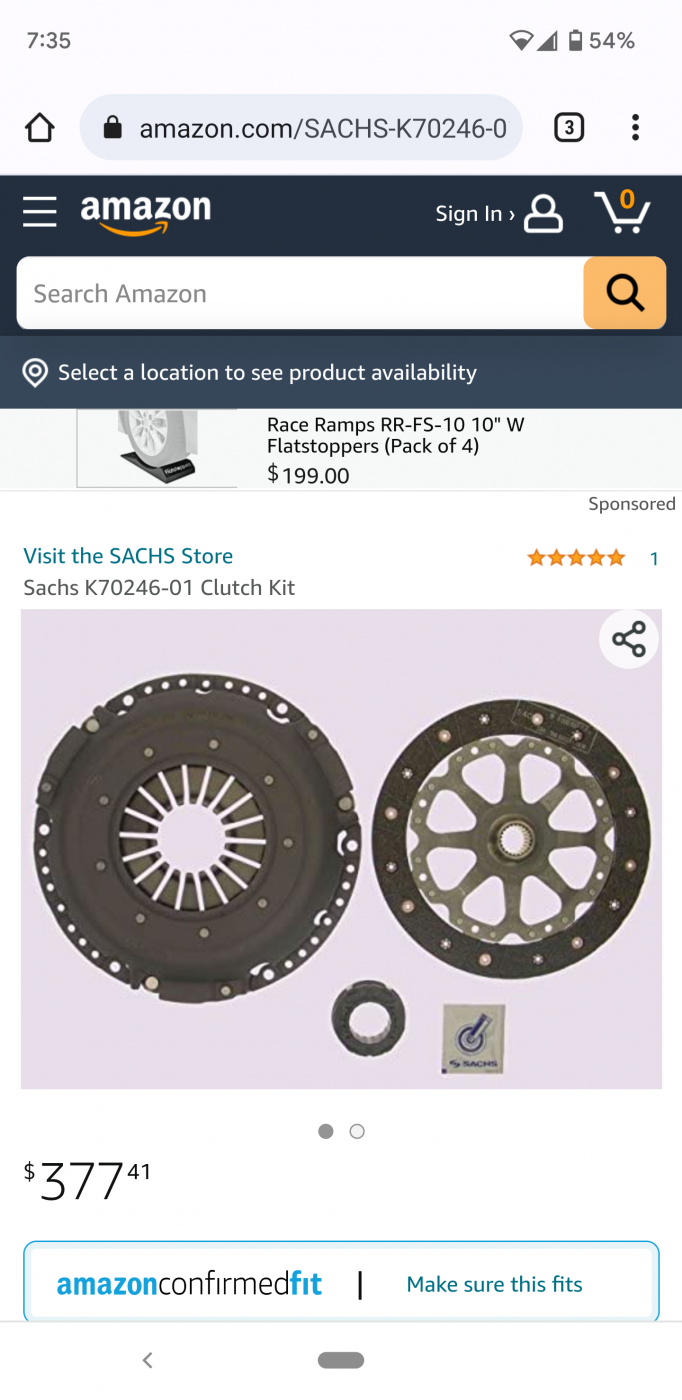

I can’t see how the clutch could be slipping with only 500miles unless whoever you bought the car from before had zero idea what they were doing. I would start by pulling the trans and taking a look at everything. Clean the flywheel, see if the clutch discs are worn down, etc. you can source a new Oem set from rock auto for like 350, here is the part number K7024601

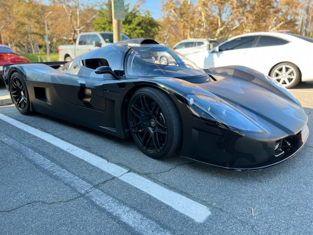

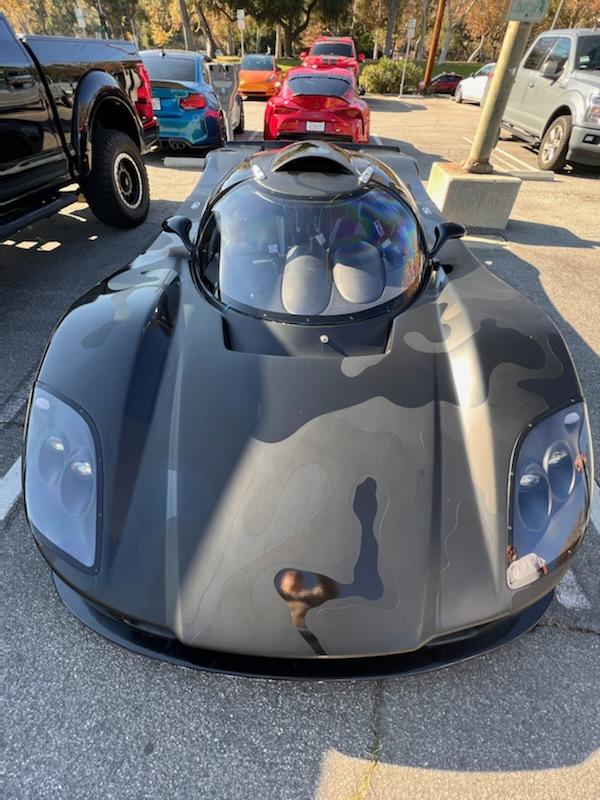

Well here she is
This is the clutch I ended up going with, It is very inexpensive . My first time swapping out the clutch on the SLC . It feels great to be back in it again and the clutch feels amazing!!
