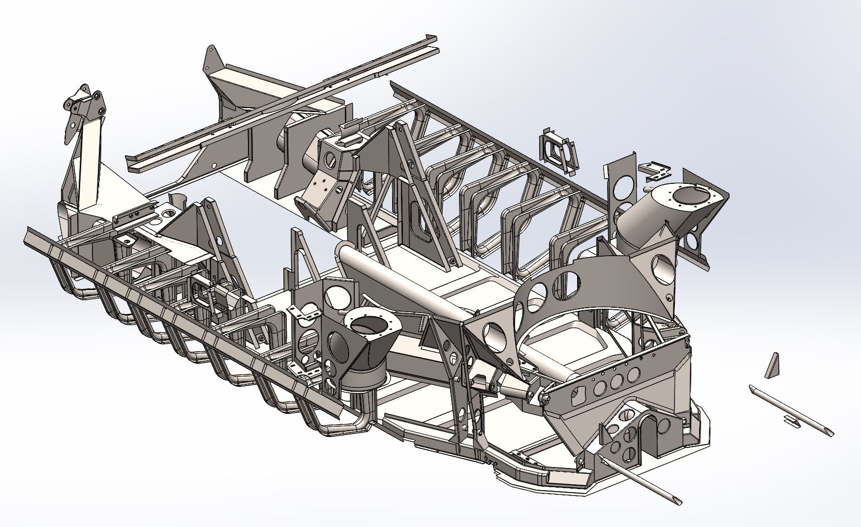

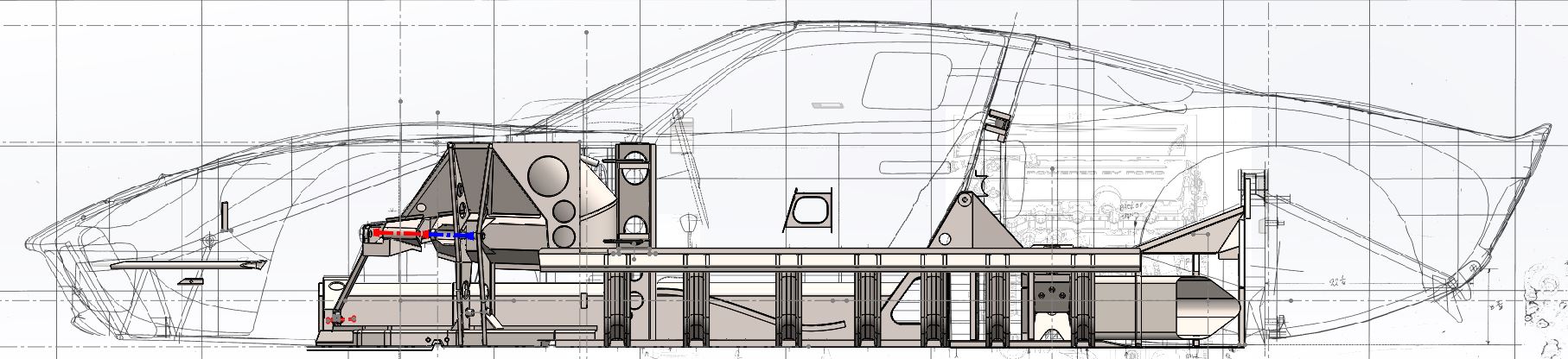

  • Accurate 3D Chassis Model – I’ve spent around six months, working part-time, to redraw the original GT40 chassis in 3D using existing 2D drawings and real-world measurements.

Do you have a line drawing of the side profile of the body with out any inner structure included? I'm trying to figure out the ground clearance height at the front of the wheel arch of the front clam as it relates to the bottom of the front of the rocker. I'm working on positioning the ground clearance height of my front clam before I place the hinge pivots.
