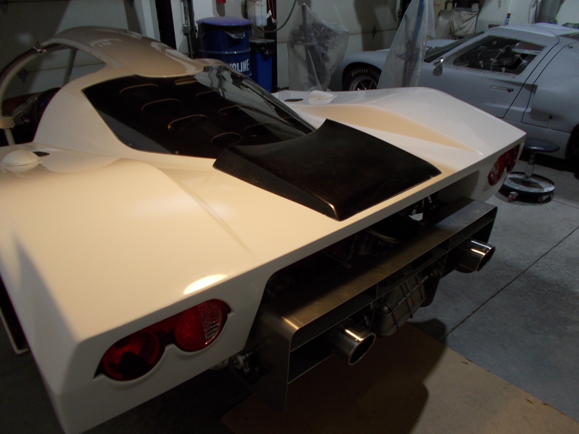

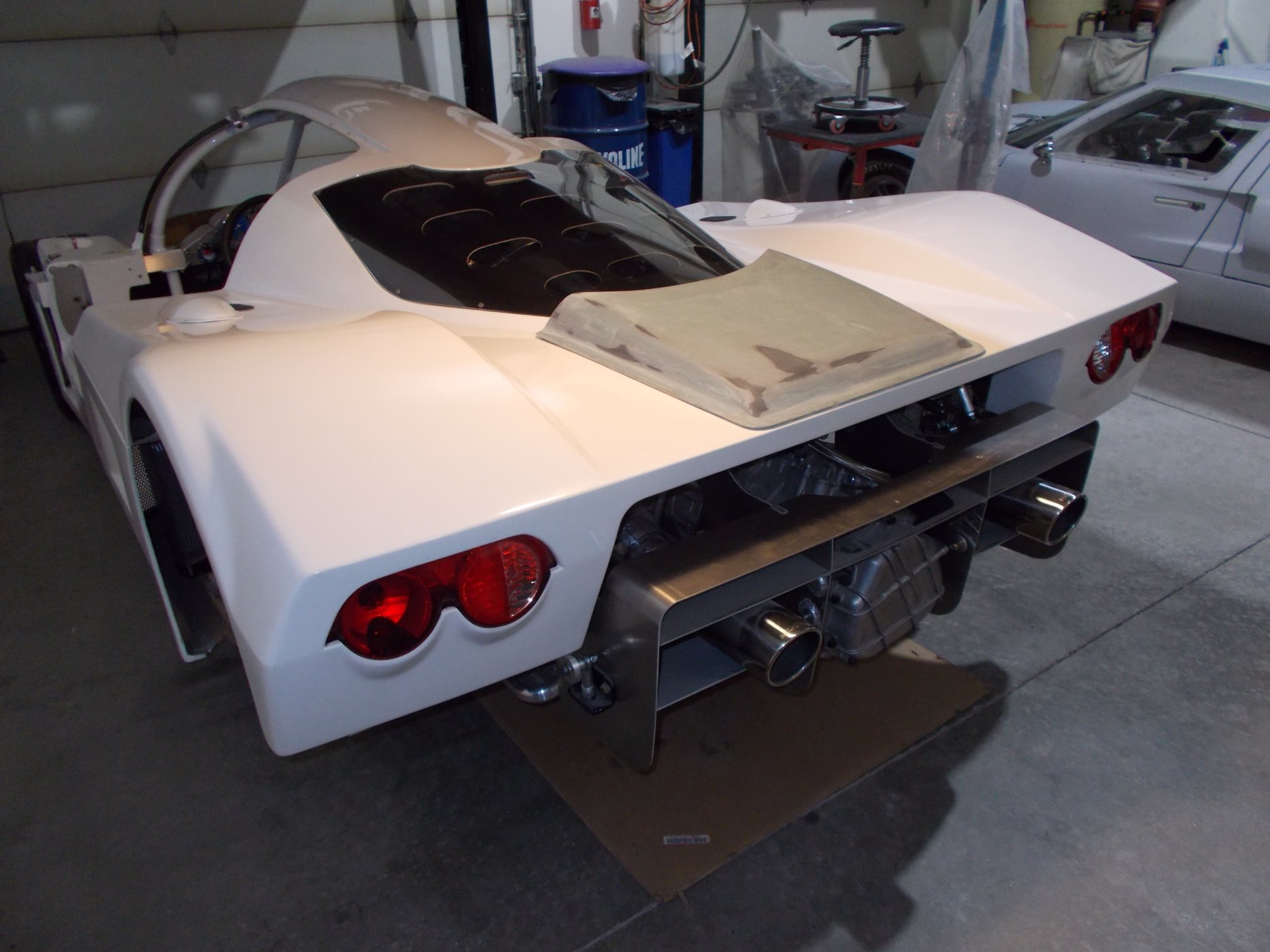

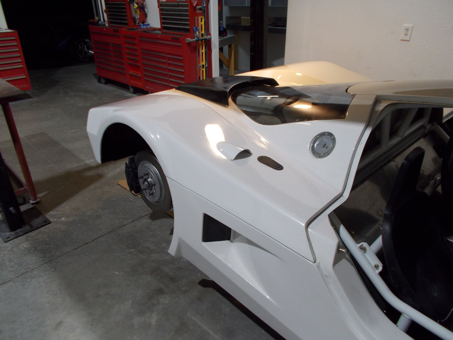

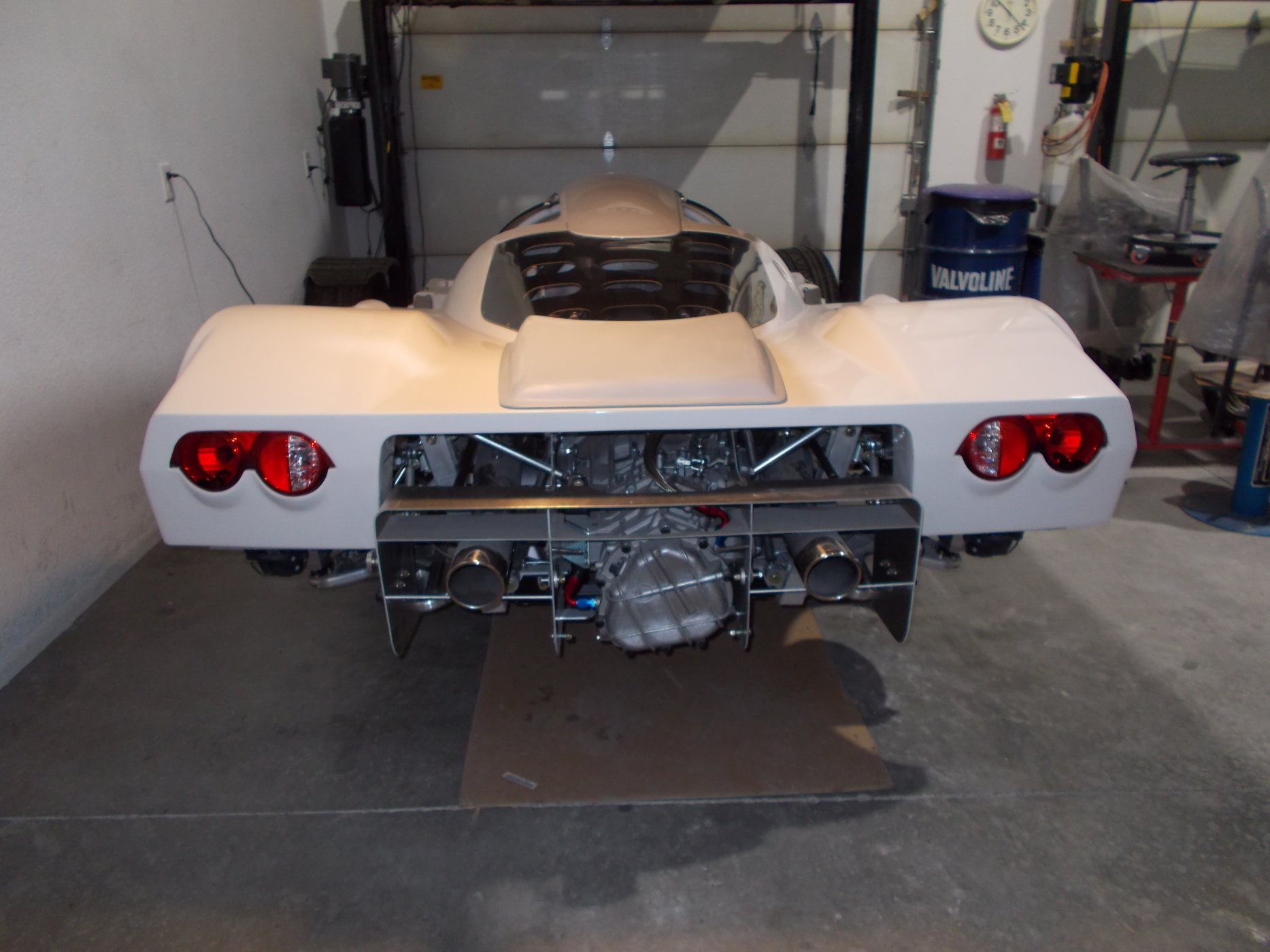

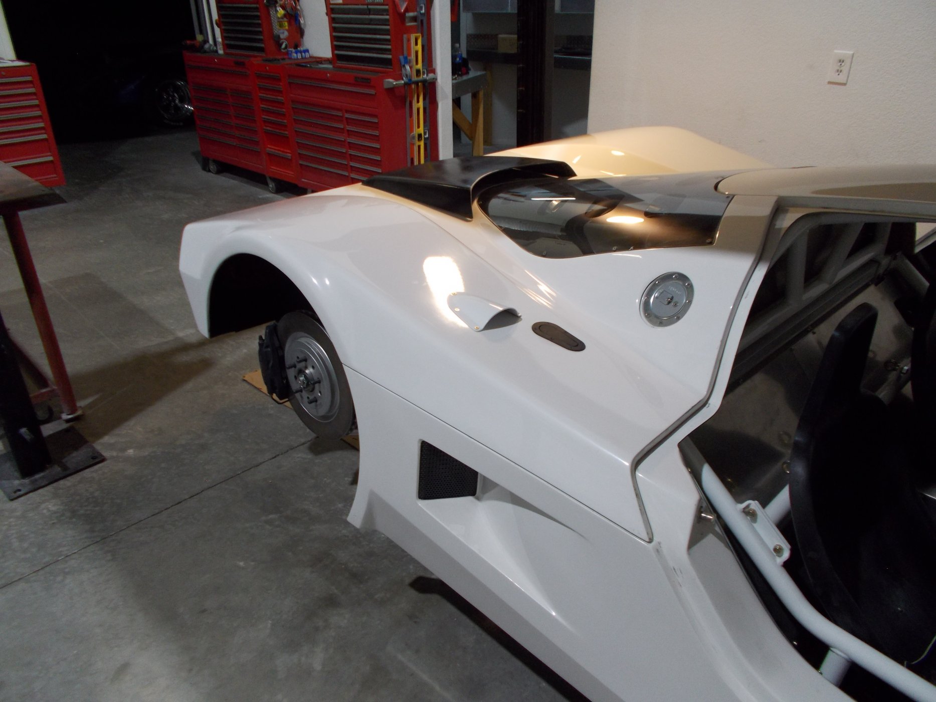

Trying to figure out where to pull cold air from on the back has been a challenge the only solution after looking at it for a long time was to install a scoop and I will build a cold air box. I went through my molds and decided that my boss 429 mustang hood scoop mold looked the best [at least for me] so I pulled one. I then trimmed for the different curve duraglassed for fine tuning to the body then fiber glassed the back of the lip for strength. I will install it to match my brake cooling ducts with stainless countersunk pan head screws slc rear scoop 2-20 001.JPGslc rear scoop 2-20 002.JPGslc rear scoop 2-20 004.JPG
