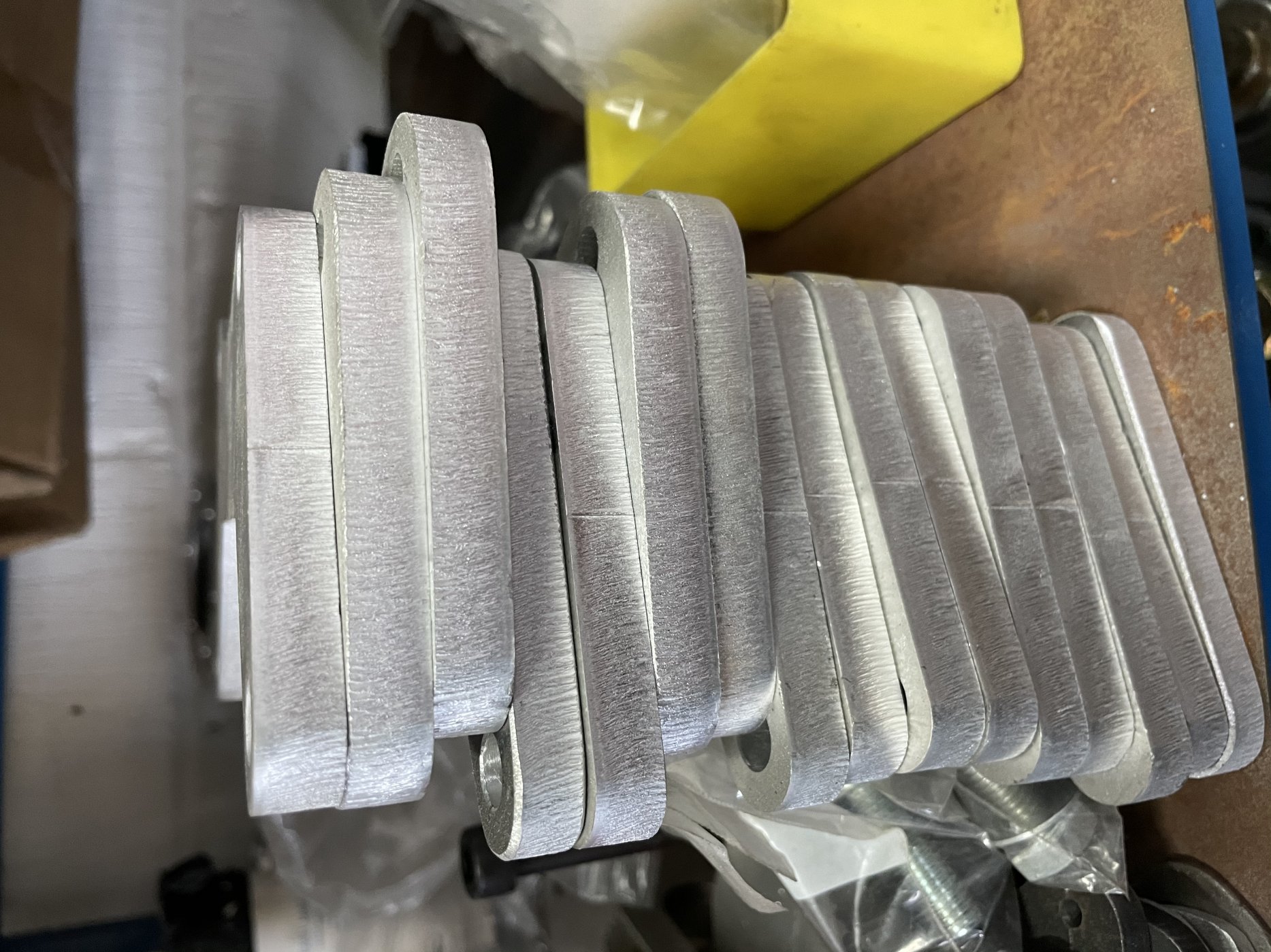

Hi David,
Brackets like these?
They’re stacked on Mick’s shelf, but not for long as all stock will be packed up and moved to the new owner’s workshop. Its also some shims you might need
Give Mick a shout before its too late to get the parts.
