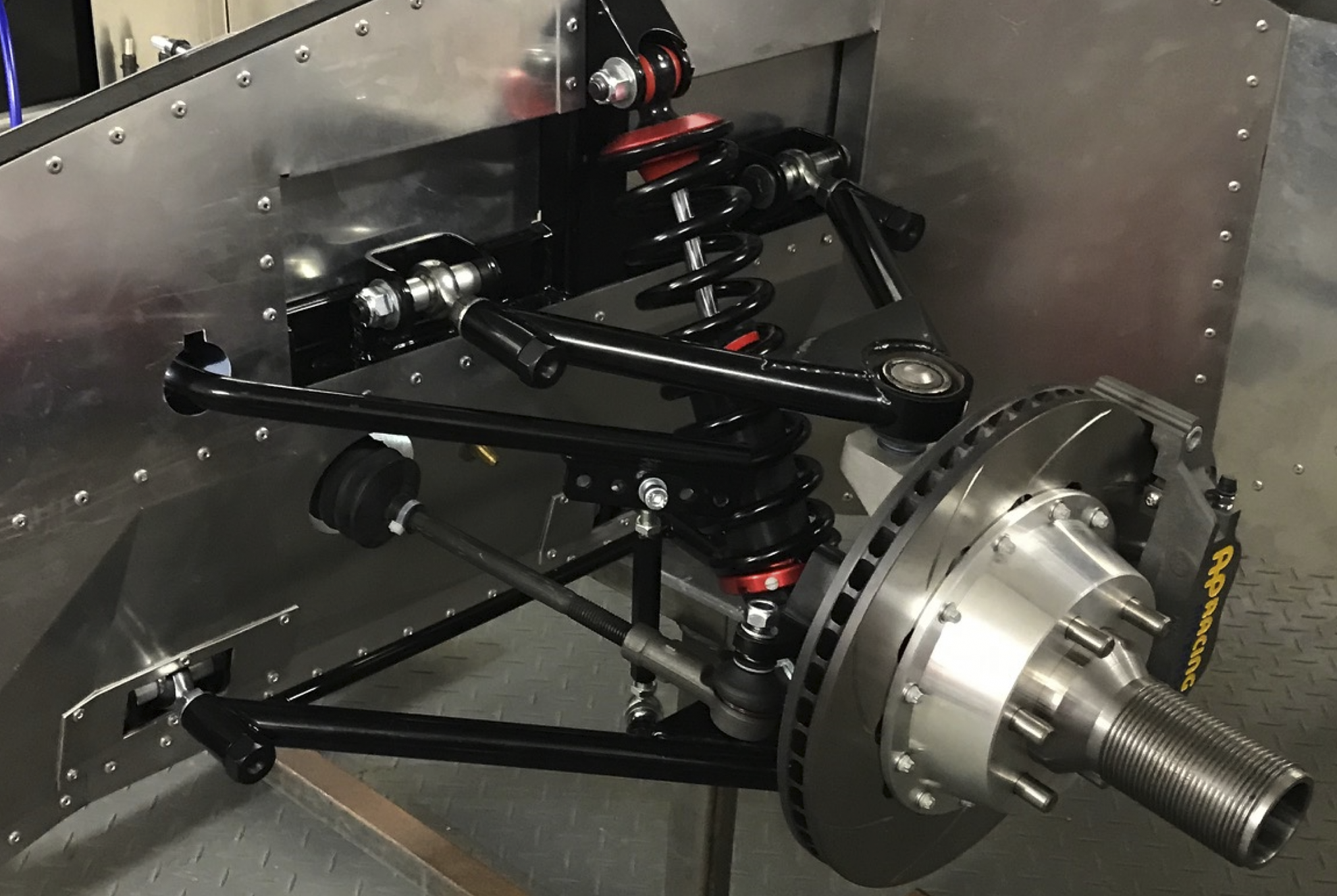

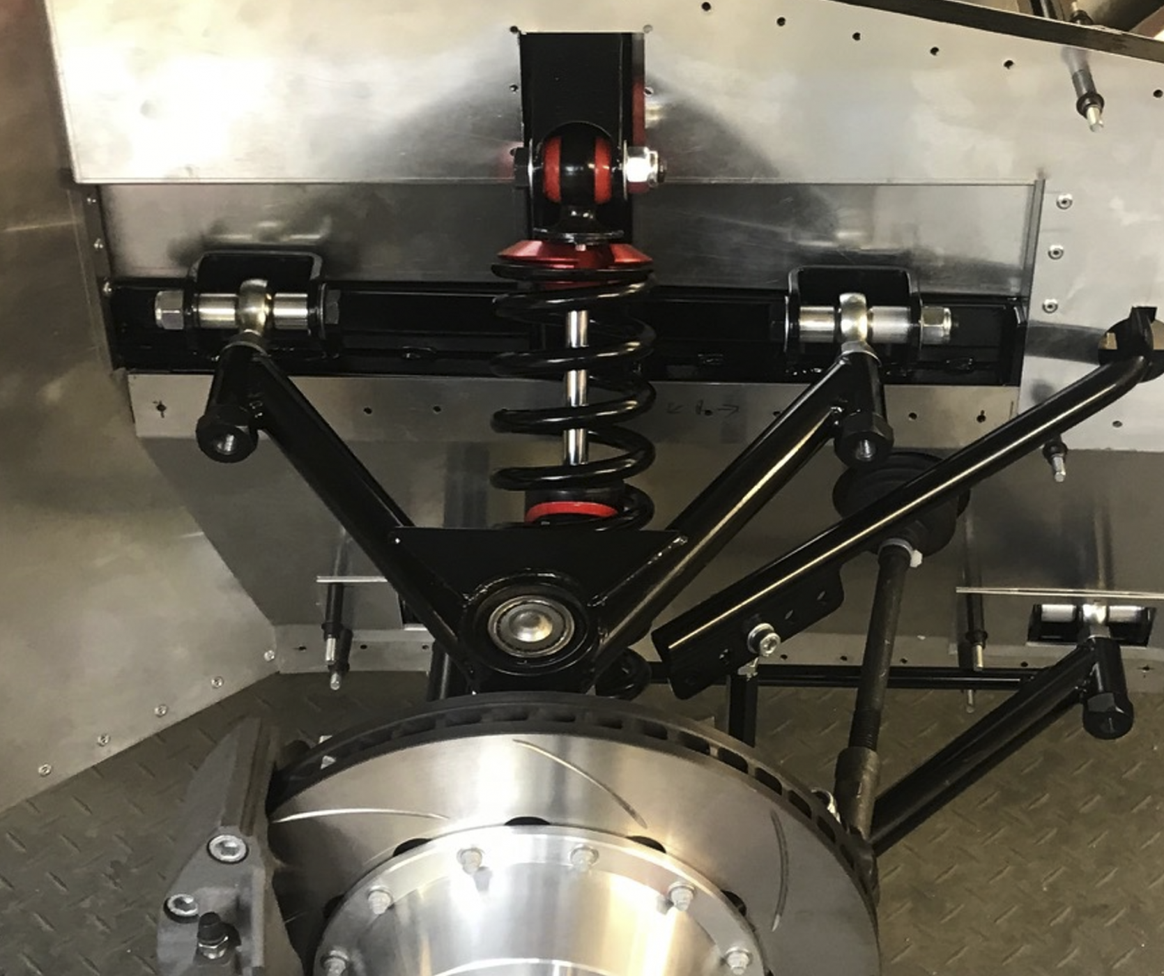

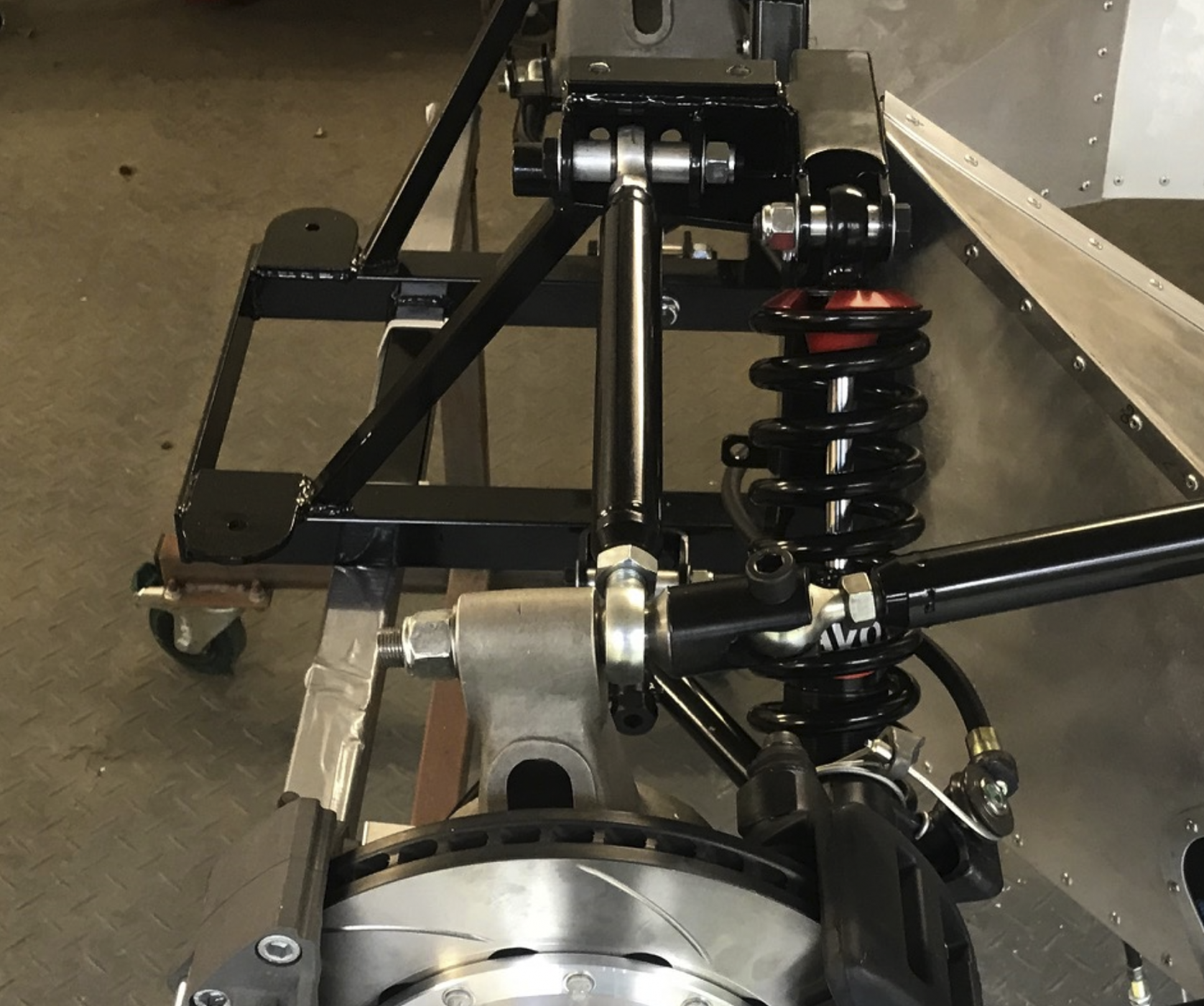

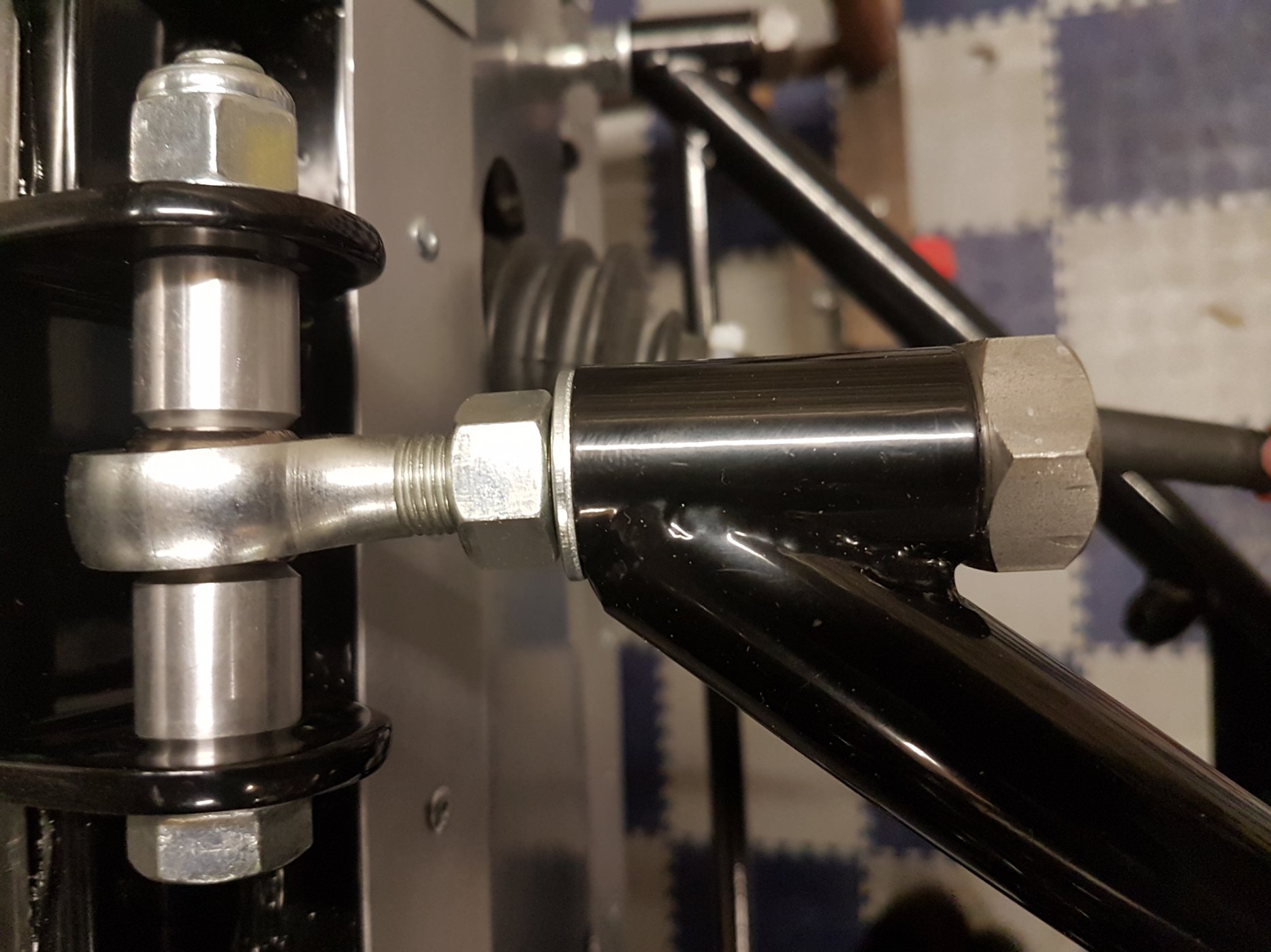

Hi, just put spacers in, one each side & center rosejoint, eventually put a washer in to fill the gap. Lots of photos on SGT web page. Good idea to download those photos.
Perhaps something like this.
look up Paulbav (Paul Baverstock) or Dan Winkworth SGT buildlogs on this forum. Lots of great info there. Same for Keith Baker SGT build
Hope this helps you:)

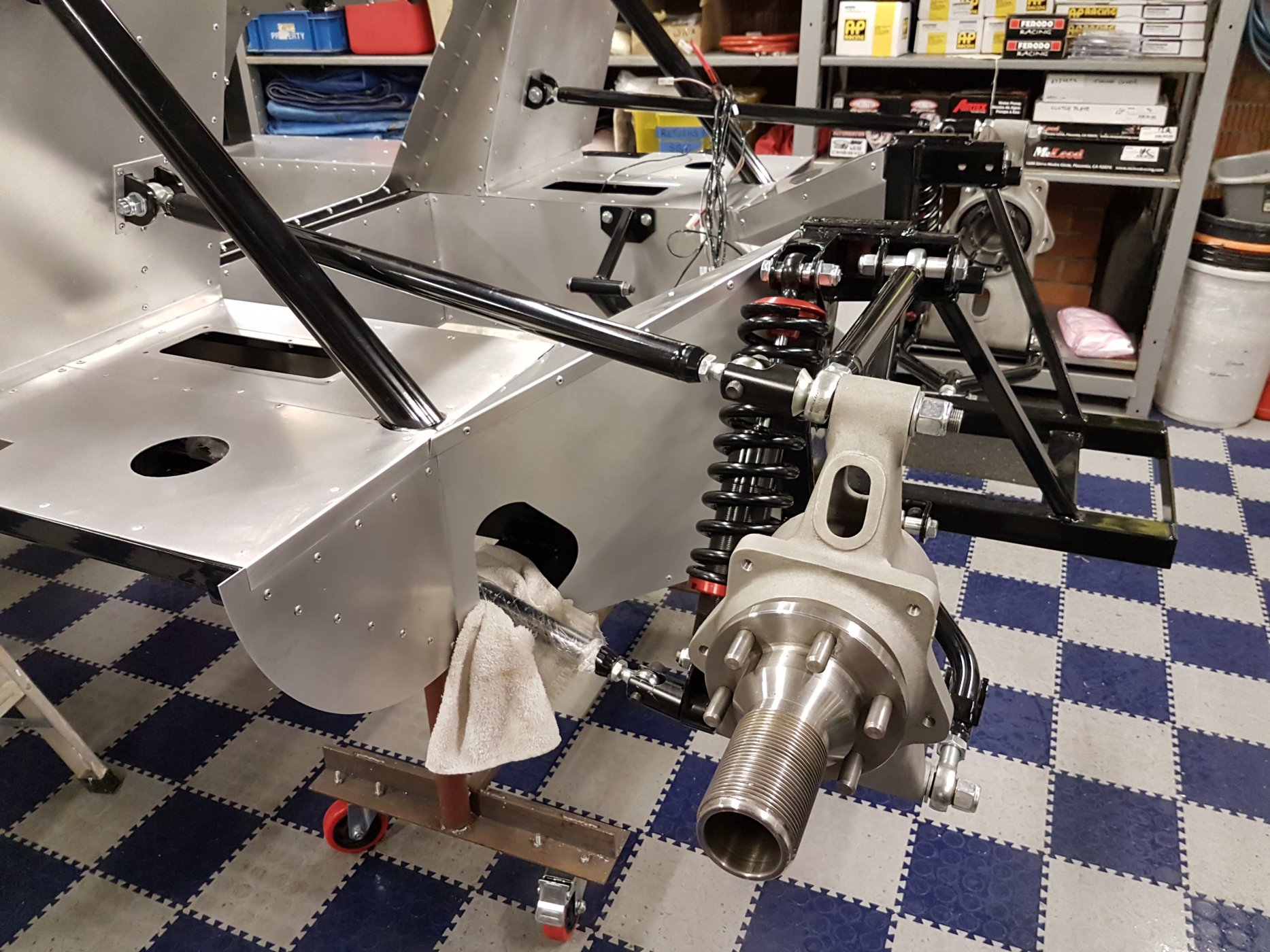

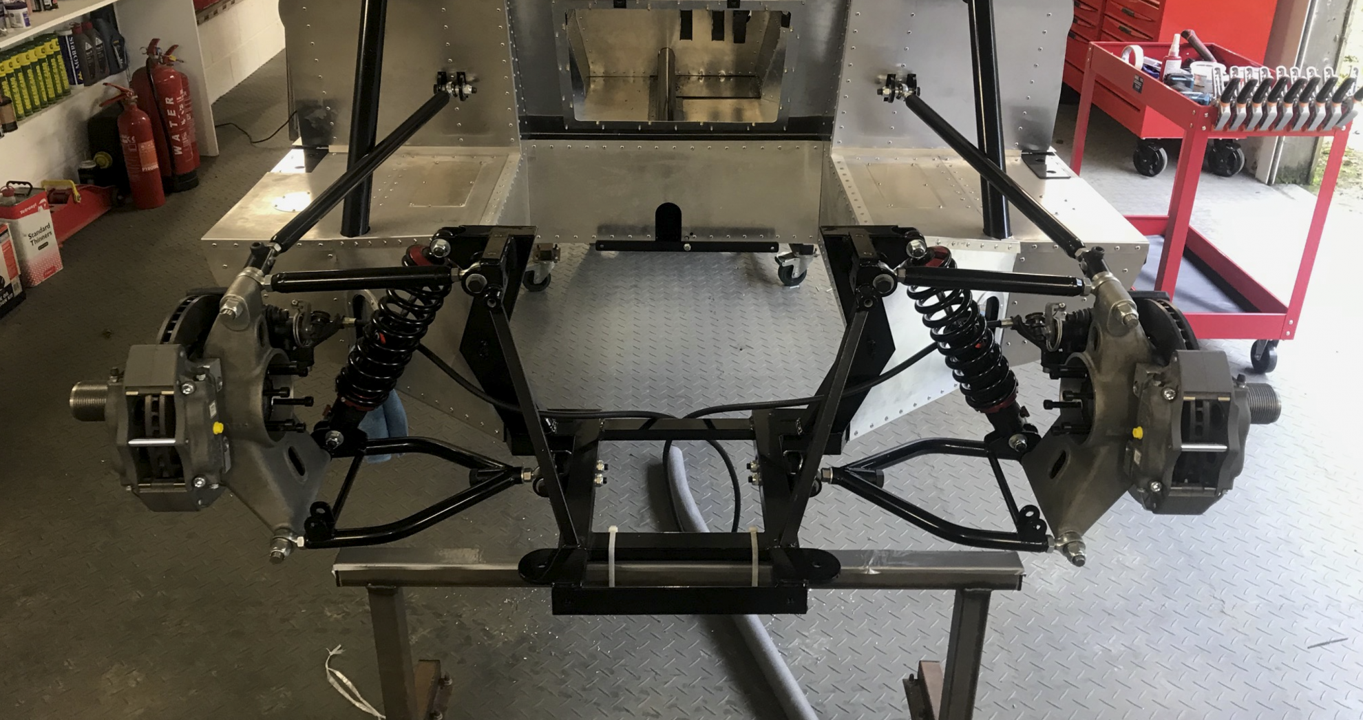

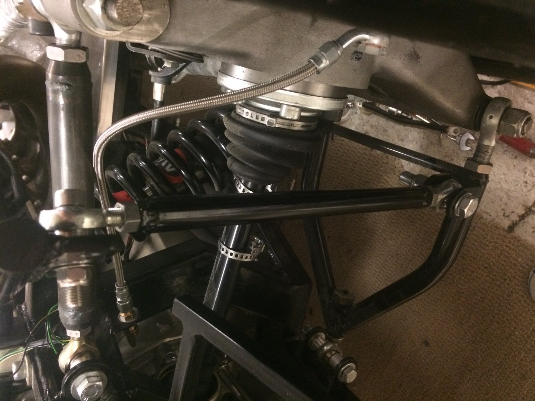

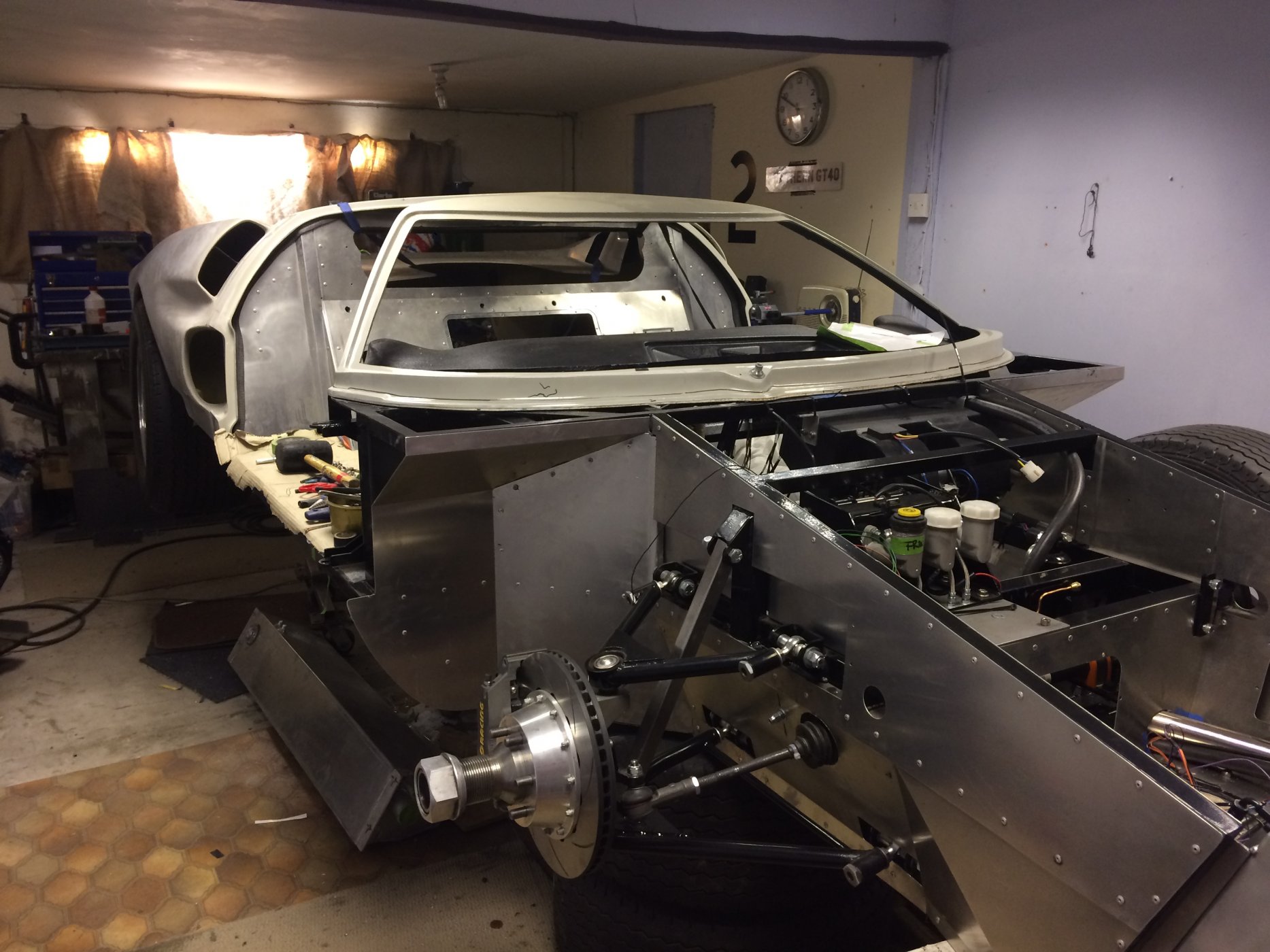

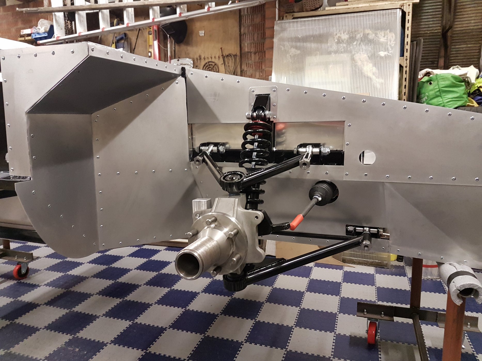

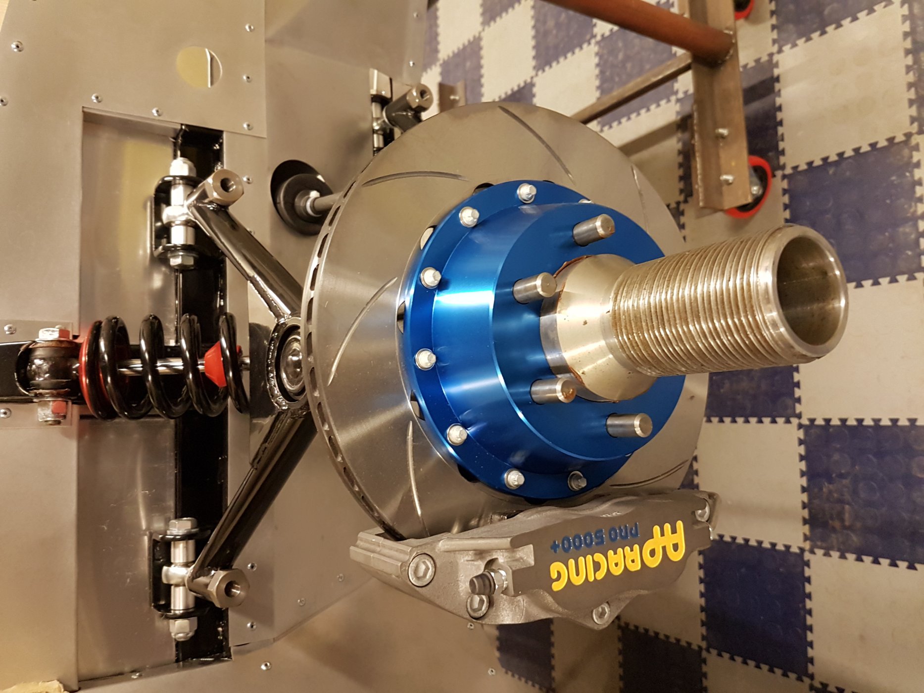

Here's another couple, and one of the rear. Hope they help.
