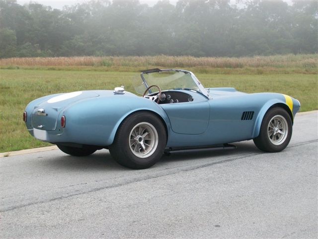

Yes, I meant the "Cobra" MK II FIA, our newest addition to the product line.
But we do make a GT40 MK II "R" car that is FIA accepted for many vintage events! Evryone should have one...................
