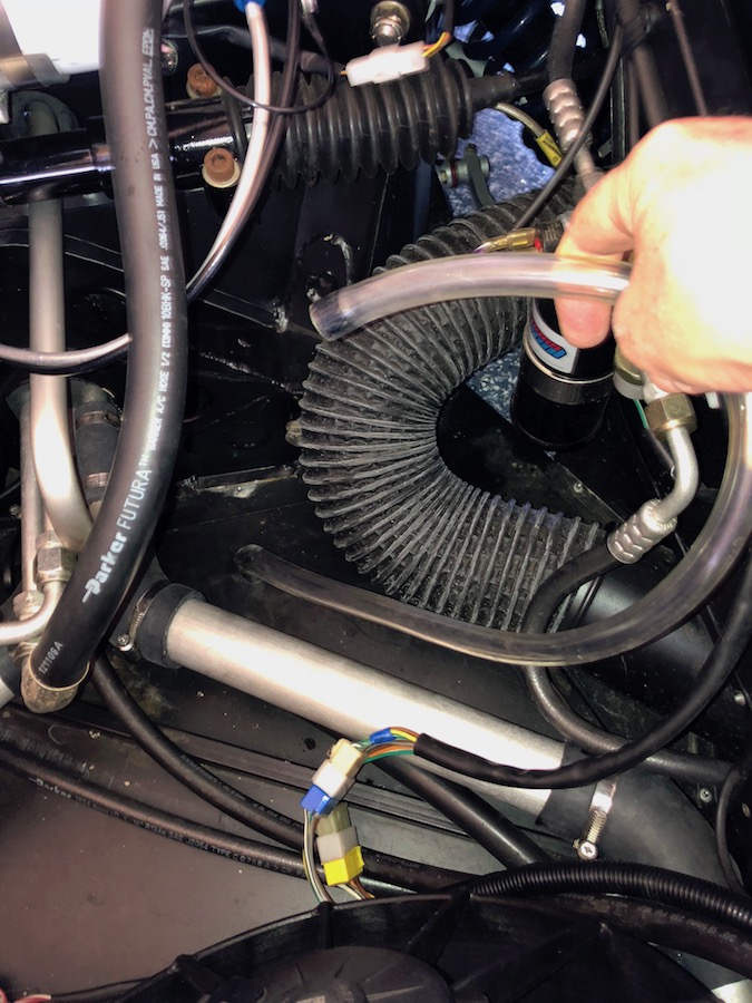

As of last week, I now own P2306 and have been going over the car. Everything is generally in order except this clear vinyl hose under the bonnet. It dumps to the road thru the front pan, but the other end has a broken black plastic hose fitting. I can't find where it would connect to. Have felt all around the A/C box above the steering rack. Any ideas? See photo:

The drain comes out of the LF corner of the evaporator box at the bottom (it looks like you have RHD?). It would be best to remove the nose and unfasten the box to repair it. Superglue worked for me or you could try threading in a smaller fitting where it broke off.

Dave, your advice was on the money :) I used some 2-part Loctite Superglue specifically for bonding plastic. It needs to set up overnight. I'll wiggle it tomorrow to see if it stuck. If not, I'll use a brass hose barb and thread it in ... Many thanks!
