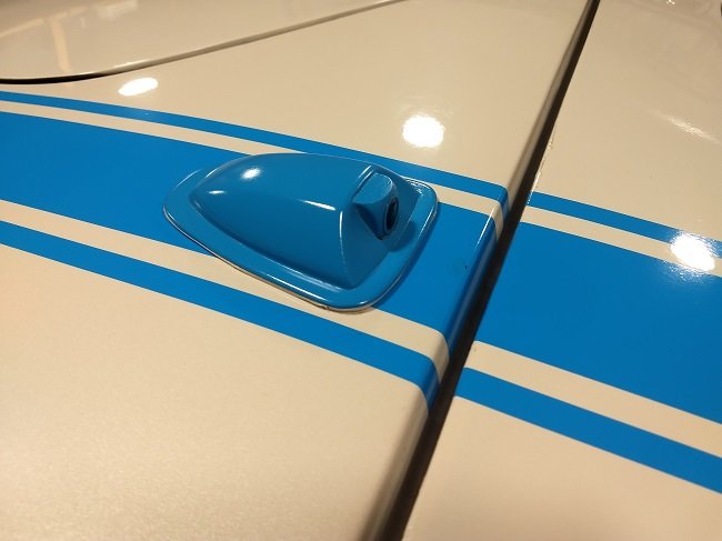

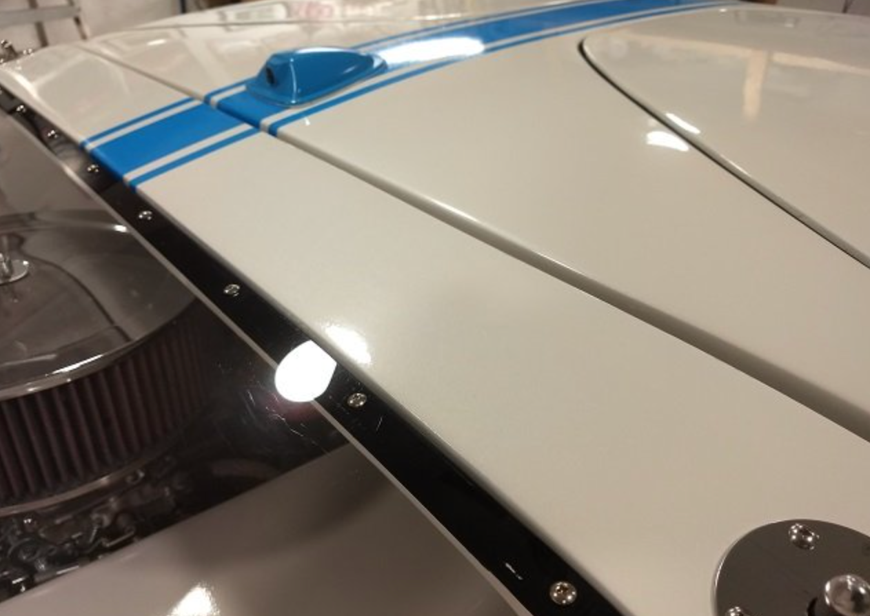

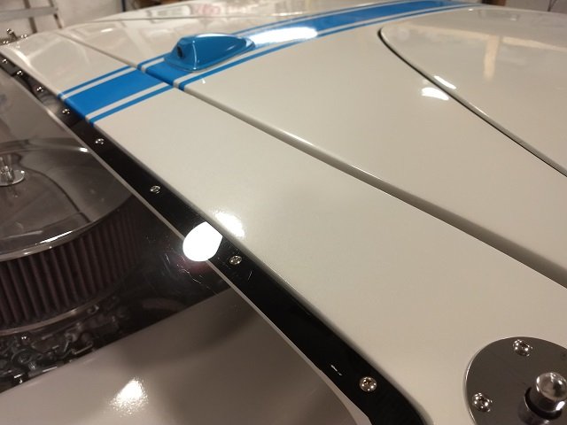

I have a Vantop H610 Mirror Camera in my car. I put the rear camera in a Nissan Satellite Radio Antenna Mount. This thing works great! And with the rear camera location on the spider, I have zero blind spots. Low profile and not as boxey looking as the SPF offering.

Rod, I think that’s by far the best solution I have seen to date. That will probably make the SPF GT40 Owners Manual if that’s ok with you. Please contact me and share some info and photos if you have any.

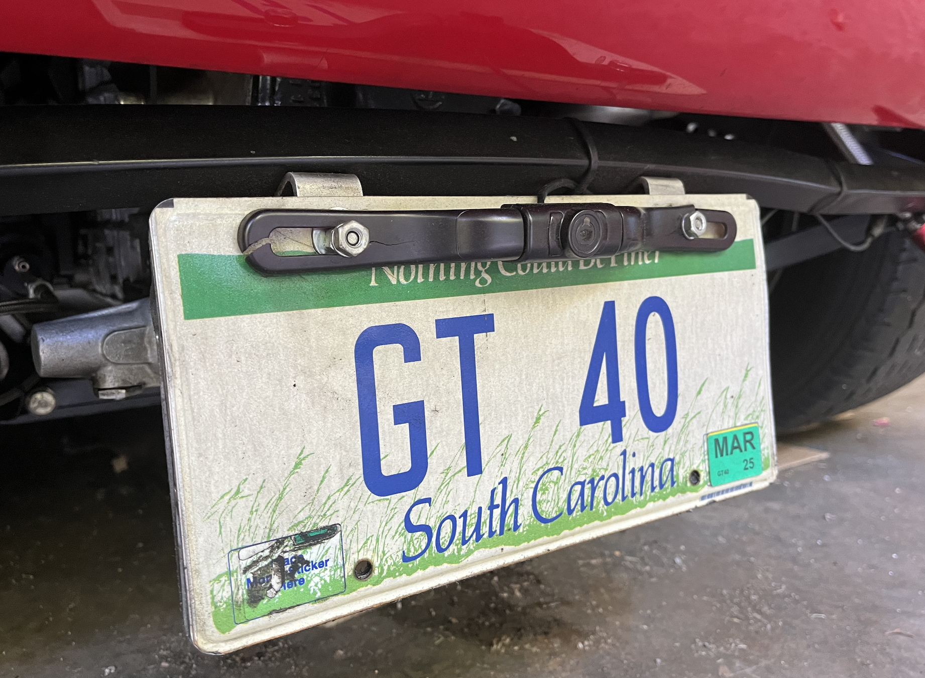

Another option that I installed about four years ago is a product called 4ucam. A rear view camera that I attached to the top of my license plate. it connects to an iPhone or Android phone via an app. I place my iPhone on the dash and can see anything behind me. In addition to showing the cars behind you as you're driving, it also shows guide lines for backing into a parking space which is otherwise very difficult for a GT40. And this system doesn't require you to change out the mirror supplied by SPF. The App you use is called SightWiFi. Total cost for the camera is about $100. The link below the photo below will take you to the 4ucam website.

Hi Rod, I am interested in this rear view roof mount, do you have any close up photos of how you mounted the camera inside the housing? What camera did you use for the roof housing? When I googled the "Nissan Satellite Radio Antenna Mount" I found housings that were close in shape to the one on top of the spider but not identical. If I'm not asking too much could you post a link for the housing in your photo and the camera inside? Thanks brother! Dave

Unfortunately, this is about the only thing in my build that I didn't take a bunch of pictures of while doing this. It was really easy though. I found the Satellite Antenna Mount (2008 Infinity G37 # 228208-CF40) on eBay. The Rear Camera is the one that came with the Vantop H610. I removed the Camera's attaching bracket and gutted the Antenna Mount down to just the Cover. I then marked & drilled a hole in the back for the Camera and used a Dremel on both the inside of the Cover & the Camera to make a good fit. I then made a mounting Bezel out of a scrap piece of fiberglass panel and epoxied everything together. Some matching paint & 3M double-sided tape acting as both a gasket and adhesive completed the project.

Excellent description, thank you! That's what I needed (other than my 40, of course! ) I also think that location is the best view as well! Dave.

Brian, I really like the look of that one! The only possible drawback that I see is the degree of side to side range looks a bit narrow with the camera mounted in that alcove? Not sure if it would be enough to eliminate the blind spots. Play with it some and keep us informed.

I built a Mustang Mach 1 a few years ago and it has the rear window louvers. I installed the Wolfbox rear view mirror with the camera on the license plate. It honestly works perfectly and you completely forget your looking at a screen image. It also has front view camera, so card to record, gps, etc. Very nice unit. The only problem/hiccup is running the wire from the mirror around the windshield to where ever you have the box mounted.
