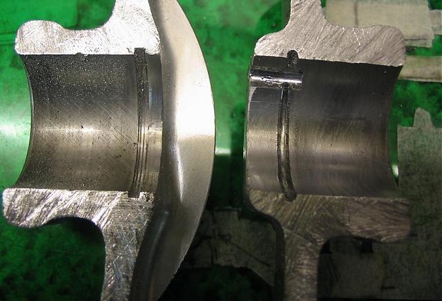

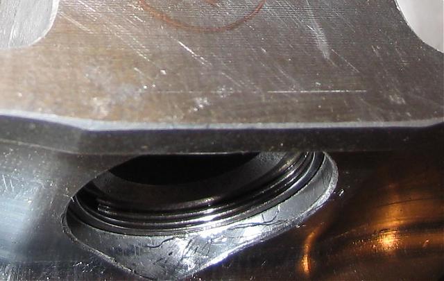

Sandy, be careful about this point. Usually, piston pin bore that are designed to fit spirolock are without notch (see picture). As you can see in the pin bore, these are several screw driver impacts :o . It is not easy to install but it is difficult to remove it! When you will remove one F@#$% you have to check if your piston pin groove is provided with a square section (for spirolock) or with a round section (for traditionnal pin clips). Check also your piston pin end that is provided with or without external chamfer (external chamfer is for traditional pin lock). It is not recommended to change the initial design.

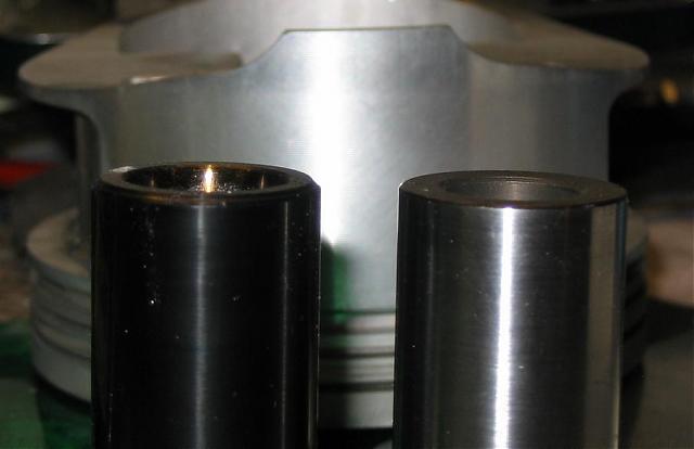

I'll take wire locks over spiro locks or TruArcs any day. Just be aware that the pins must have 45 degree X 0.040-in. chamfers at each end.
Pictures are better than my poor explanations. I have cutted 2 differents piston pin bore. You can see the square groove for spirolock and the rounded groove for wire lock (that is notched). Also 2 different piston pin. Wire lock must use chamfered pin ;)
