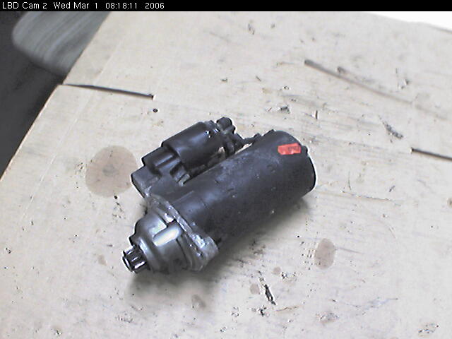

The toyota starter that kep is using is very rare in sweden, europe?. I am using a very common and used 2002 golf 1,9 diesel starter in my own projekt.Drawing:
