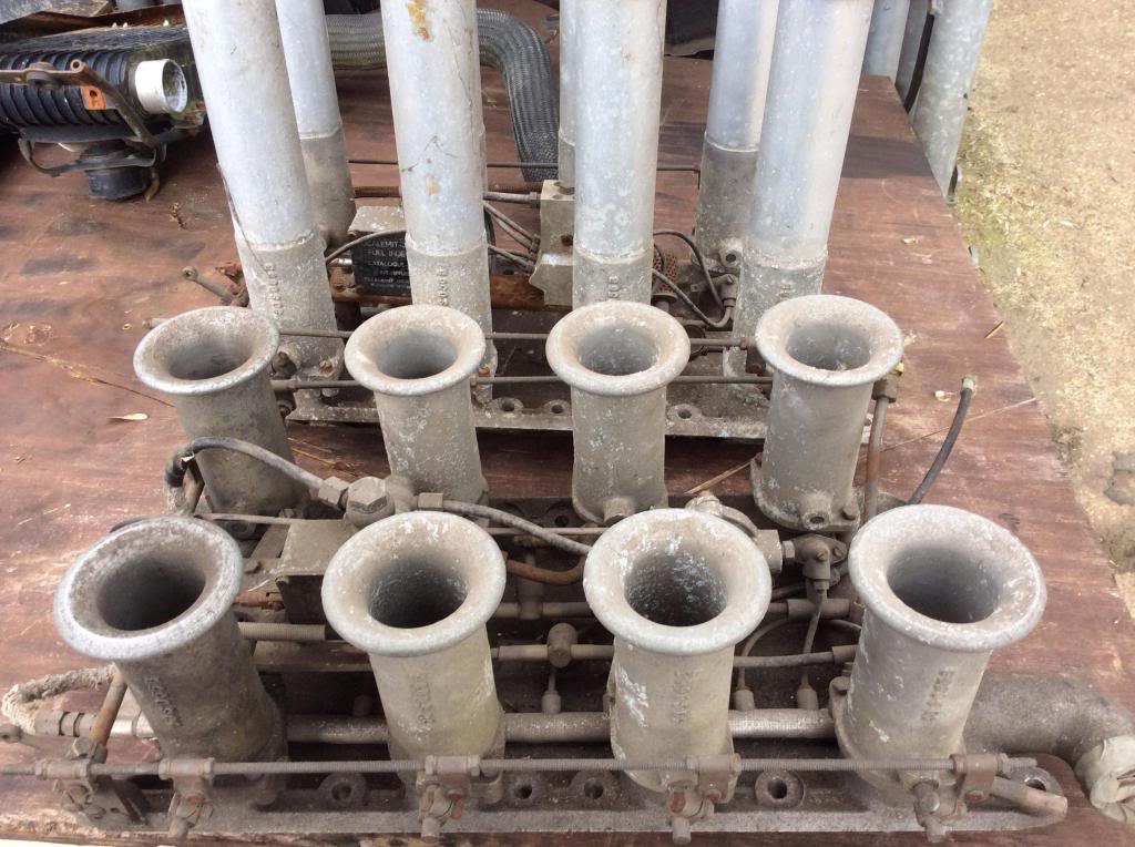

Hi all i have a lotus 30 with a 289 engine ZF DS 5/25 transaxle i have acquired s 2 off original equipment fuel injection i am missing a few parts one being the engine driven fuel pump i don't even know how it fits in a tight engine bay anyone have a picture of this system fitted to the gt40 pref from the front of the engine showing how the fuel pump mounts.

On further thinking about this it occurred to me that the pump could be mounted and driven in the same way as Lucas metering units fitted on mid-engined V8s; fitted on the rear of the intake valley and driven by belt off the rear of the cam. I've got a pic of this setup on a GW engined T70 somewhere, I'll see if I can find it.
Thanks for the reply on the 30 it is supposed to run of the water pump pulley i have found an ex employee of TJ he still has the test rig and all the flow charts so a good contact i am visiting him next week.
Tj made a lot of injection systems for dan gurney one ex employee i spoke to remembers him visiting the factory

Besides Hilborn, the Enderle Fuel Injection product line may also have what you need. I get most of my GT-40 fuel and oil parts from Good Vibrations Racing in CA. They may have what you need, and their prices are good...
Enderle Mechanical Fuel Pumps
