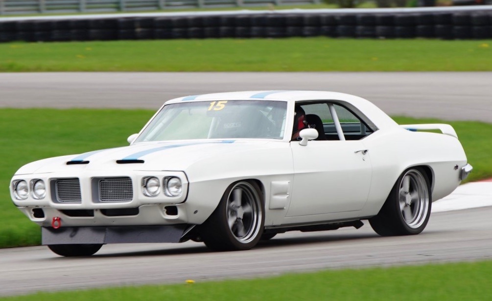

I’ve been researching brakes and think I have calipers picked out that will work with my C5 suspension on my AP build: Wilwood 6 pistons up front and 4 pistons in the rear with their Spec 37 rotors. I have a similar setup on my 69 Firebird street/track car that works very well at the track with a much heavier car that has 120 more horsepower. Wondering how the rear engine layout in the GT40 affects choosing the size of the calipers and rotors, with much of the car’s writ over the rear tires. Thoughts?

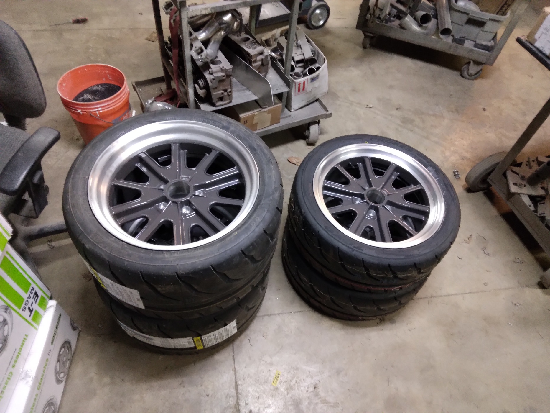

18” ET’s. I pulled the wheels the other night and layed a small level on the inside mounting pad and measured to the inside of the spokes. 15/16” on the rears and 1.25” on the front.
Howard Jones
Ok you have plenty of room for rotors. Here is what I have on my cars.

Thanks for the info! My ‘69 has 6 piston Aerolytes on the front and 4 piston Superlites on the rear….loaded with Wilwood track pads. That’s what Ron Sutton came up with…when he was still in good standing with the pro touring community.
