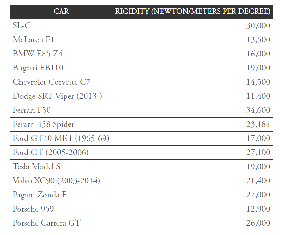

The SL-C's chassis is very stiff. The Superlite website provides the following table and you'll note that the only car with a stiffer chassis on the list is the Ferrari F50. However that number doesn't include the dropped seats which adds triangulation and is now a standard feature. More importantly that number doesn't include a cage so it's for the Le Mans (i.e. a convertible) not the SL-C. The standard 6-point cage will make things stiffer and Superlite can fabricate a FIA-compliant or whatever type of roll cage that you need. I don't think you can get that from FF.

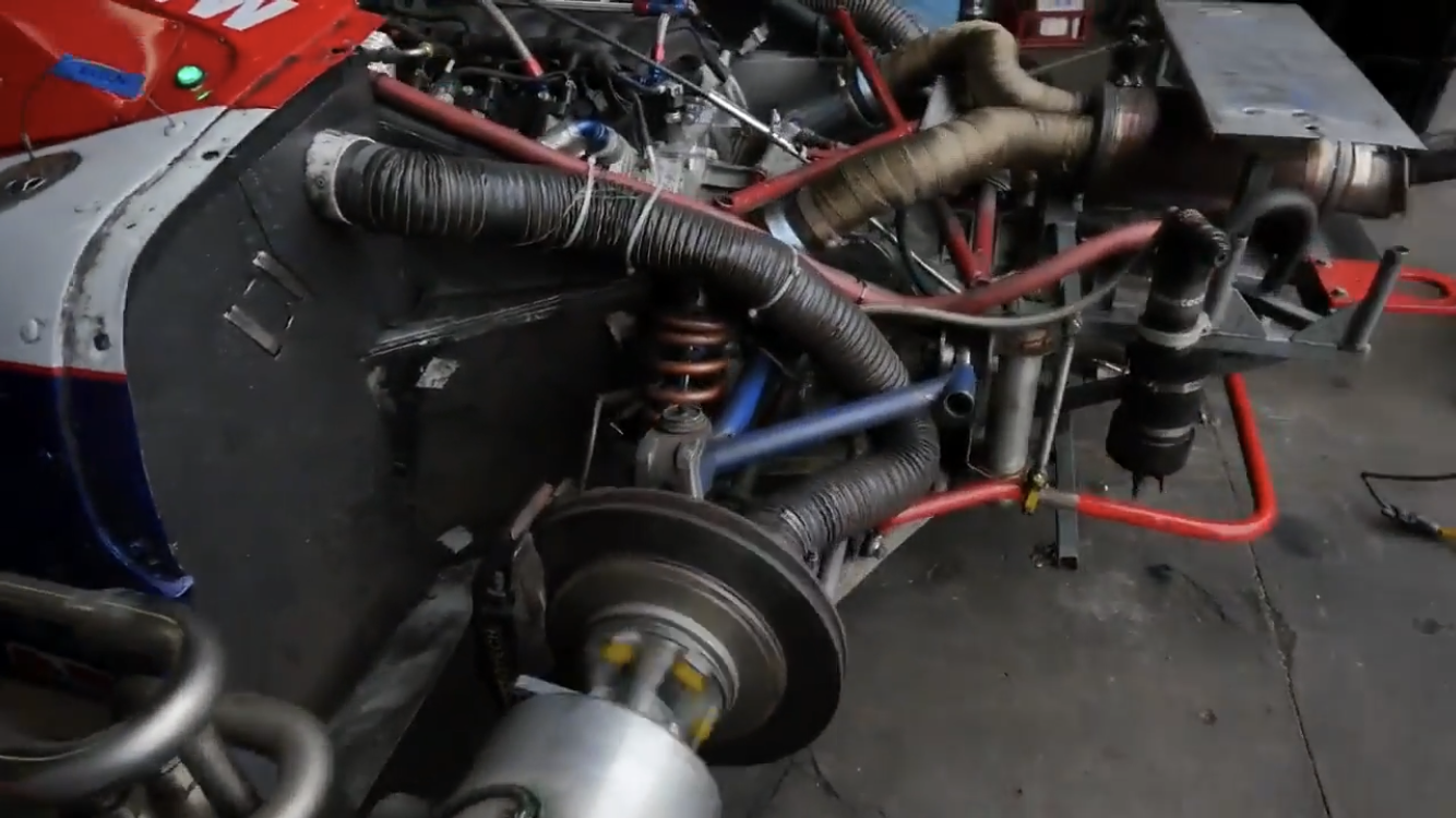

If you look at the video below you can see the flex points in the tube section in the rear. The roll cage hoop between the cockpit and the engine compartment connects to two tubes that extend back into the engine compartment which significantly stiffen things up in the rear.

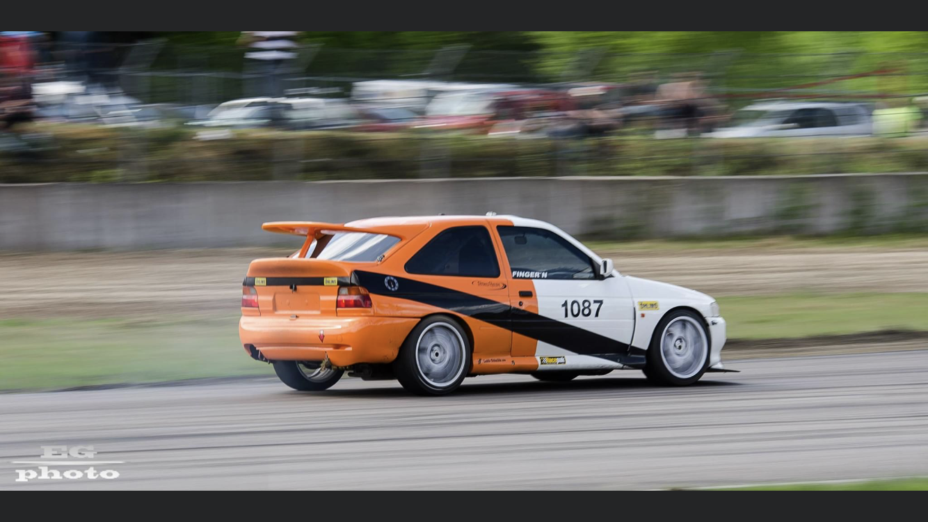

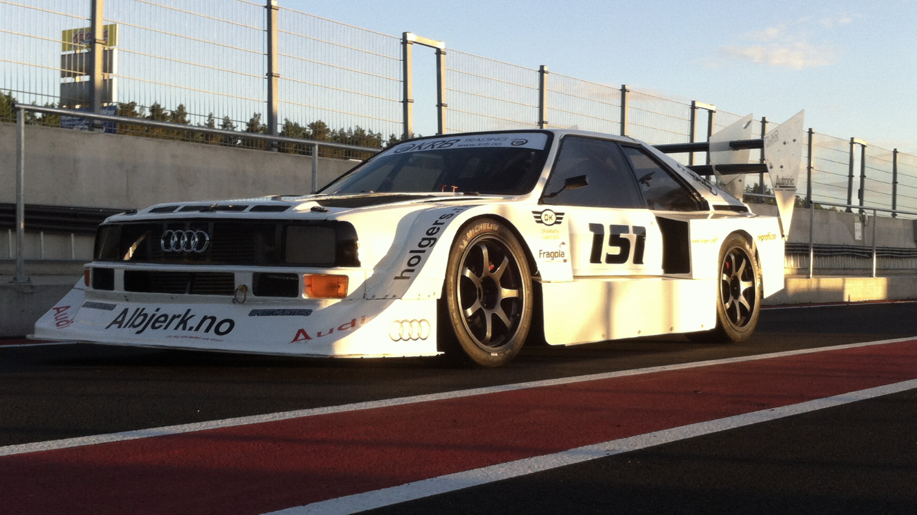

No mid engine car before. 4wd and turbo, and 800hp street car Bmw M3. The tube frame car’s ( Audi) problem seen with my eyes was flex in the frame. Also studying a lot of other cars that i can see this problem. That’s why this thread.
