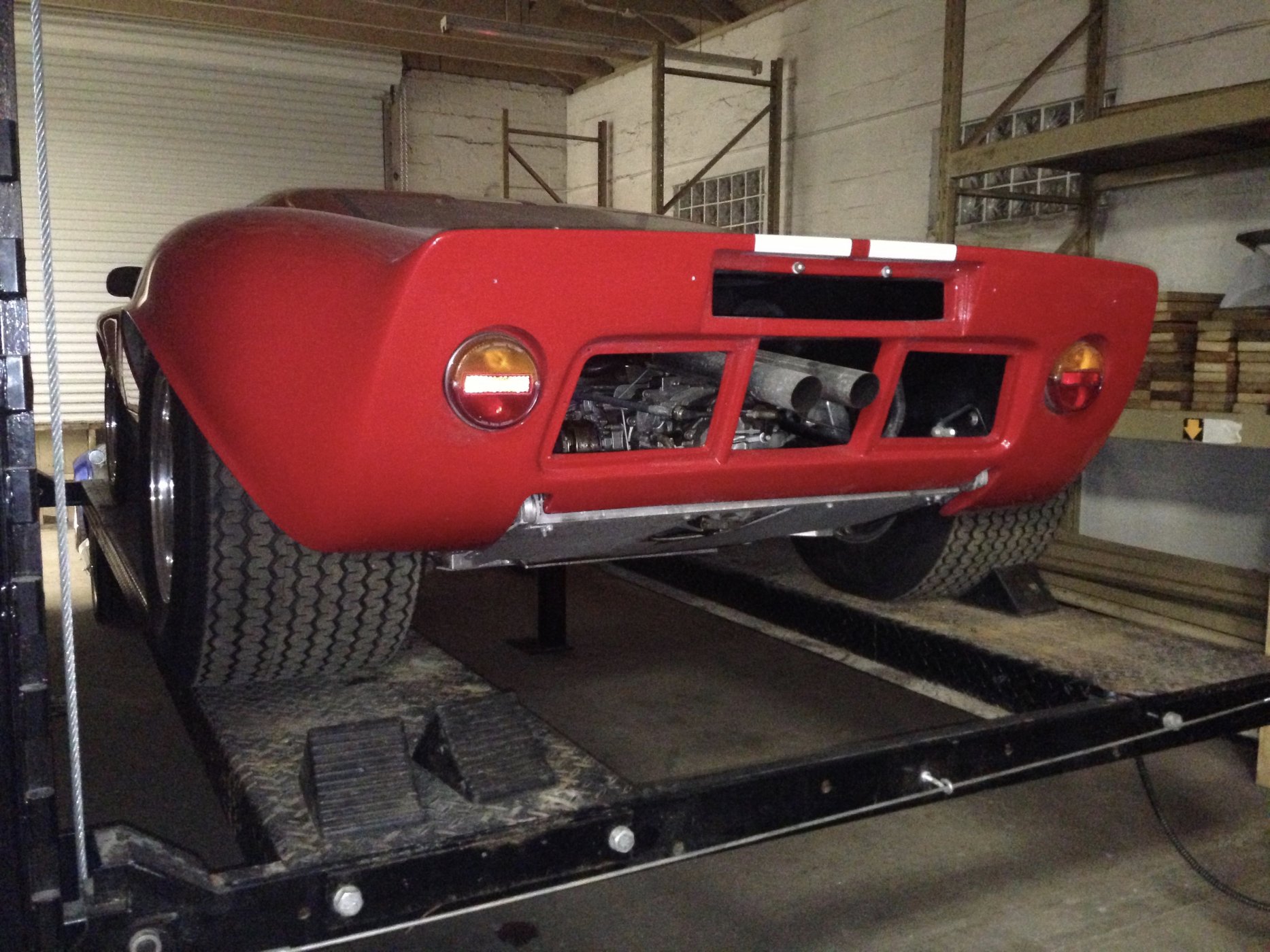

I would stay away from the MT Sportsmans for a road car. I bought a set when I first,"Gulfed" the rear clip for set-up and rim/tire sizing. They looked like AVONs, were out of round, and would have had to have been shaved. Even then I probably would have never gotten rid of all the vibration they caused. The M&H radials have driven well in all weather, and are stable/vibration free up above 150. Here is a pic with the Sportsmans on 15x14s......

Thanks Scott. Good heads up. After speaking with MT I had realised I wouldn’t get the profile I wanted but its good know about the roundness and vibration issues.
LOVE those tires!!
Yep, Those tyres look great on the Pantera and with the 15x14 wheels which are what I’m looking fro as well on my GT40 but coming up against issues with the wheel build and possible shaft breakages.....I am not quite at that point in my build yet but will Have to decide By end of the summer when my body will come and I have to decide on the super wide arches or just wide.......

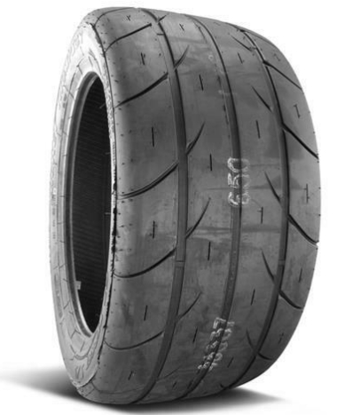

I have the same challenge; I have semi considered Mickey Thompson 29.00*18.00 ET Street S/S Radial for the rear only because they fit
They have many downsides: - they are very large diameter 29"/ 737mm and have an aspect ratio that is more akin to a tractor than a high performance road tire. Therefore, compared to Michelin Pilot or Pirelli PZero they'll make your GT40 corner like an elephant with greasy feet
There is really nothing else; the other Mickey Thompson offering the S/R Radial or Hoosier have some horrible offering are evidently worse ... unless of course you only drive in straight lines !
