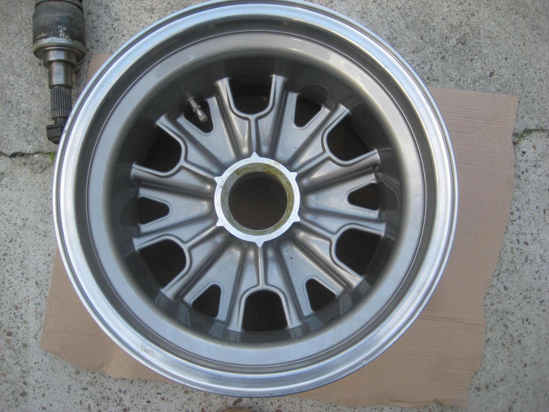

need help to identify my rims
Hi guys

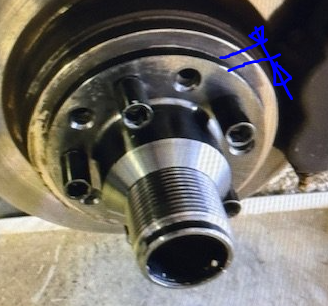

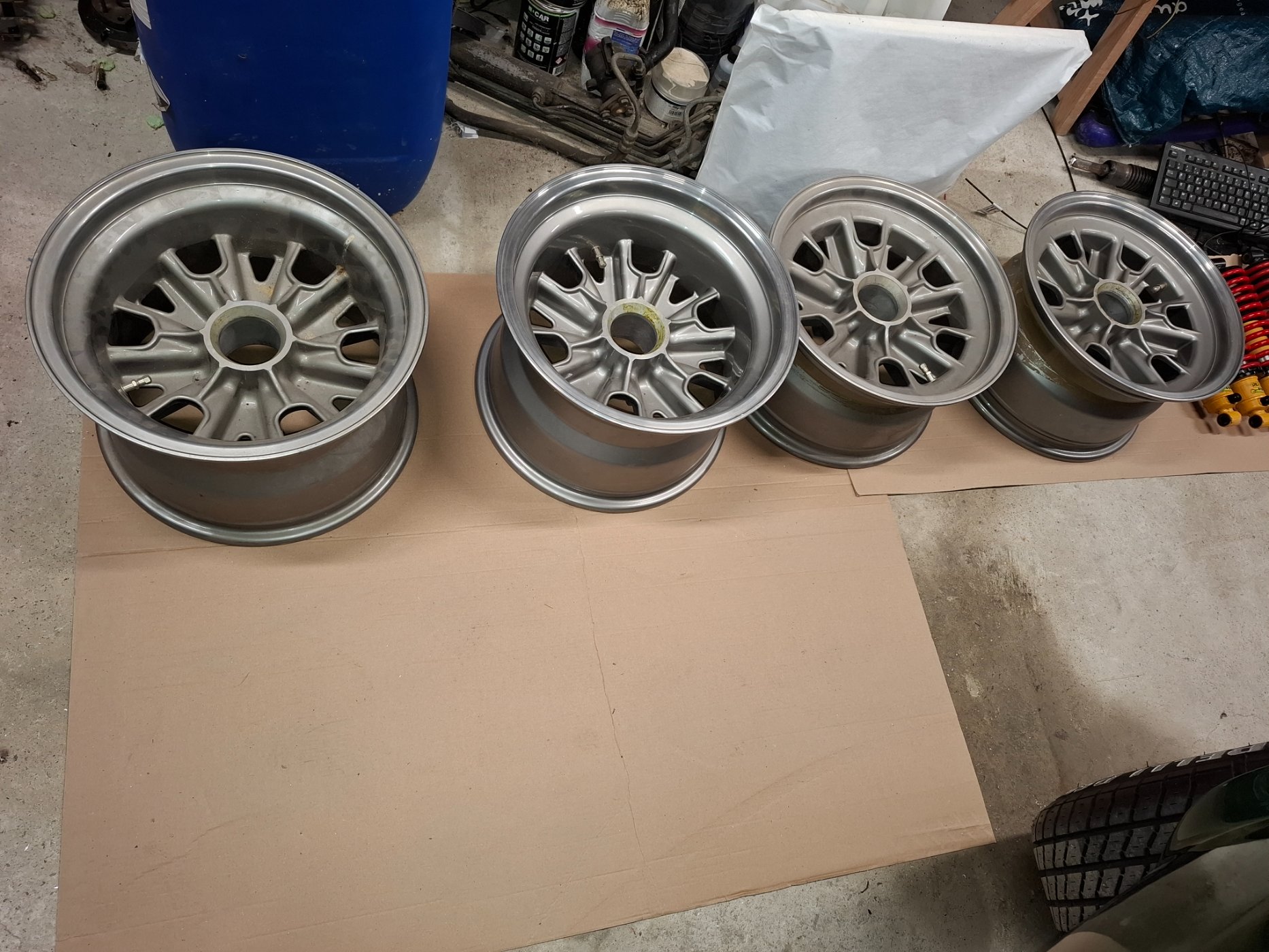

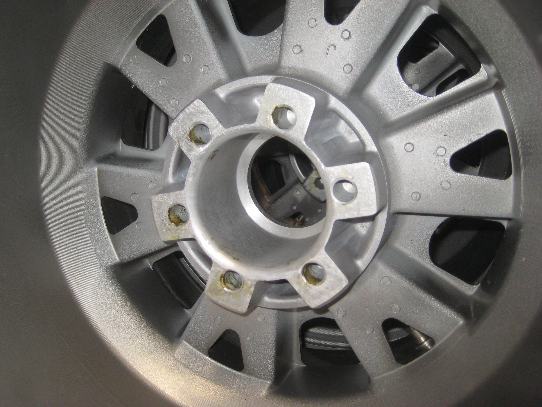

I've bought a nice set of 10" and 8" rims (15" Ø)
it's central nut fitting + 6 studs.
it's very difficult to catch the correct measurement with a reliable accuracy as it's deep in the rim. The caliper is fighting with the side wall...
is any body can help me to identify theses rims, and the details of the fitting?
approximatives values are:
- 6 studs Ø12.7mm (1/2") on an approx diameter of 108-109mm
- inside bore on disk side around Ø82mm
- inside bore on nut side around Ø72mm
Help !?!?

They look like SPF wineglass wheels. I believe Vintage Wheels sells the same wheel as their web page says "direct fit for SPF".
Thanks Lee, you're right !

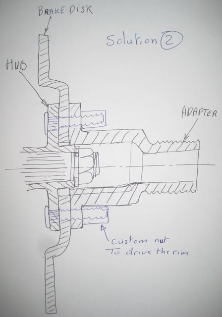

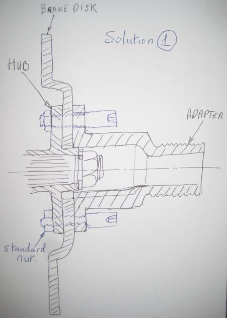

I'm a little confused about your studs. At least on SPF 1/2" pins (studs) are fastened with nuts on back side of hub. Where would the nuts for your studs be located?
Thanks Dave
I was thinking to fit custom nuts on the studs (solutions 2) but studs are M12 and holes in the rim Ø12.7...
But if I have fully understood, you're speaking about the solution 1; am I right?

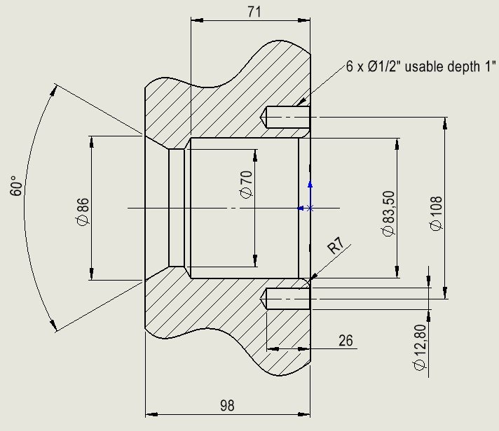

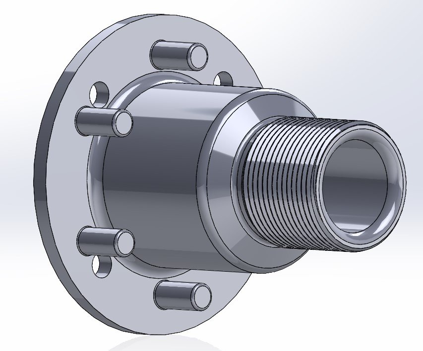

Hi, using the values founds on vintage wheels and the one I was able to catch on my rims, here is the result with a solidworks help:
do not hesitate if you see something strange !

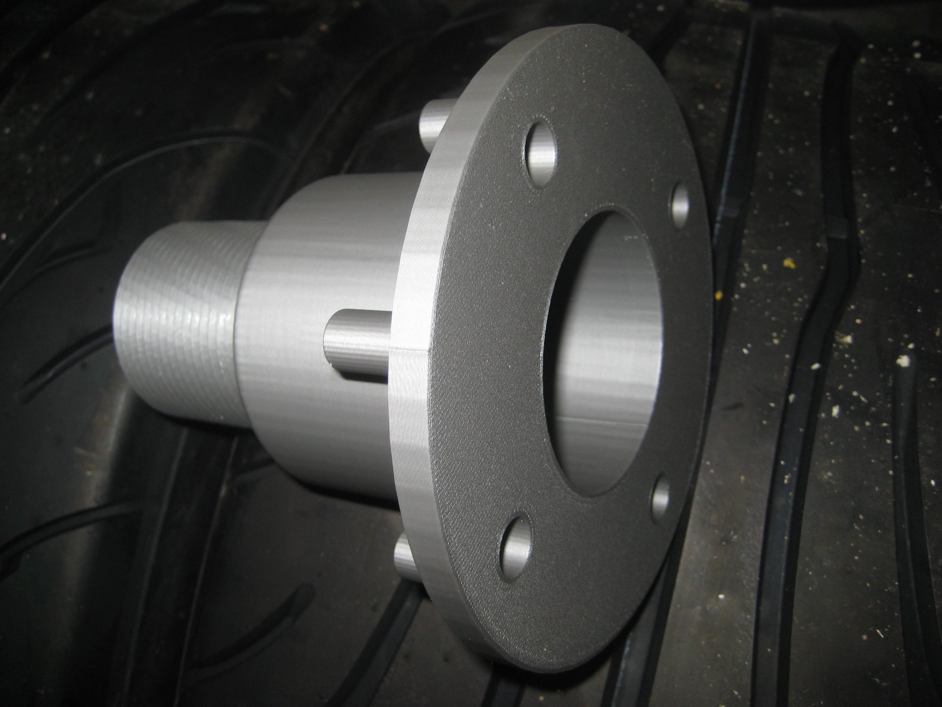

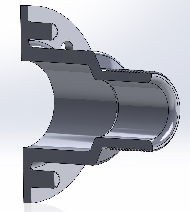

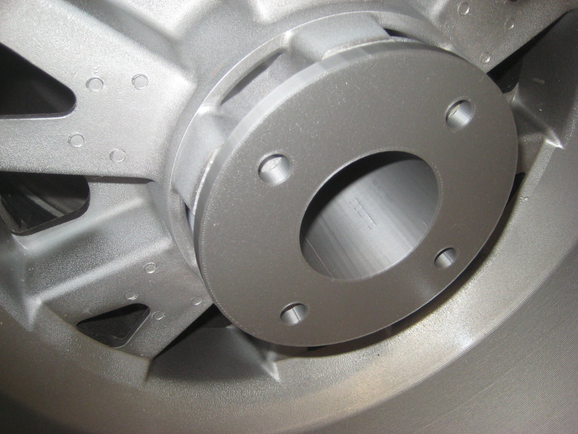

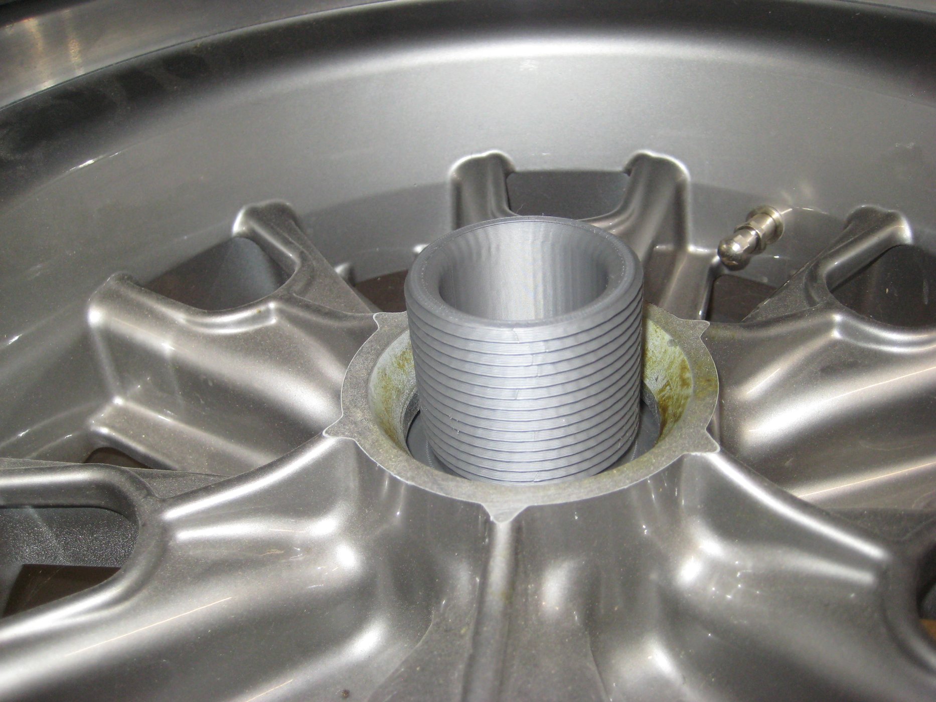

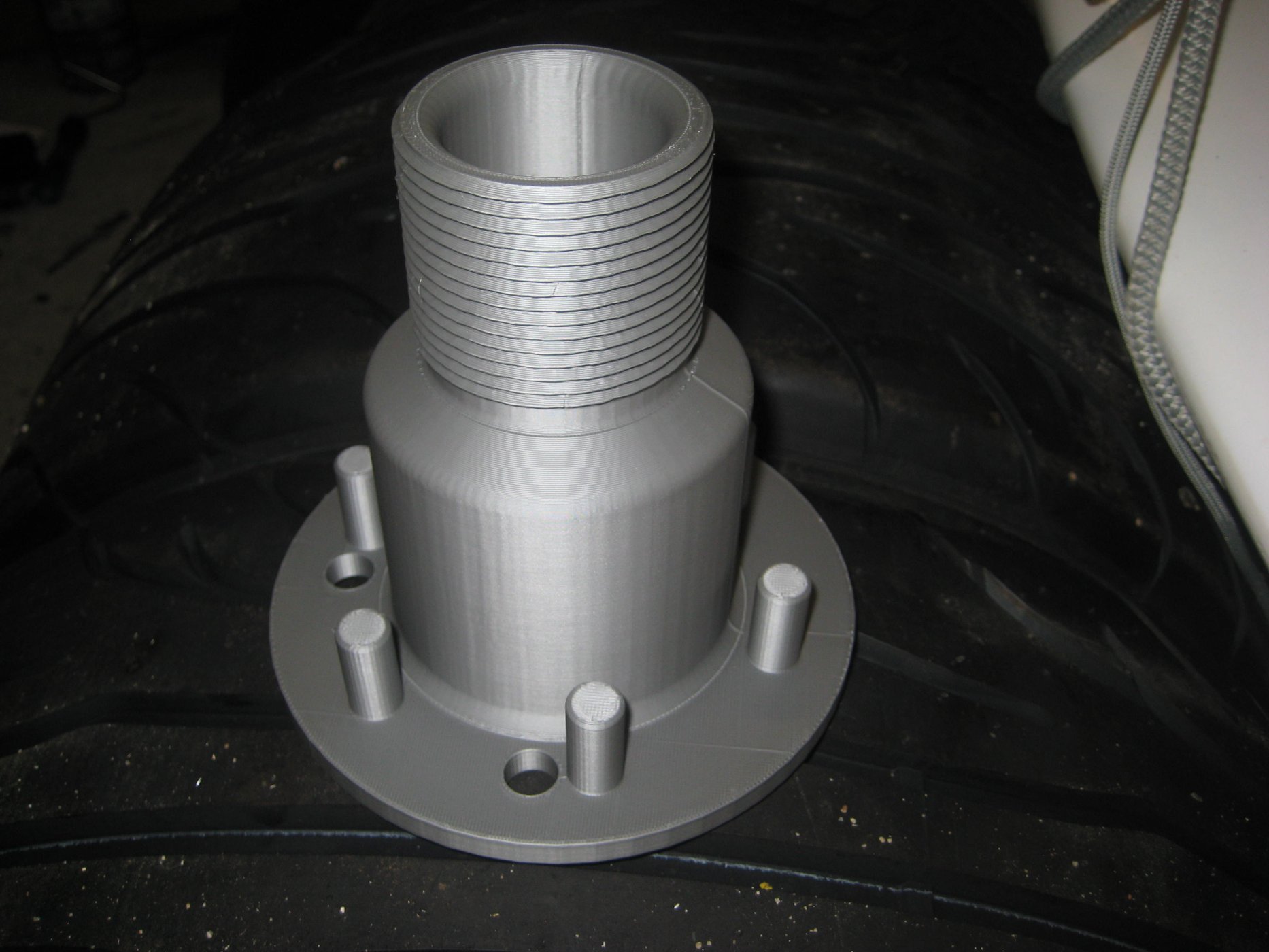

So I have design an adapter that I will 3D print with plastic to check if everything is correct or not:
