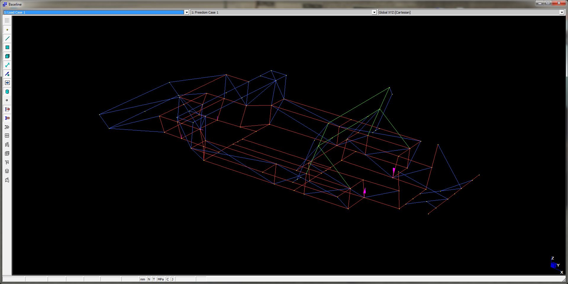

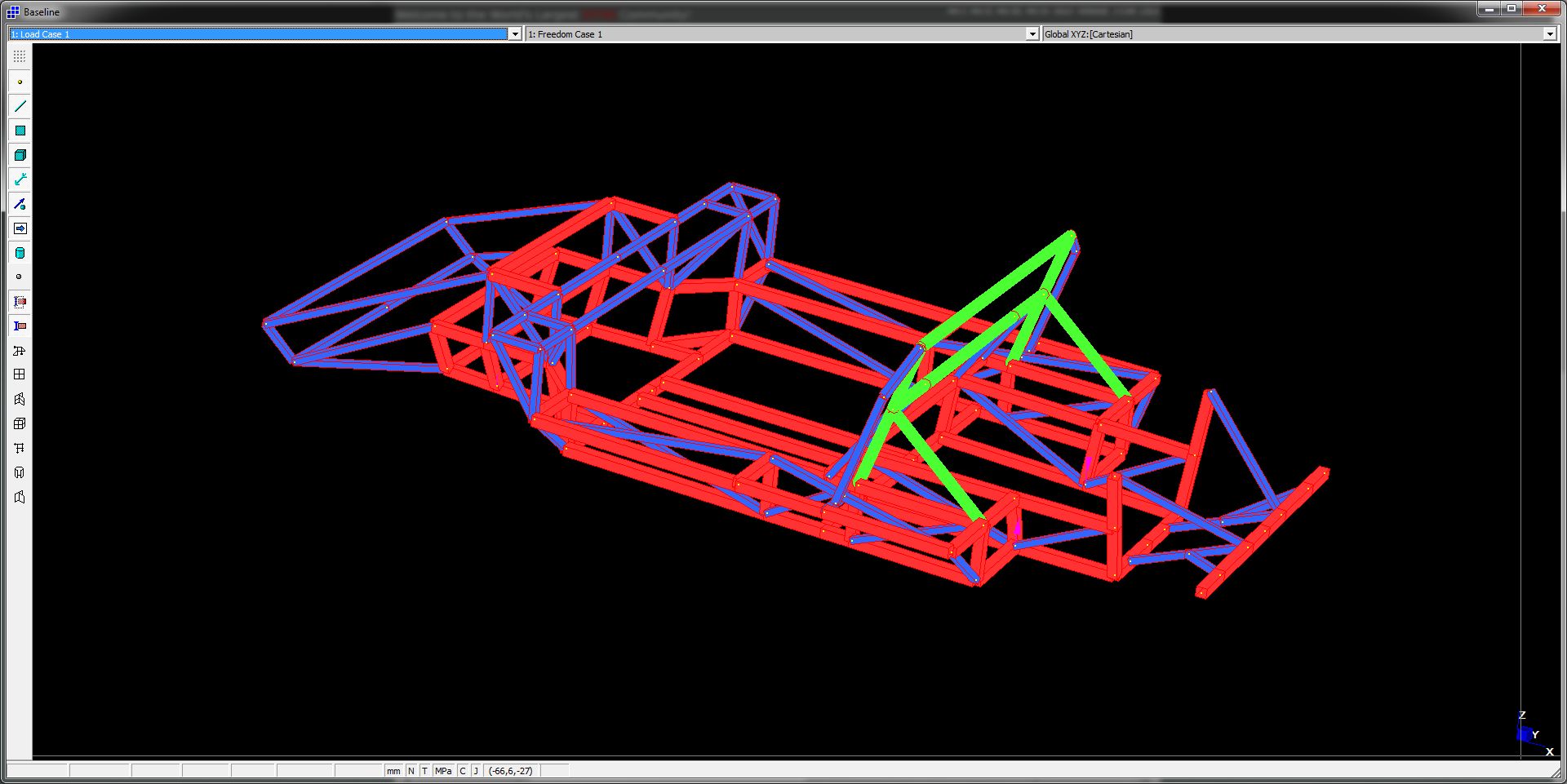

I am interested to know if anyone has done any work on chassis torsional stiffness.
A finite element model that I created indicates 1907Nm/deg (1406lbft/deg) for an unclad spaceframe.
I intend to progress the model with cladding. Riveted aluminium appears a standard practice.
I cannot really predict the added contribution of cladding; but 1907Nm/deg (1406lbft/deg) is a very low torsional stiffness.
RHS used in the model : 38*38*2 (1.5"*1.5"*0.080") (Red) and 25*25*2 (1"*1"*0.080") (Blue).

Mark,
does FEA indicate where the flexion is happening? Might be that a significant chunk of it is happening in a relatively small area, which would be the focus of any efforts to stiffen the chassis.

Mark,
yes Tom, it can indicate which individual tubes are flexing a lot in which case you could increase tube size or add extra braces.
It can also indicate where tubes are lightly loaded. Indicating that the tube could be optimised to make it smaller or re orientate it to perform better.

So, back to Mark's original post, if you can't adequately model the panelling, add in triangulation in the areas that will be panelled (simulating a sheer panel for load purposes). See where you are then.
