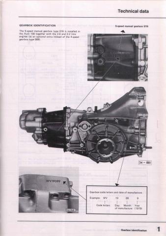

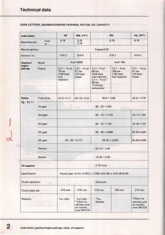

you can use many Gearboxes ... 016, 01X, 01E, 0A2 ... all the same pattern
http://img411.imageshack.us/i/audi100gboxmanual007.jpg/http://img411.imageshack.us/i/audi100gboxmanual007.jpg
http://img651.imageshack.us/i/audi100gboxmanual008.jpg/http://img411.imageshack.us/i/audi100gboxmanual008.jpg
