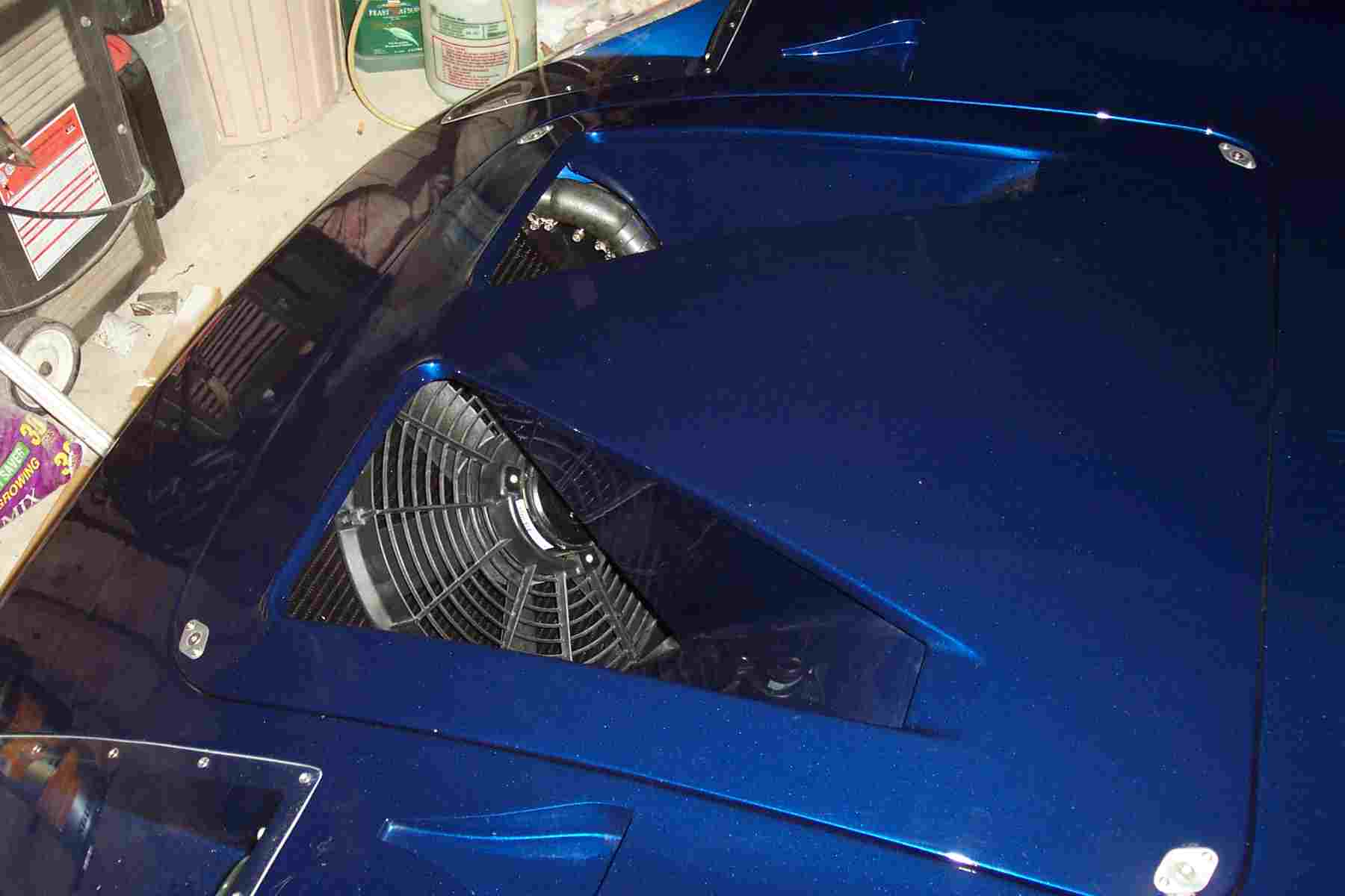

DRB (Gt40 Australia) make a really nice "deep nostril" option - it is supplied as 2 nostril intakes, a centre joining piece, & a full top panel piece. I am sure that Peter Ransom would be happy to supply all the underneath bits so that you can graft them under your top panel. They are all supplied oversize & fairly flexible, so cutting down & joining is mostly all that is needed.
From anything more than 5ft away, it looks just like a normal twin-nostril setup, but takes air up from the whole of the radiator rear surface area. Mine has worked really well - after hours under load on the dyno, it just sits at 95degC !

Hopefully, a pic of the GT40 Australia "Deep Nostil" setup follows :
