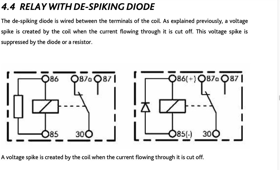

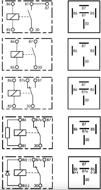

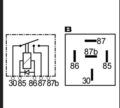

Paul Hendrickx
I have an existing 20A Bosch micro relay that originally fed a set of low draw (7A) electric horns. I wish to continue to use that relay of which pin 86 grounds through the horn button on my steering wheel to power a second 30A conventional 5 pin relay to power an air compressor for a set of FIAMM Air Horns. The micro relay when connected to the second 30A relay work and I can hear that relay opening and closing. But when I put the compressor load on the 30A relay, it just blows the inline fuse I have. The compressor is being fed off Pin 87 of which Pin 30 is directly from my car battery with a 25A fuse in line. Logic says this works but it don't. The compressor when jumped across my battery works just fine and spins away and does not blow even a 30A fuse. I even went so far as to ground the compressor directly to the battery as well.
Is there something I am missing about using a relay to power a second relay that makes this not work?
thanks
Hope this will help
greetings
Paul
