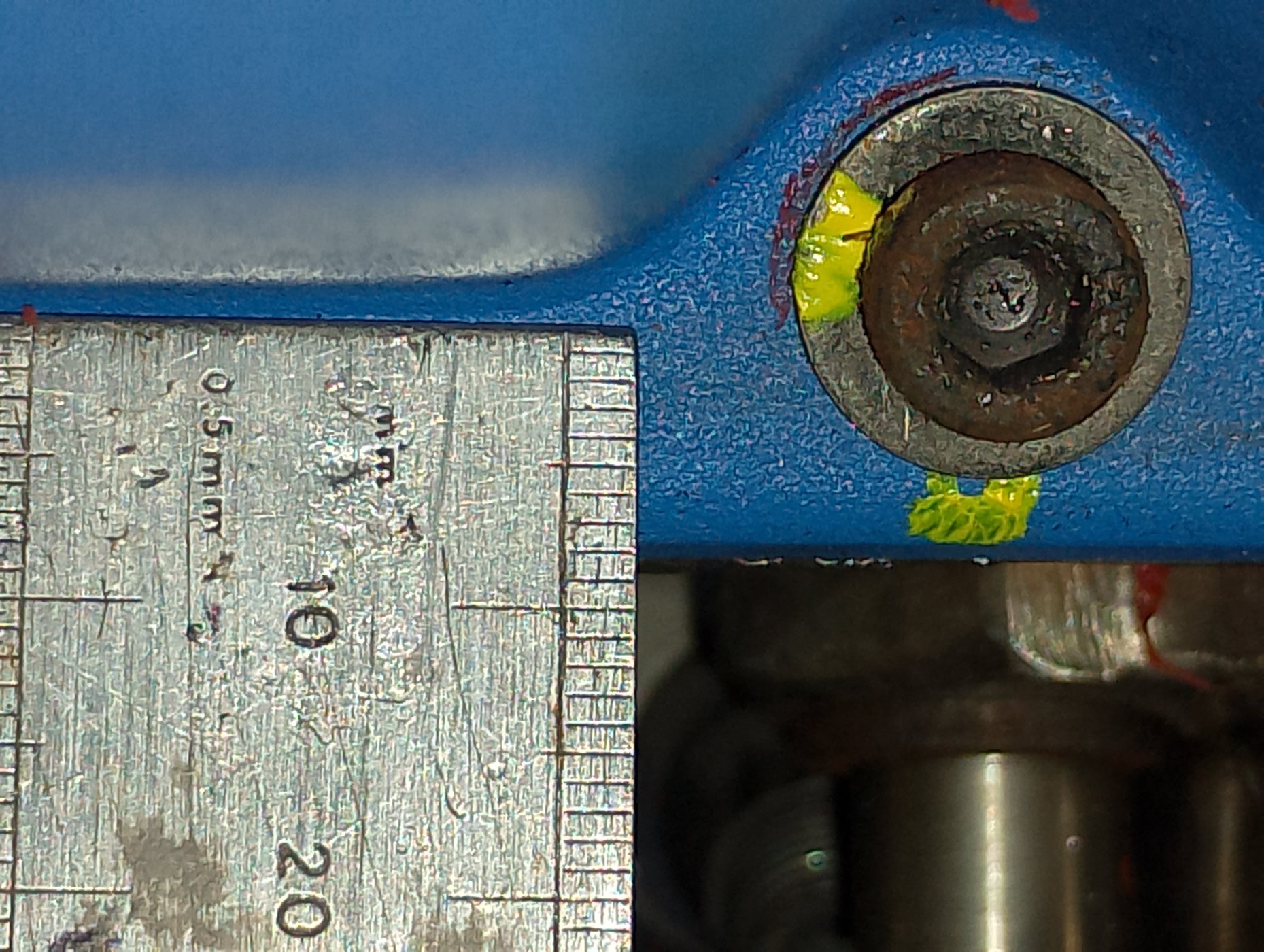

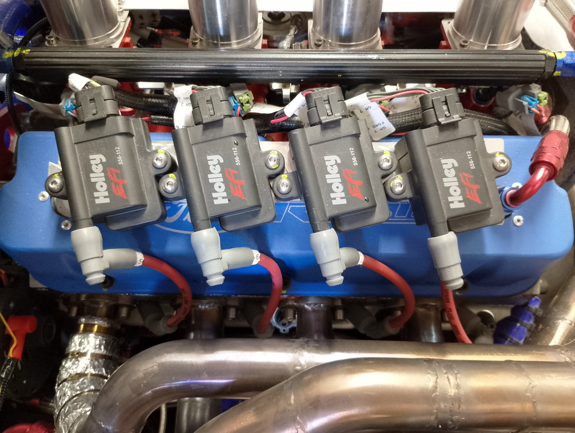

im using cast covers.
I have attached a couple pictures that may be of use.
Jerry
