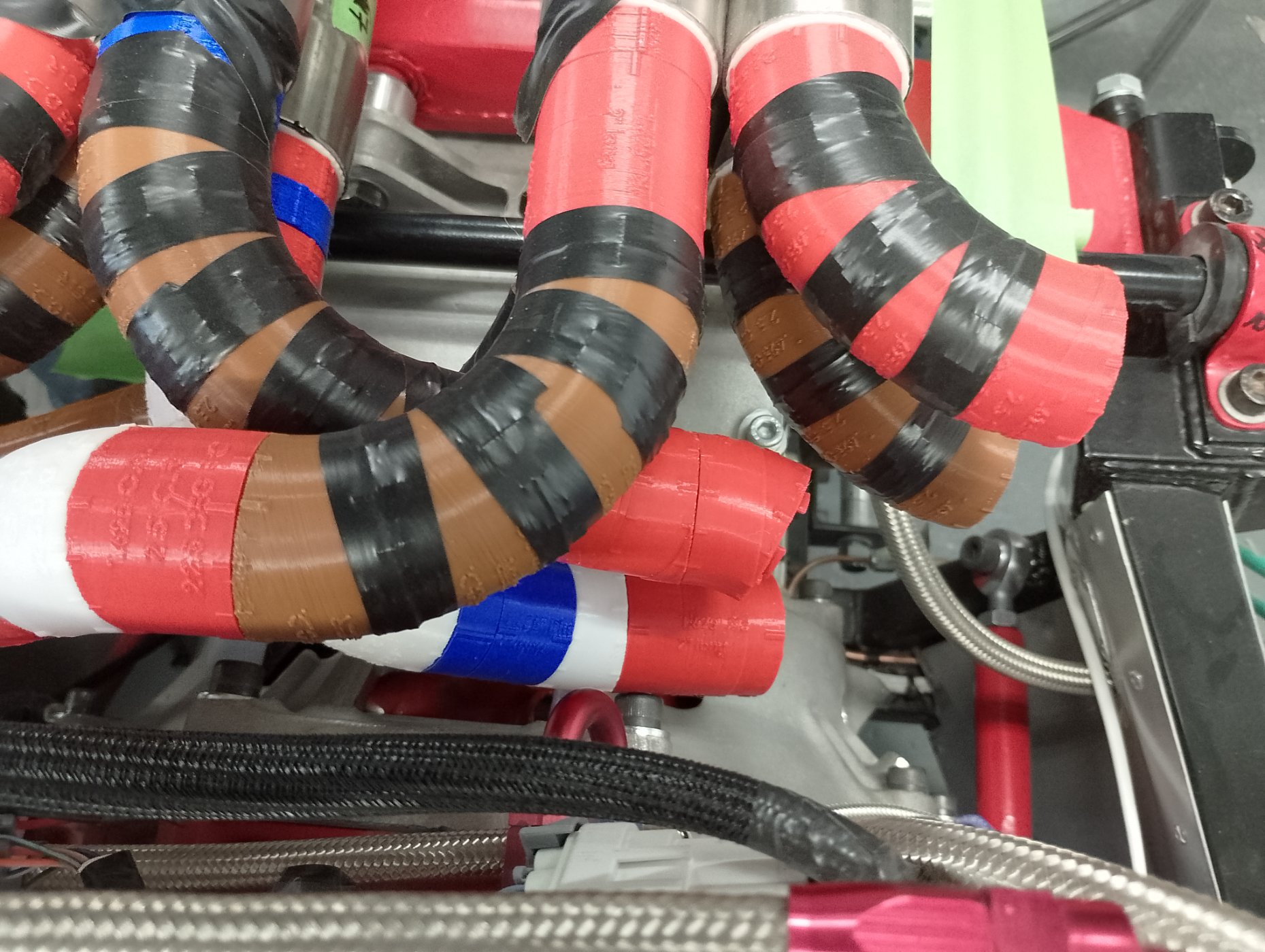

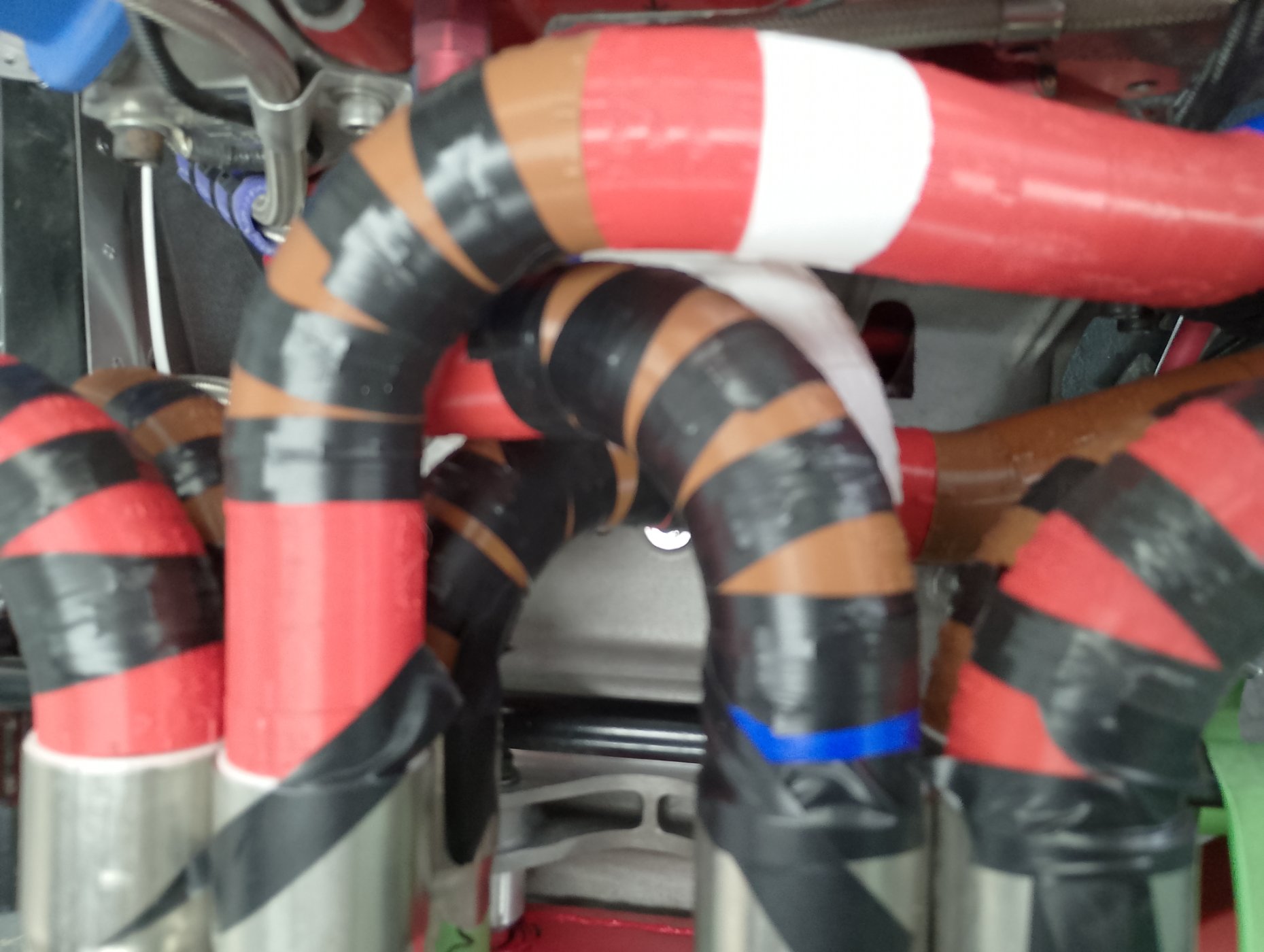

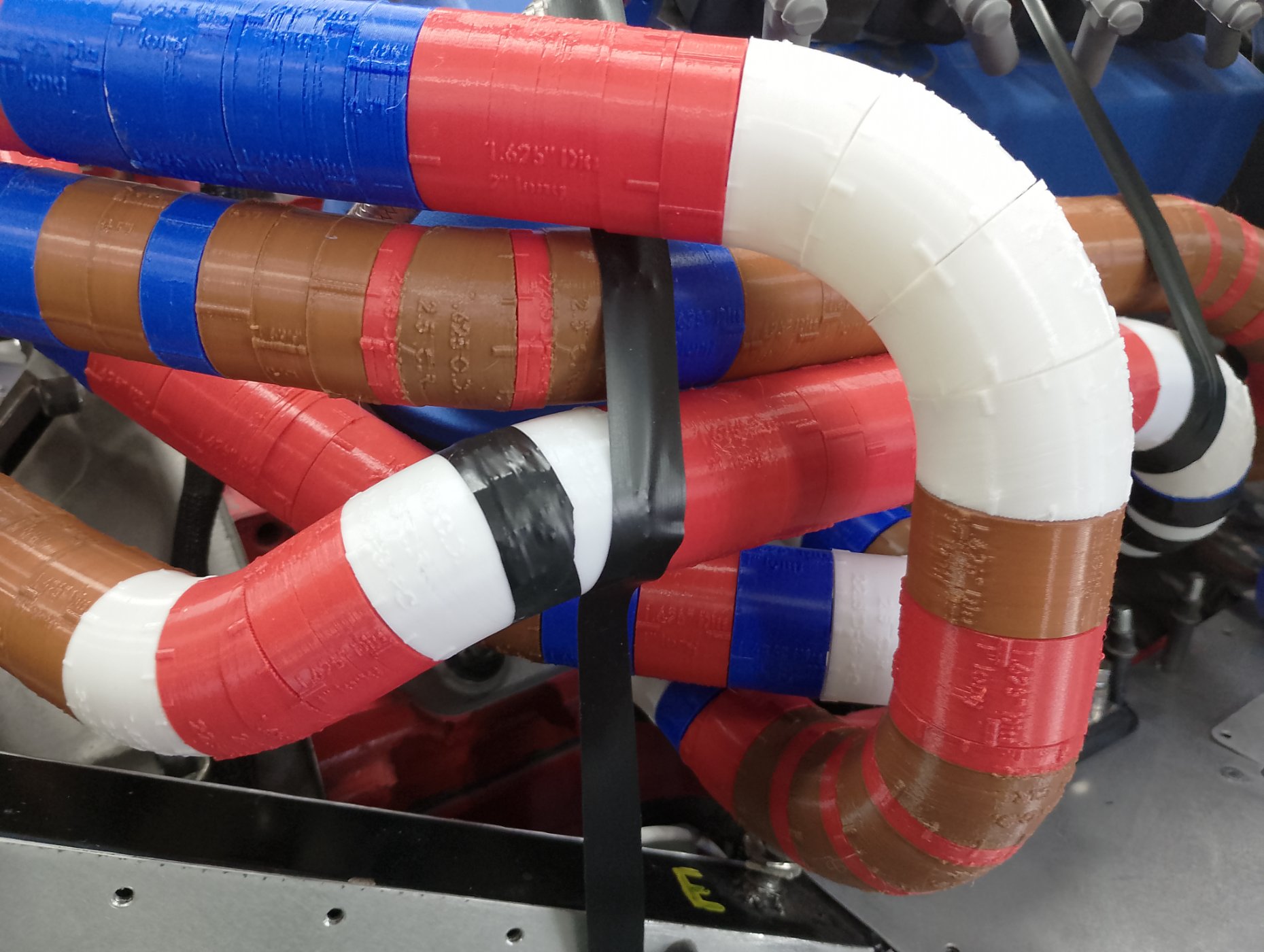

Hello Dave,
I am just in the process of making my own 'snakes'
I have mocked up with 3 d printed shapes ( 22.5 deg sections that clip together ) and intend to start cutting up a load of 90 degree bends in stainless and tack weld before seam tig welding...
Its not an easy task and i suspect will take a few weeks to complete.
my wall thickness is 1.5 mm
Regards
Jerry
