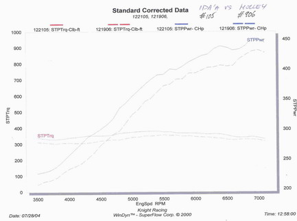

289 dynoed back to back.

If the power is in hp, and the torque in lb ft, then why aren't the two equal at 5225 RPM as they should be, by definition?
Strange on the dyno sheets torque and HP cross at 5250 but not on these graphs,any explications?
The upper curves intersect at about 4250, pretty far off. Don't know why since the dyno typically measures torque, hp is calculated from that, so by definition they have to be equal.
Hp = torque x RPM / 5225
Looks to me like at 4250, the torque is about 350 (left scale) while HP is about 290 (right scale)...
So the facts that the curves physically cross there doesn't mean anything, does it?
Well, lets see,
hp = torque * rpm / 5225
290 = 350 * RPM / 5225, true or not?
Which works for the resolution we can get off the graph.k. If it makes 350 lb ft of torque at 4250 then it must make 285 hp at that same RPM. Close enough.
It works here - what is throwing me off is the two axis graph and the poor resolution. If you look at 5225 RPM and get torque you get around 350. Same for hp, around 350. So, it is just the way the graph is that is screwing me up., nothing wrong with the dyno results at all.
