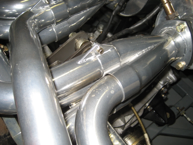

I have been working on a problem with the header pipes on my RF exhaust system. The pipes keep leaking at the entrance to the collectors. I have removed them, plasma coated them and used high temp sealer but I still get some leakage at the joint. My question is, if I weld the pipes to the collectors can the headers still be removed as a unit? The other side of the same question is what have others done about this problem?

Thanks for the input. The pipes only have one tab per collector and that tabdoes not pull the pipes togeather it just serves to keep them togeather. I have a couple of pictures that I need to resize before posting so that the problem can be seen clearly.
My other throught is to weld new tabs on that allow me to pull the pipes into the collectors with some tension on them.

Also - noticed that your collector inlet has a large'ish inlet diameter, giving rise to a gap. Do you use jointing paste? - as with most of these deisgns, if they are blowing, they also probably draw in some fresh air during the normal cycles and that in turn could affect your Lambda measurements / fuelling...

Harbor Freight Tools has an inexpensive exhaust expander tool that I've seen advertised for around $8-10 and comes in three sizes. It is actuated with a regular wrench. You could use it to slightly expand the header so a tighter fit is acheived. Just go to harborfreight.com and put expander in the search box to see them. Also NAPA sells an exhaust sealer called Acoustic made for this application.
Peter ,
Had a similar problem with a race car that developed a backfire on overun due to a leak in that area. Made a mandrel out of 2" bar stock with one end turned down to the ID of the primary pipe for approx 1.25". Where this turned area ends machine a smaller dia approx 1/4" long x 1/8" smaller than the primary pipe ID.The turned area to suit the PP ID will now be 1.00" long. Now wobble this to expand each primary pipe until it is a slip fit in its respective collector ( GO EASY, IT DOES NOT TAKE MUCH )
Jac Mac
Thanks for the input from all those that responded, I think I have a solution. I intend to get the right size expander and increase the size of the pipe slightly. I will then coat the inside of the collector with WURTH EXHAUST ASSAMBLY PASTE before inserting the pipes. It seem that this stuff was designed to seal slip joint in exhaust systems and will harden and completely seal the pipe under engine heat.
Peter
Another option that I've seen used here in the uk is to weld tabs on to either side of the point and use stiff springs to hold it all in place and seal. Kind of like the systems you see on some bike exhausts.
