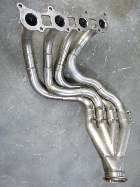

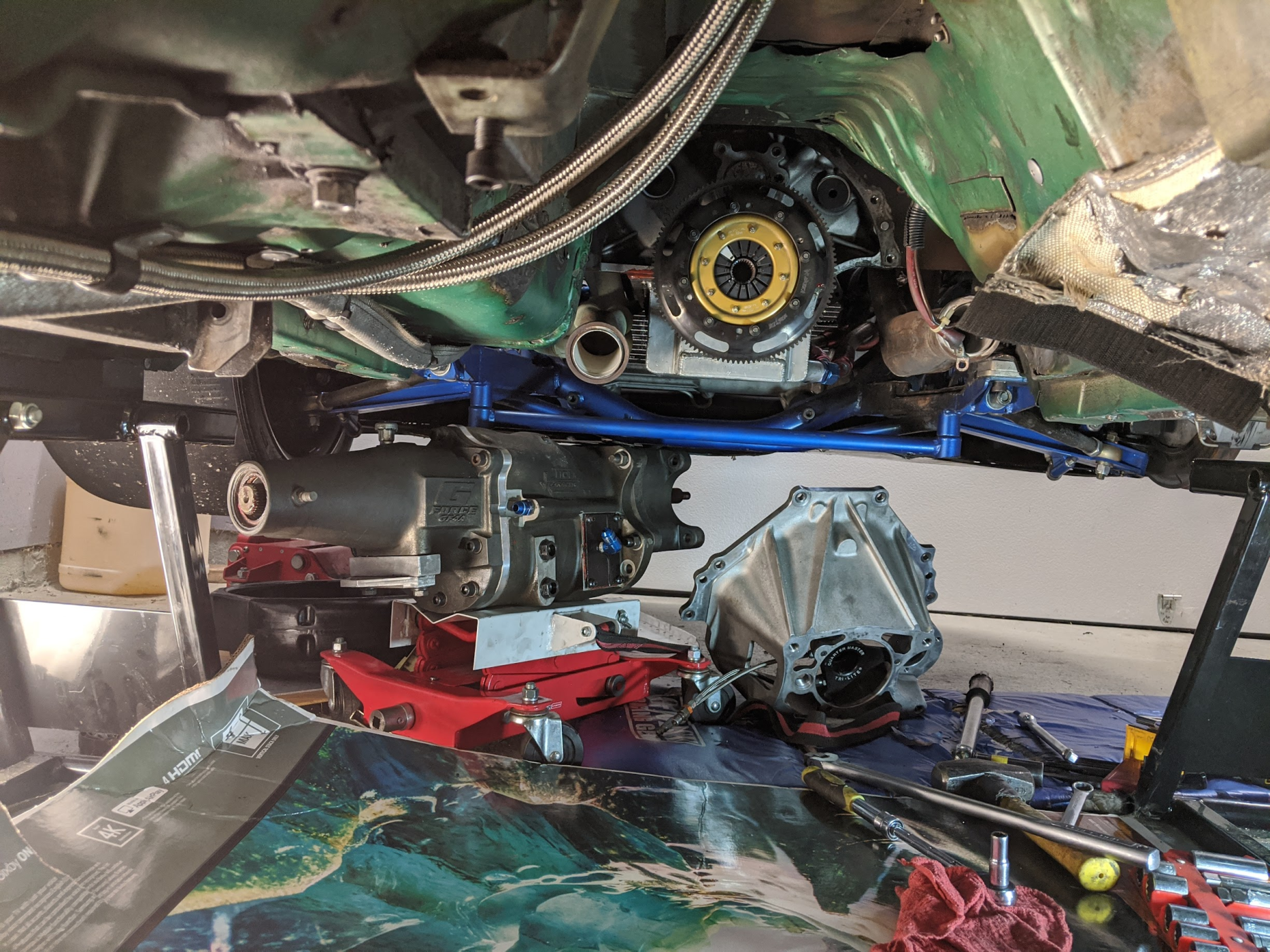

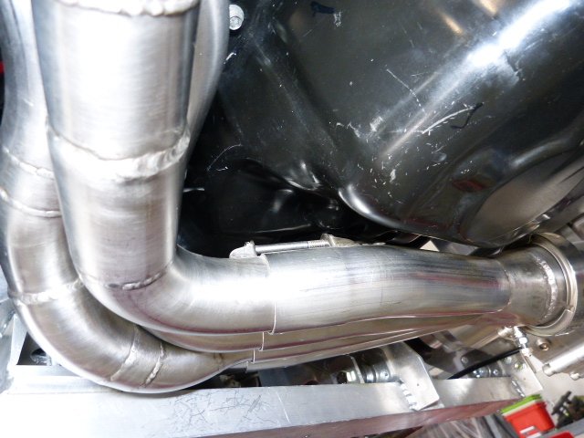

My logic for wanting to keep the heat from escaping the pipe is that if the heat can't get out then it won't radiate to other things around it. Yes, I plan to use heat shields where there is space for them to be mounted with an air gap so the shield can be effective. Here's some pics showing areas where I think it's too tight for a heat shield to be used.

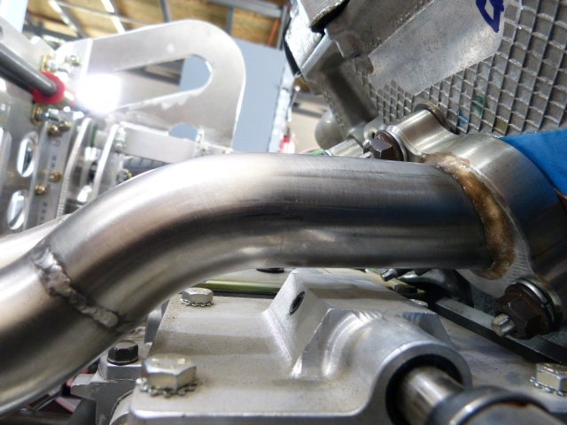

About 3/8" gap between header and shifter housing on transaxle. Yes, this is a transverse mounted engine so the transaxle is parallel to the engine near bottom of the V.
Header passes within about 1/2" from oil pan.

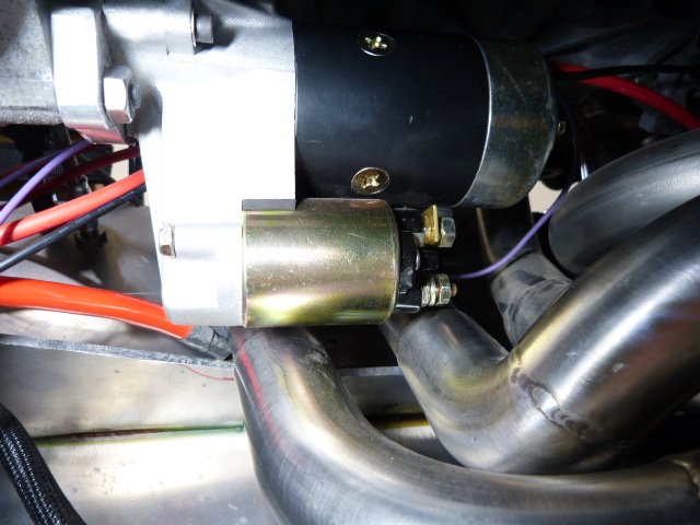

Starter solenoid within 1/2" of header.

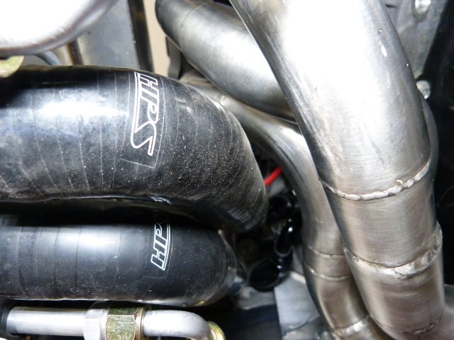

On the other side of header from the starter, coolant pipes/hoses are 3/4" from header.
As you can see, the headers are already built (so utilizing smaller tubes isn't an option) and the header tubes were sized by professionals at Burns Stainless to maximize exhaust flow. Hopefully these examples show why I'm looking for the best options to keep the heat within the pipes.

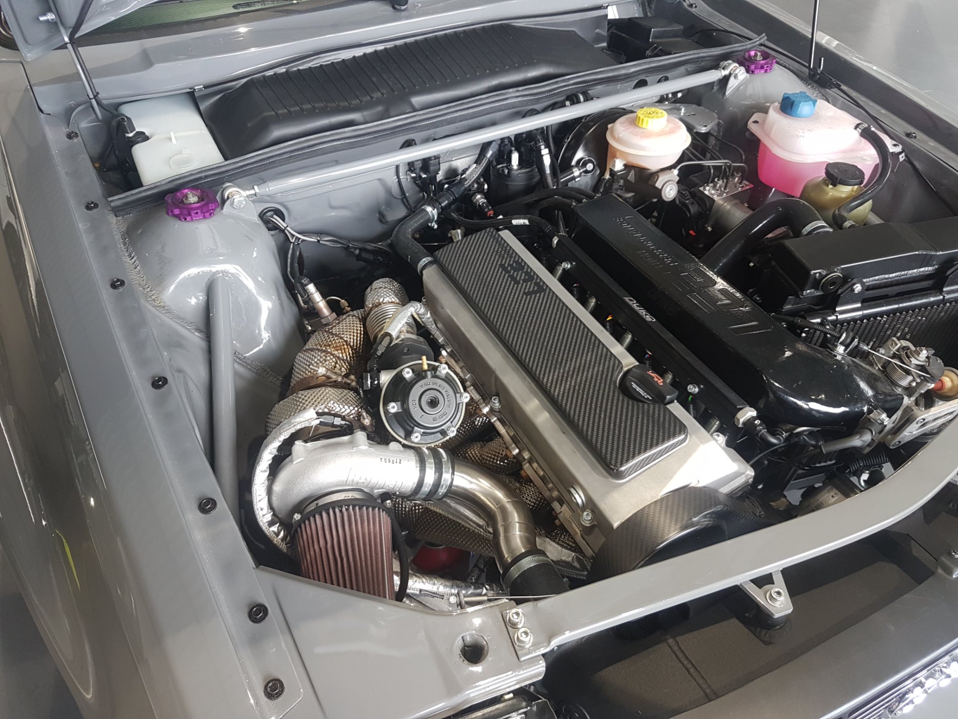

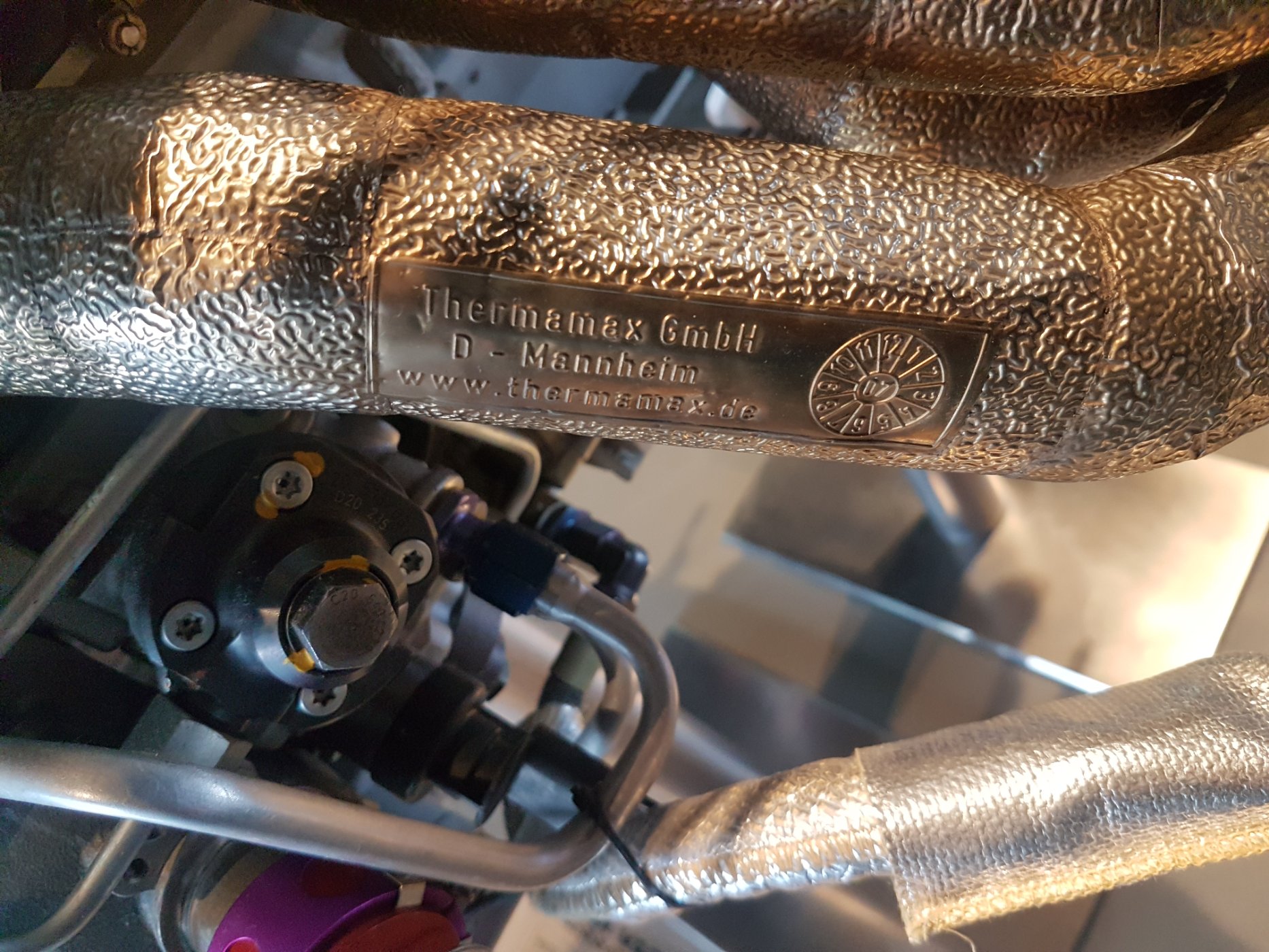

have a look under the bonnet of amg 6.3 twin turbo to see how they coop with heat in limited spaces , or Bugatti Aveyron.... quit impressive
Markus
SPRF40
There is also:

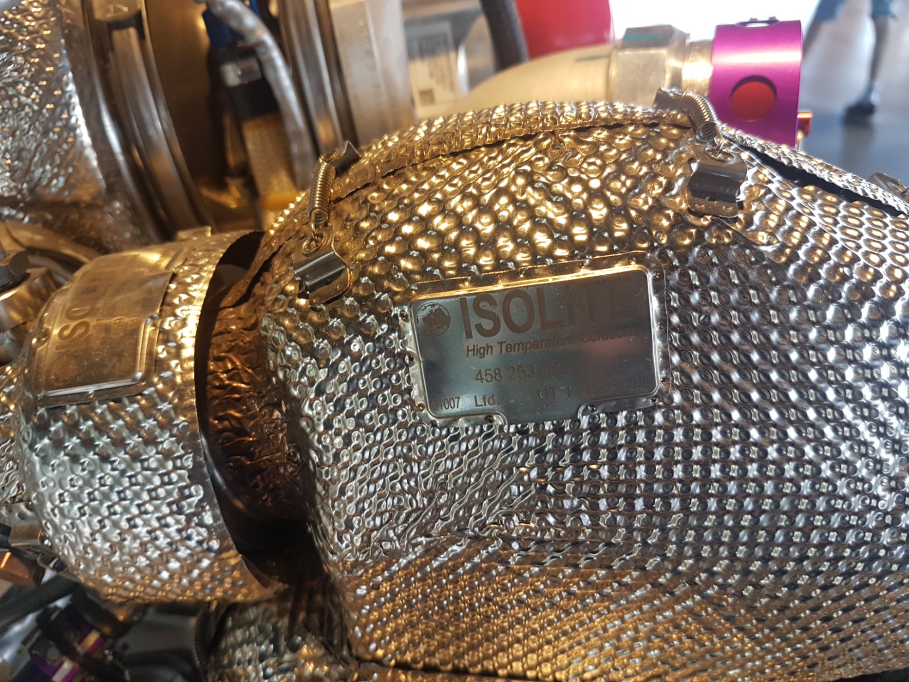

From an OEM standpoint check out the following - just as reference for technologie:
Those follow the same principle (from what I can tell) like https://headershield.com/ see post #4 from Joel K.

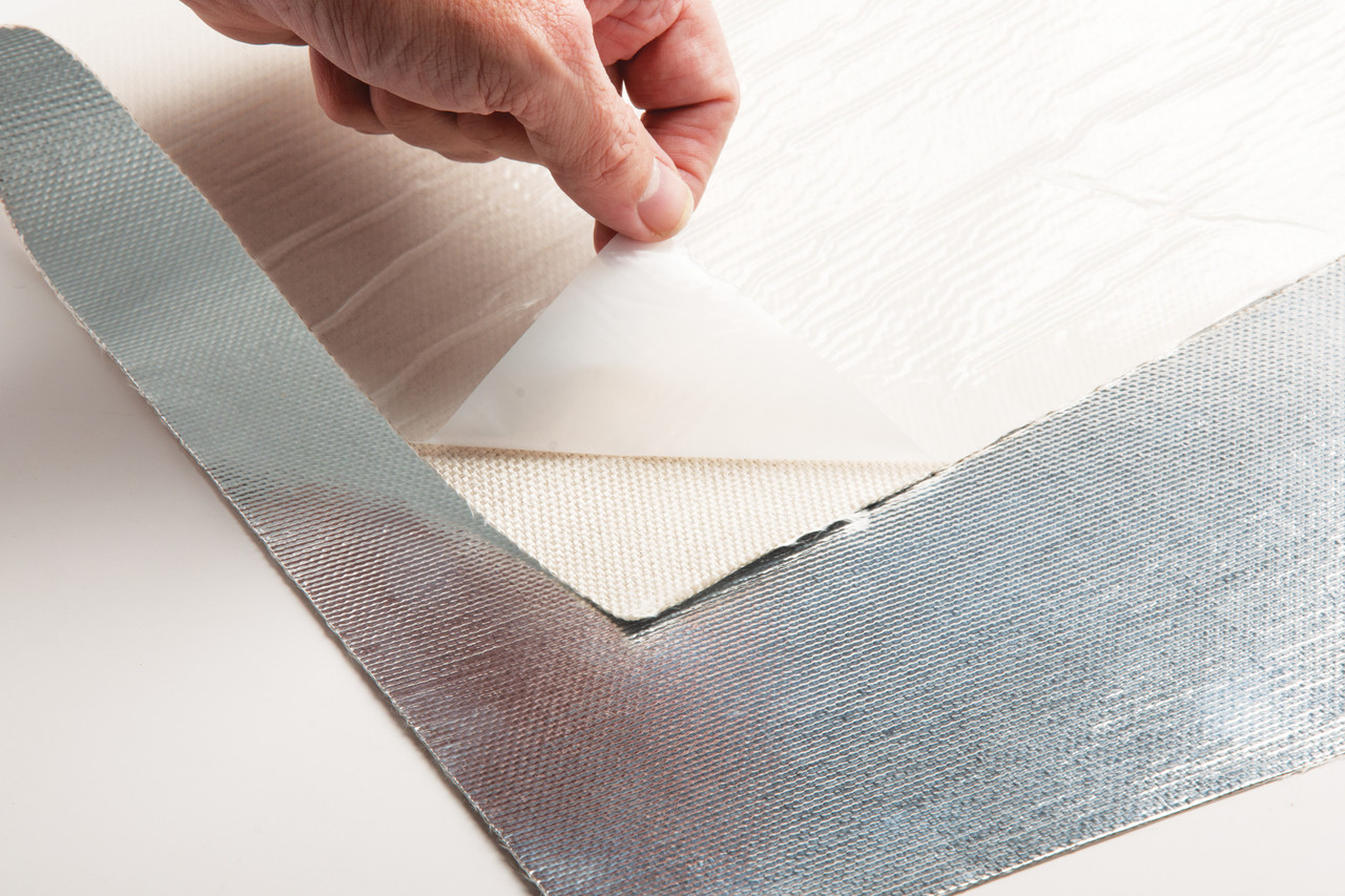

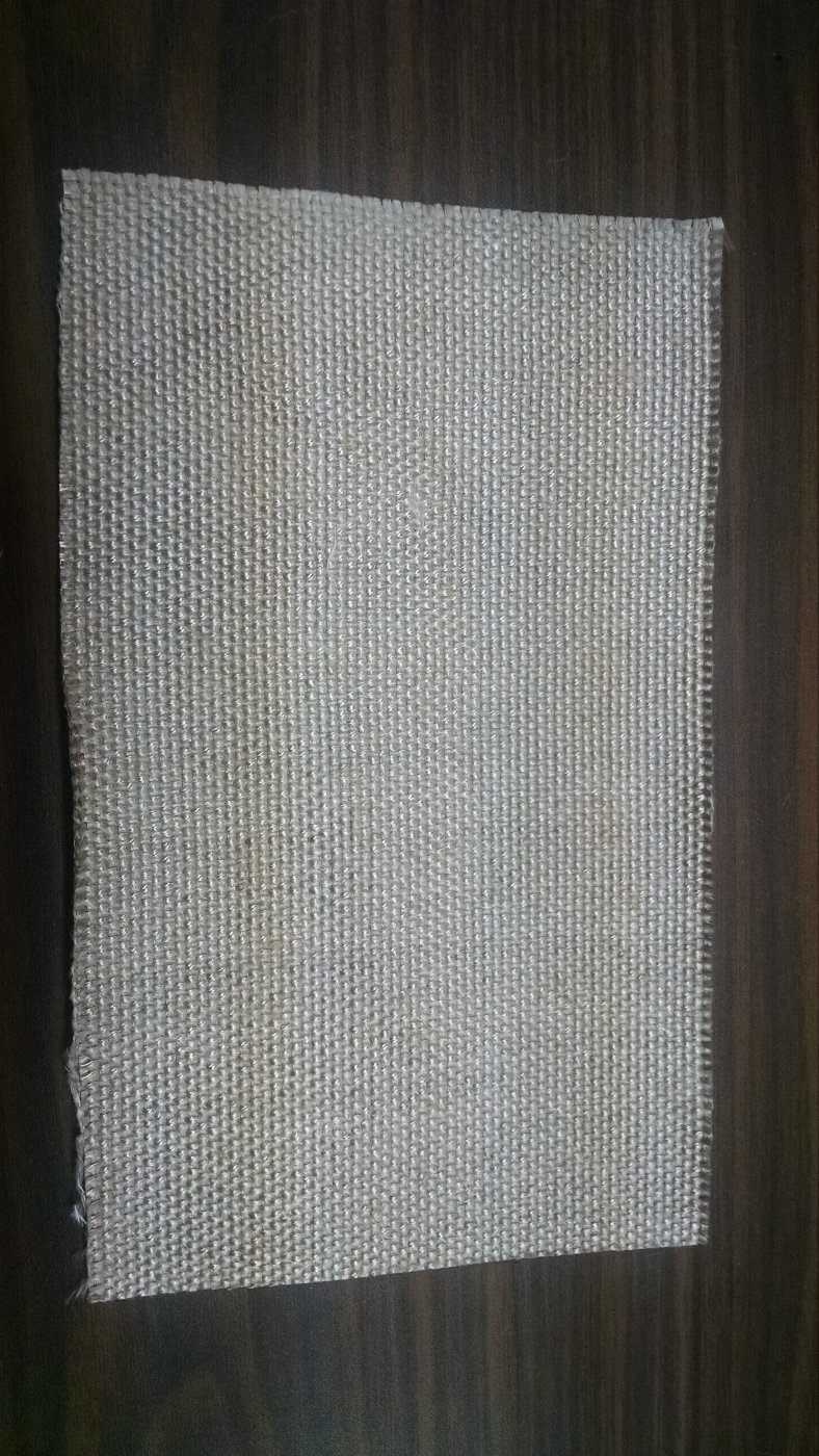

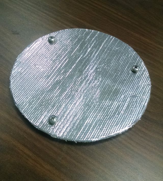

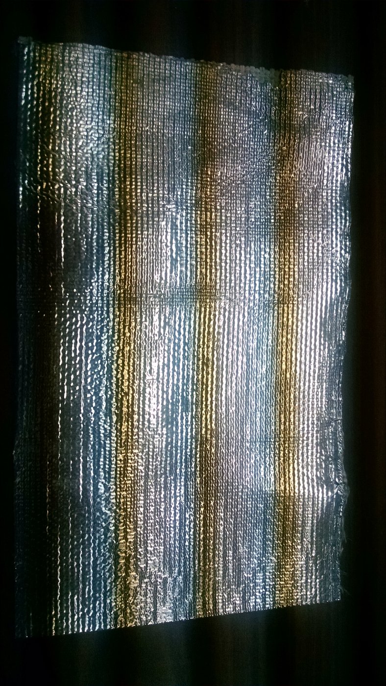

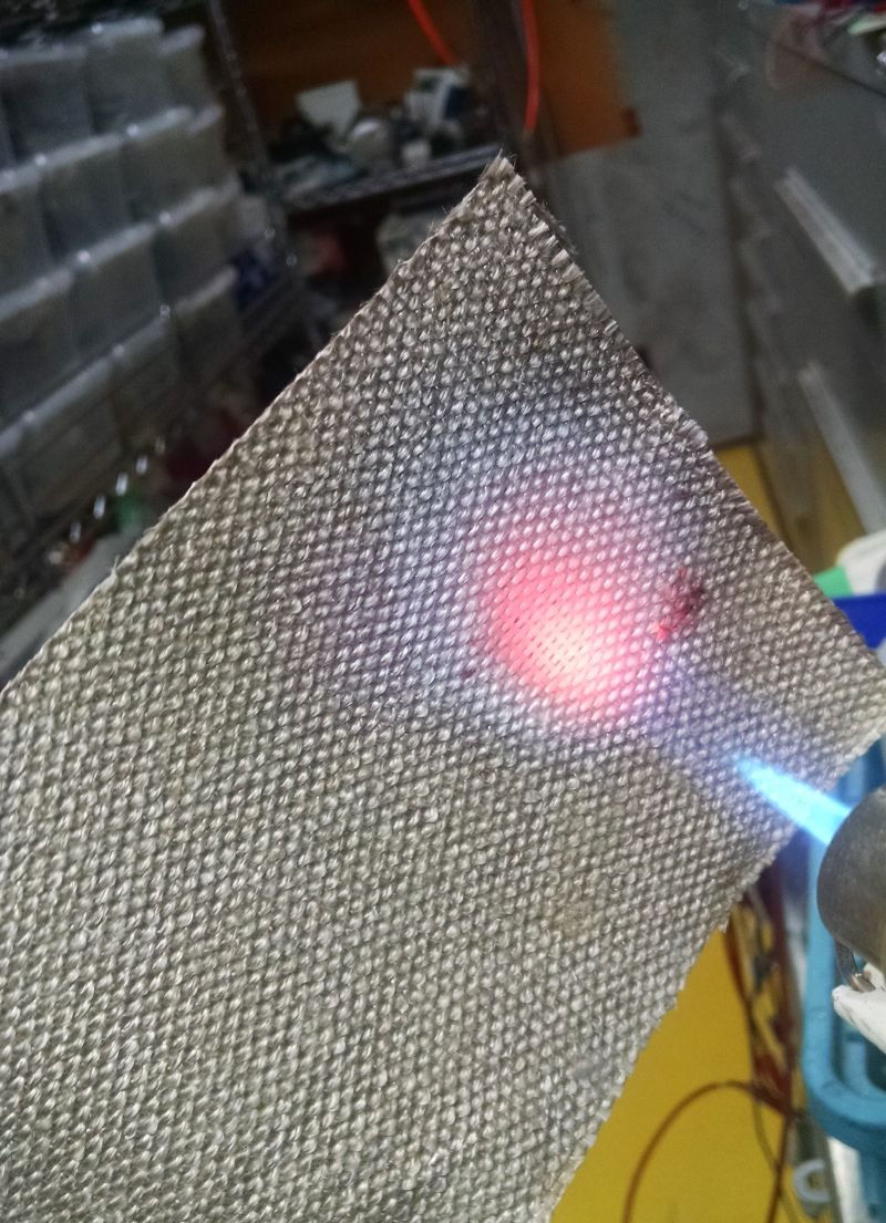

That is certainly a difficult problem with such close spacing. I used some material to cover the rear firewall of my race car that might work for you. It is a high- temperature woven ceramic fabric with an aluminum foil coating bonded to it. If you install it with the metal side toward the headers, even if the fabric side touches a critical component, the heat transfer will be much reduced because of the low thermal conductivity of the fabric.
View attachment 141343View attachment 141342View attachment 141344View attachment 141345
Can you provide a brand name or link?

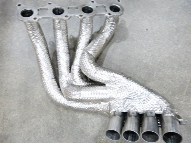

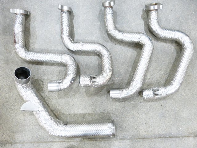

Here is before I wrapped the headers (Swain-coated inside/out) and the Y-pipe. Before, the paint literally burned off the floor. Ran it wrapped like that for 6 years, and never noticed any ill effect on headers, nor exhaust. This was on my 427cid turbo 850rwhp application. IMOHO, if it not plain steel headers, then you can wrap without worries.

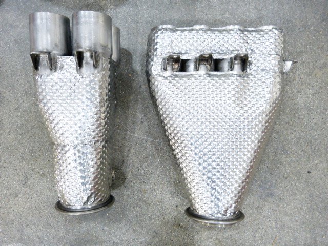

As a follow-up, here's some pictures of the headers, etc. as they came back from Header Shield.
Before:
After:
The embossed stainless steel layer is resistance welded (similar to a spot weld but done in a continuous manner) to the headers, collectors, and exhaust pipe. The SS layer is composed of many pieces snugly fitting over the curved surfaces that are resistance welded to each other. There is a layer of thin insulation material under the SS outer coating. The shielding adds some size to the parts but really not that much.
The people at Header Shield were great to work with. They were helpful in giving a quote prior to starting the work, a good projection for how long it would take, and packaged the parts well for return shipment. Their quality of workmanship appears to be top notch.
