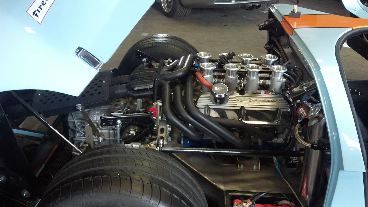

What color are your headers?
Ron Scarboro
In black...

Robert, they are polished s.s. Since you're in Yorba Linda, my fabricator is in Riverside and would be happy to make you a set. He's an "artist" at this stuff. Let me know if you need his contact.
Tim
Thanks Tim, I would like to learn more about his product and explore some options with him.
Is there much and/or frequent maintenance required to maintain the mirror like finish on your bundle of snakes?
Now, back to the heat/heart of the matter. Since yours are polished SS, did you have the interior of the pipes ceramic coated? If so, do you believe that process was noticeably effective for reducing rear heat, or did you acquire the vehicle already equipped that way?
I apologize for my numerous curiosities, but I'm attempting to research all aspects to enable me to modify my new vehicle in a well-informed manner when it arrives in June/July.
Best Regards, Robert

"Is there much and/or frequent maintenance required to maintain the mirror like finish on your bundle of snakes?" Very easy care, I simply wipe with a clean cloth and once every few months I may do a light chrome polish.
"Now, back to the heat/heart of the matter. Since yours are polished SS, did you have the interior of the pipes ceramic coated?" No
" If so, do you believe that process was noticeably effective for reducing rear heat, or did you acquire the vehicle already equipped that way?" I applied\glued a thermal barrier to the underside of the rear clip that sheilds the heat of the mufflers.
Tim
Tim
Thanks again Tim! I would still like to have the contact info for your header expert in Riverside. I am giving full consideration to the idea of using SS pipes as you have, instead of the far less attractive look of polished silver ceramic. Such will be far easier to accomplish during initial engine/trans install.
Regards, Robert
