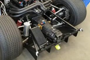

Sequential shifter & pretty sure its 5 speed. No Idea on brand, could be anything, Cant hear any trans whine to indicate possible straight cut gears. Nice motor, got nothing below 4000 RPM though where it fell off the cam around 11 minutes. If that's open track day laps at Le Mans you can have it, I would feel safer with actual race conditions, would have a better idea of what the other fellows about to do next in a race. Some pics on the facebook link and second video suggest car is space frame and transaxle 'looks' a bit like one of the 'ELITE' versions Ive seen pics of IIRC.
If anyone here knows how to 'lift' a frame or two off the video there are a couple of good overhead shot of the transaxle just after start of second video. They should also reduce some concerns some folk have of CV angles.!!

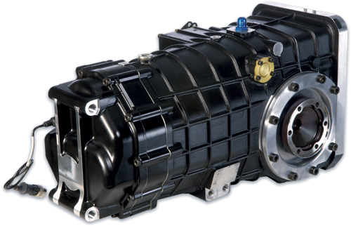

Sadev SL90-20 Transaxle...
D. Nye
Troy is correct by the way it looks.
If you have to ask... Lol
You're not talking Xtrac money, but they are expensive. I'll see if I can find their quote on the 6spd sequential.
Have a Sadev on the shelf at the shop
Very nice unit destined for one of my race cars
Cust built by Sadev to take big v8 torque and power
Similar to pescarolo units used in his lmp cars
