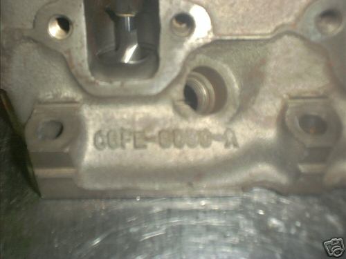

Post a picture if you can.

markg said:
thanks Jimmie, can I see the head part numbers by pulling the valve covers or do I have to pull the heads?
Mark,
See the photo of the numbering on the front of a C6FE head
